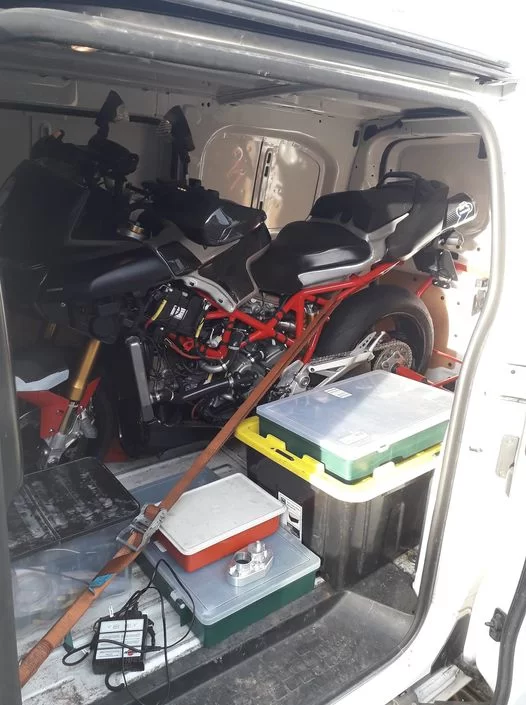

All packed and ready to go....
164 at the wheel and 110 torques
Close enough.
162bhp and 92lb/ft.
Well happy innit bruv?
