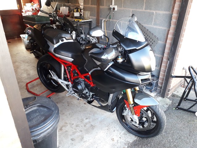

The single black wire with a ring terminal on the end that I could not find on the 1098 wiring diagram and, as a result, I dismissed as unimportant and summarily chopped off and threw away is not as unimportant as I had thought...
Got the loom connected up to everything except the ECU and turned the ignition on and started testing all the lights, horn, dash etc. A minor snafu with the tail light connector, translating the 1098 harness to the Multi tail light assembly required the connector to be de-pinned and remade. But other than that all the smoke stayed in the wires and nothing went "ppffffzzzzzzzt".
Connected up the ECU and turned it on but the dash didn't go through the expected welcome message and the neutral light and oil pressure light didn't come on. Scrolling through the dash brought up "CANBUS 38.0" as an error message.
Quick bit of googling and it turns out a common cause of this message is the ECU 0V lead coming adrift. "What ECU 0V lead?" thinks I. "Aaaaaaaaah, that'll be the single black wire with the ring terminal....".
Good news is, with a jumper wire from the battery -ve terminal to the ECU body, the dash powers up with the correct welcome message and the oil pressure and neutral lights work and the throttle body stepper motor cycles. The even better news is there are no faults of any description on the dash so, fingers crossed, there's no other issues with the loom I've made.
Bad news is I've got to disconnect everything and take the loom off the bike and strip a chunk of it back so I can splice in the ECU 0V lead.
Bike is booked in with @Nelly for a week tomorrow for a final check and then, all being well, starting it for the first time.
It's safe to say the f**king thing is fighting me every inch of the last few yards....

Engine is all back together and fluid tight, turning over on the button with no faults logged on the dash. It's turning over slowly, but with brand new hi-comp pistons I'm not expecting - even with the Shorai lithium battery being in tip top condition- it to spin over vigorously.
It's ready to try starting it for real, but 'cos I'm still isolating I can't go out and get some fuel. Although I may be naughty and nip out tonight to the local garage that has automated pumps and fill a jerry can with some super unleaded....
It's not having it right now.
Turning over slowly with occasional pop and rumble like it's trying to catch but no joy on starting. My hunch is the starter motor is drawing too much current and dragging the battery voltage down so fuel pressure and spark are poor. Starter motor might be the culprit given its age/unknown provenance, I suspect it's a combination of less than optimum starter motor and battery (which is over 4 years old and has been unused for the last 3 years) and the hi-comp pistons and new rings causing a lot of load but I don't want to try starting it any more - risking sprag damage - until @Nelly has taken a look at it.
So it's over to him next week.
Stay tuned....
Quick question; anyone with a 1098 tell me where the earth strap is attached to the crank cases? One possibility is a poor -ve connection on the engine, I've gone to a handy bolt on the front cylinder but this may be too high resistance for the starter motor and that's what's causing the slow turn over....
Try a direct cable from the battery negative, to the external screw securing the starter motor to the case. That’s the most direct to the motor and the engine. Front cylinder can be insulated by gaskets etc.
So, courtesy of our very own @Exige a new lead between the battery -ve and starter motor bolt (as suggested by @Nelly) is fitted. I also ditched the fuel in the tank as, although it was bought fresh from a local garage, I had my doubts about it as it had no smell whatsoever and replaced it with 20 litres of Sainsbury's finest super unleaded. I also hooked up a set of jump leads to a spare battery I had knocking around and after a good dozen starting attempts....
It now starts on the button. HAVE IT!
I'm going to buy a new battery, just to be on the safe side, and it definitely needs some dyno time but there you have it; a running 1098 engine'd Multistrada.

Working my way through the outstanding jobs and snagging all the little niggles that come to light with a bike like this; fans are working now, coolant leaks all stopped, heated grip controller mounted on the bars.
I've actually ridden it a couple of times now. Only 20 foot up the drive to put it on the road so the garage doesn't fill with exhaust fumes as I give the engine some heat cycles...
Starting to wonder what power it'll make on the dyno when Chris has finished with it. 150 bhp would be nice.....
Took the opportunity to fit the bodywork...
...all good other than one glitch, the right hand side panel cracked the filler/paint where the radiator cap is hard up against the inside of the panel.
Not the end of the world and won't hold anything up. When my ban comes through I'll get the paintshop to sort it out, but until then a black sharpie will hide most of it.
