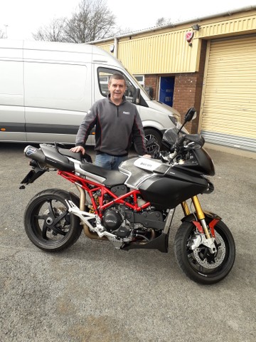

MOT passed with flying colours.
Came home, taxed it and went out to put some miles on it and took the opportunity to visit some of the people who have been instrumental in completing the bike and without which it wouldn't have been possible...

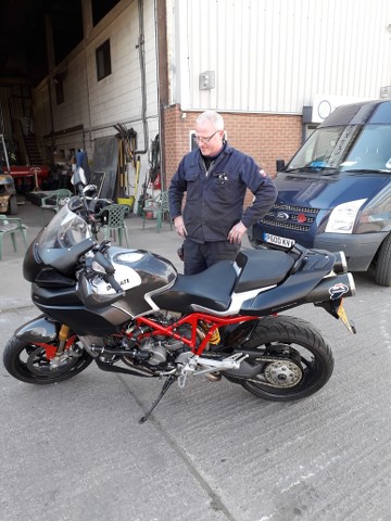

Our very own @Nelly at Cornerspeed Ducati in Sutton in Ashfield built the engine, supplied all the Ducati parts and has been an invaluable source of advice and knowledge over the last 4 years ...
Martin at F1 Metal Fabrications in Staveley took a random collection of aluminium panels and managed to turn them into the work of wonder that is the fuel tank...
Put about 100 miles on it. Few snags to fix but nothing major, all of them can be done tomorrow morning and then some more miles on tomorrow afternoon visiting other folks who made it all possible.
4 years work and have achieved exactly what I set out to do.
