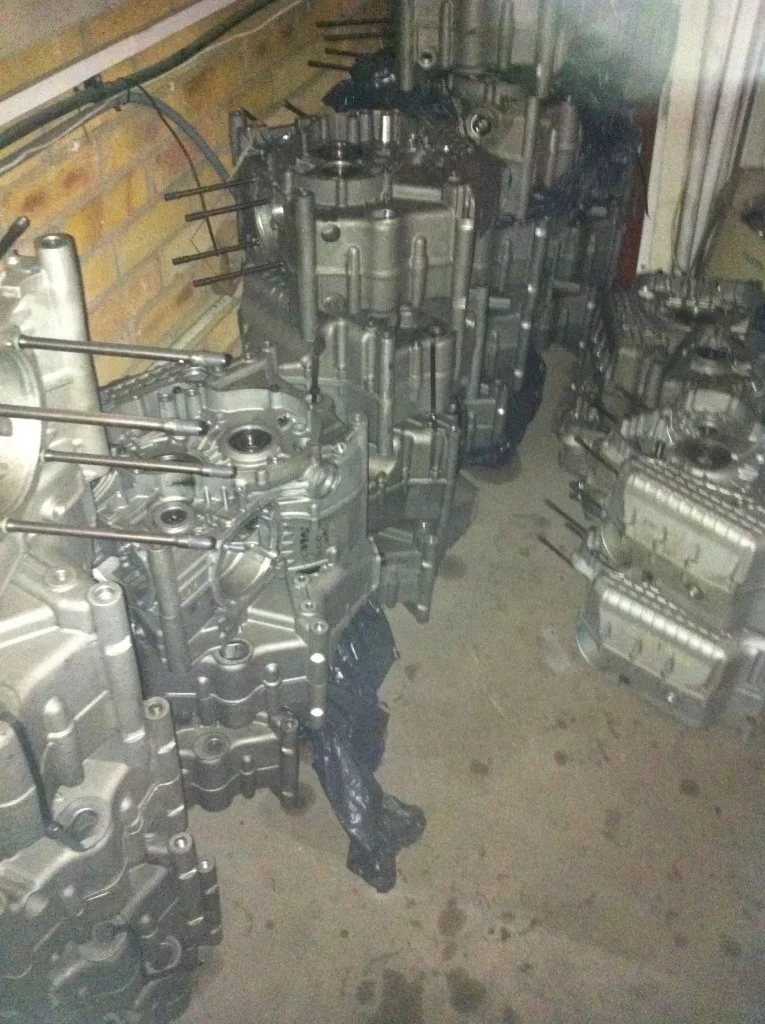

fact of the matter is when mains bearing go and to the point of rumbling, they tend to oval the crank case mounting and or crack it....this is particularly the case on the 1098 where the std crankcases manufacturing process was changed to save Money so the product is weak to start with....they changed it again with the 1198. The 1098R and the Rs crankcases are made in the older process and are stronger.......
Ducati also added to the problem with incorrect shimming of the cranks at manufacture.

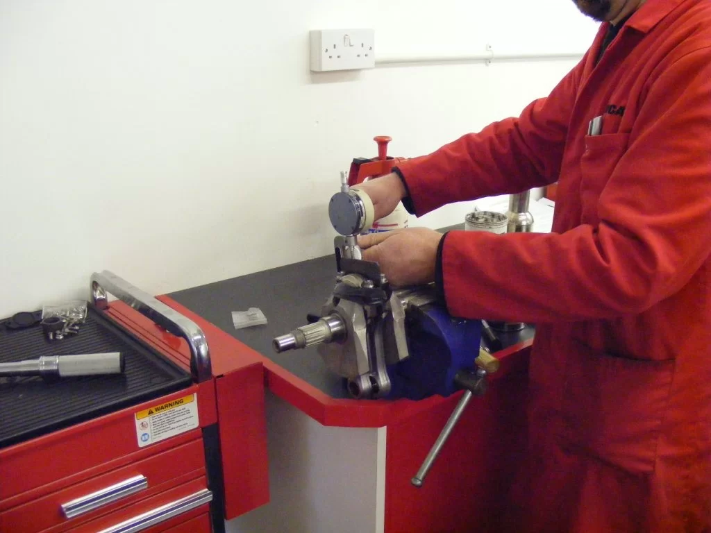

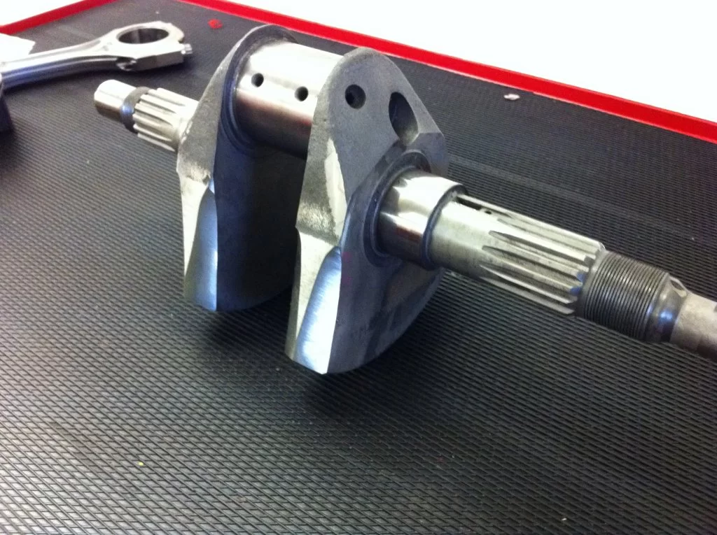

1098 crank lightened, knifedged and balanced to match ti 749R rods and F06 pistons.......all sorts of combinations are possible with Ducatis of that era.
the maestro himself building the rods onto the crank

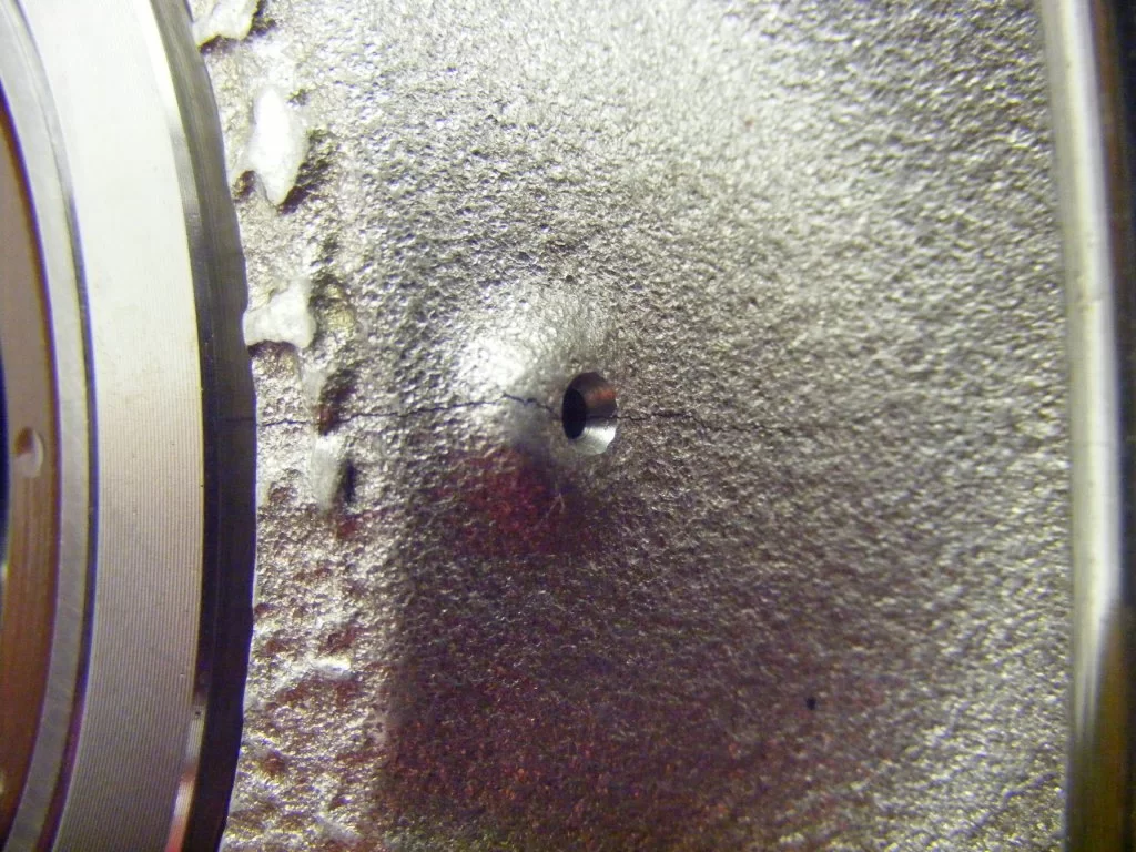

hairline fracture jut above the mains support area of the crankcase tracked to the oil hole.....on a 1098 they fitted oil squirters to direct oil to the underside of the pistons

So im not saying the crankcases are knackered as you point out I don't know. But I do know the std 1098 crankcases are rubbish and weak, history has shown that!! My own personal experience has shown that! I would want to be absolutely certain the shape and structure of my existing cases given your failure, are 100% ok.....im sure Nelly is more than up to that!

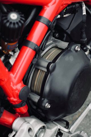

Nothing to with the mains, no end float or run out in the crank detectable with a DTI and smooth to turn over by hand and nothing nasty in the way of metal in the oil or on the sump plug. Not surprised as the sound wasn't, to my ear, the sound of a large, loaded, bearing in distress.
Everything to do with the bearing in the alternator cover being well and truly knackered. Bit of damage to the alternator, so replaced with a second hand one, and the engine got both side covers taken off and given a good flush through with solvent. There were some pieces of grey sealant on the oil screen, I'd be willing to bet some excess sealant made its way into the alternator cover bearing - as it's unshielded - and that's what did for it.
