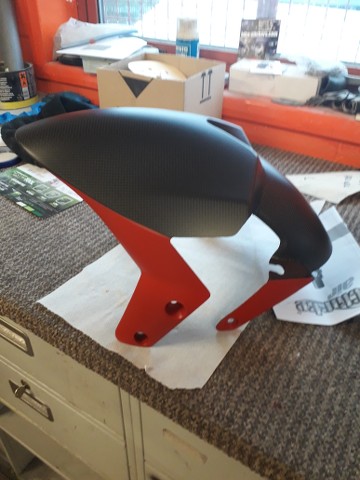

Bodywork will be ready for collection on Friday.
I am tumescent with anticipation.
Wiring loom is about half done. Forks have been treated to new seals and oil, as well as some proper travel indicators, by @Nelly.

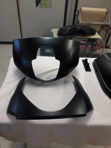

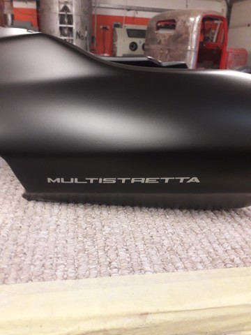

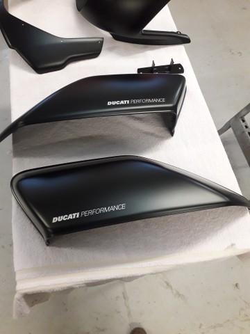

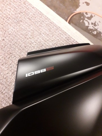

Bodywork back from paint....

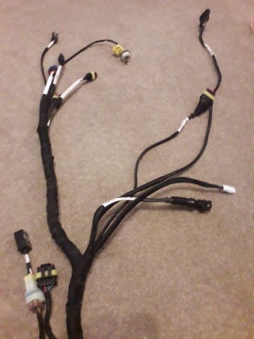

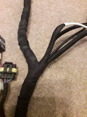

Wiring loom is finished....
It took two 1098 looms, one original multistrada loom, loads of different coloured wire and about fifty cut and splice joins.
Drop it back into the bike, connect it all up and turn the ignition and hope it doesn't burst into flames. I need to nip over to see a mate and make use of his crimping tools to shorten the main power supply lead to the solenoid and then in, theory, it's ready to start.
Got a coolant leak - weeping from the water pump cover - to sort and then it's over to @Nelly for a cold diagnostics check and then some fuel in the tank and maybe it starting. Next week hopefully....
