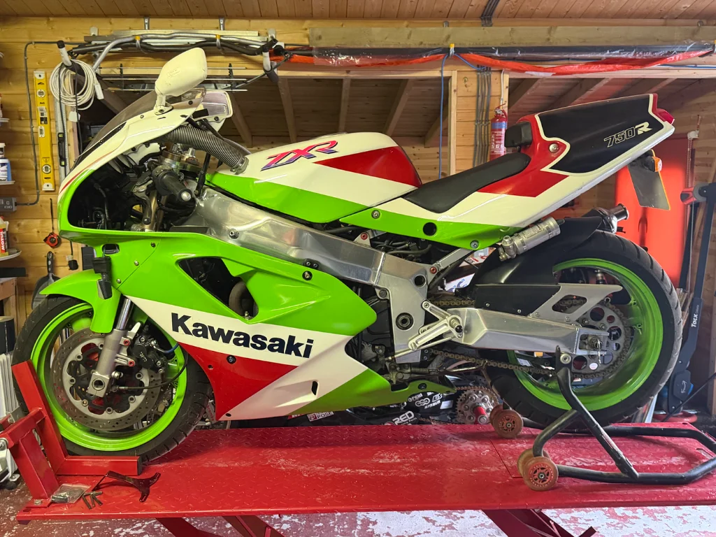

Dragged the ZXR out of hibernation the other day… and got it on the ramp for surgery 👀
Found 3 issues so far,
Seat lock stuck so could get the seat unit off - fixed now 🥳
Bolt stripped at the rear of the tank so couldn’t get the tank off - drilled out and got the threads out with an extractor today 🥳
Fuel cap sized on the latches - still working on that one 🥵

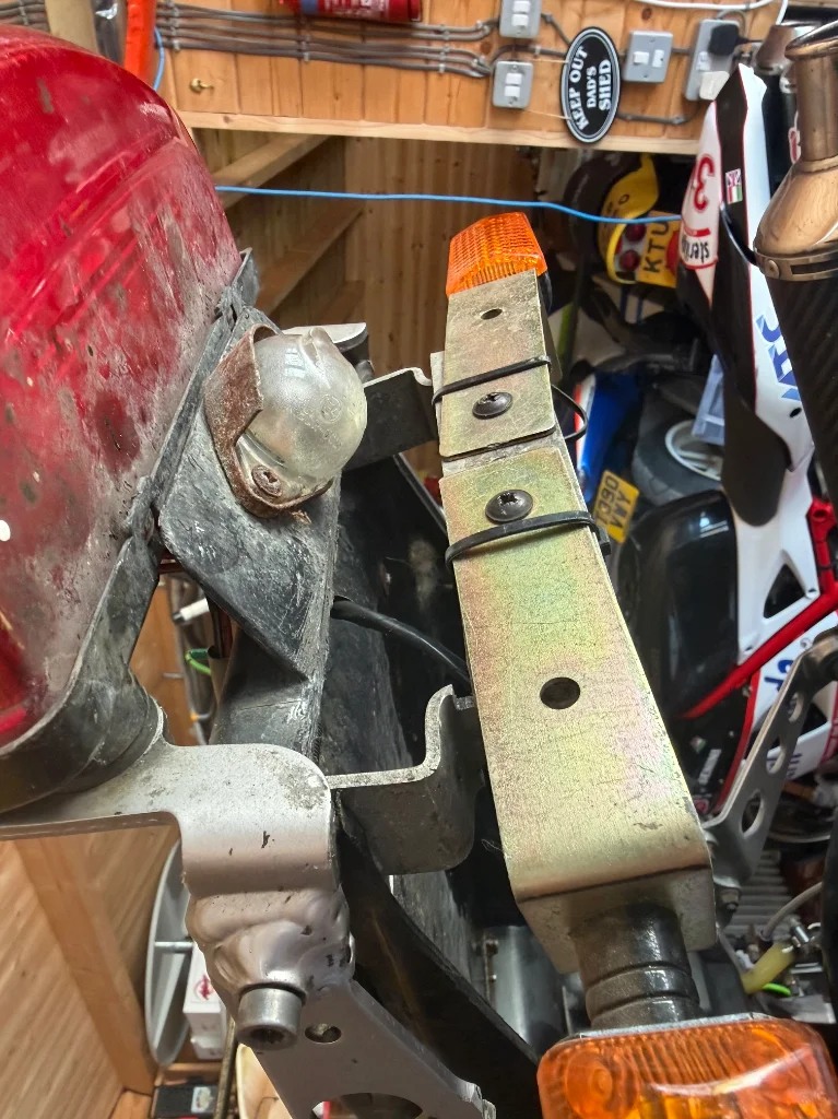

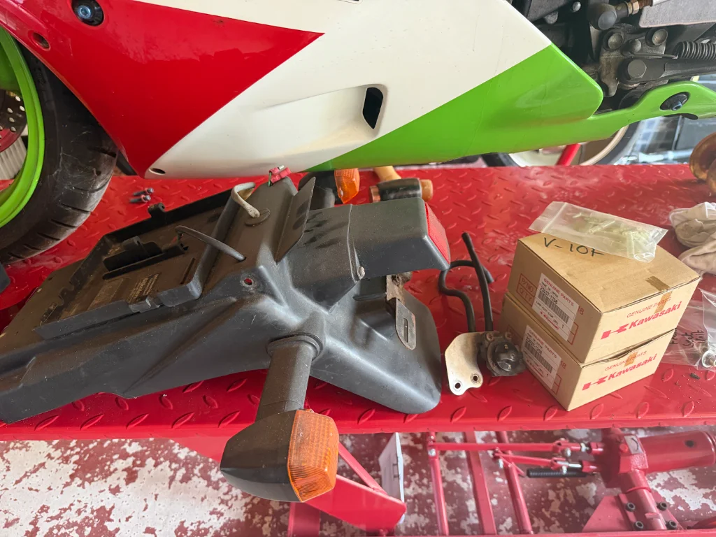

When I bought it as a 1 owner bike about 15 years ago I realised it had a few bodges from its first owner - the biggest being rear mudguard sawn off and crap indicators fitted, and fuel tap removed and piped direct with no reserve 🤷‍♂️.
Luckily when I bought the bike I sourced a rear mudguard and standard indicators along with a fuel tap which were easy to find back then 🙂
This is the mess the first owner made of the back end…

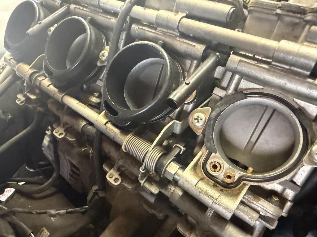

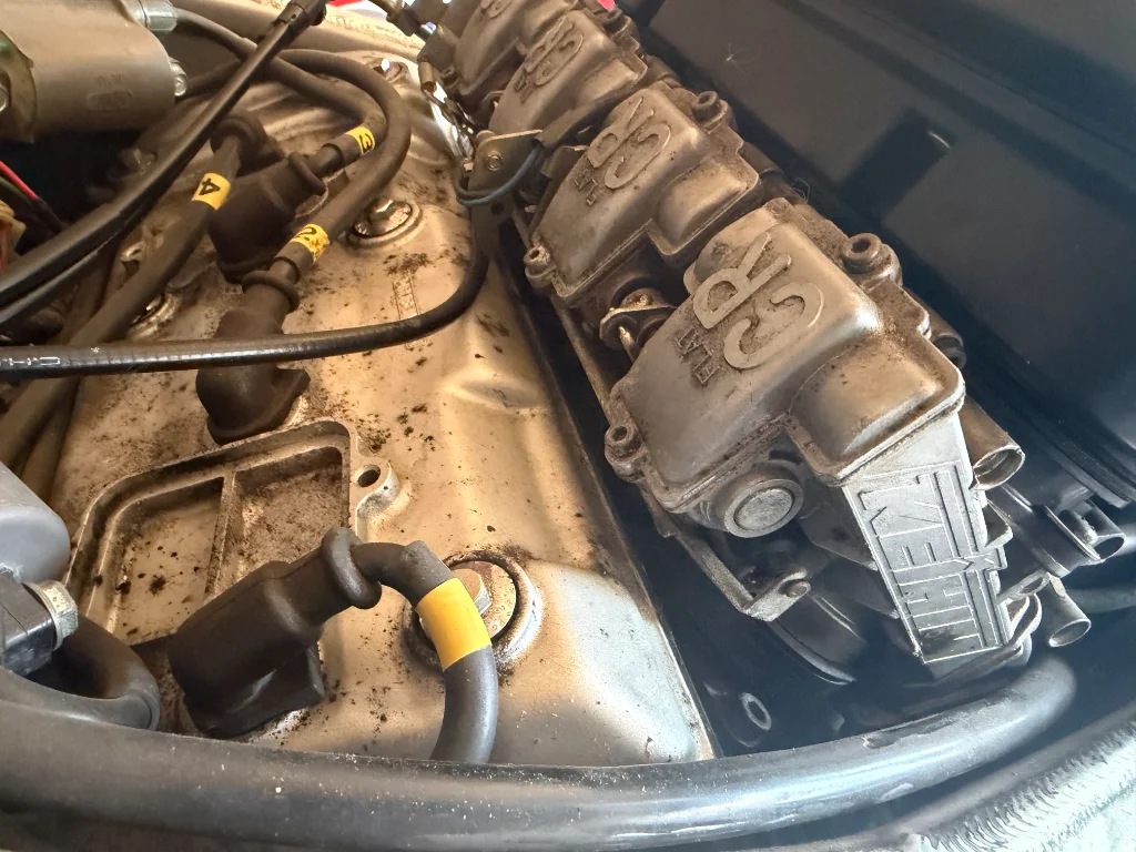

Today on removing the tank I revealed the K1’s lovely Keihin CR flat side carburettors 😍
Once the fuel cap issue is resolved it needs a deep clean - and lots of crap anodised bolts that the first owner seemed to love changing back to normal.

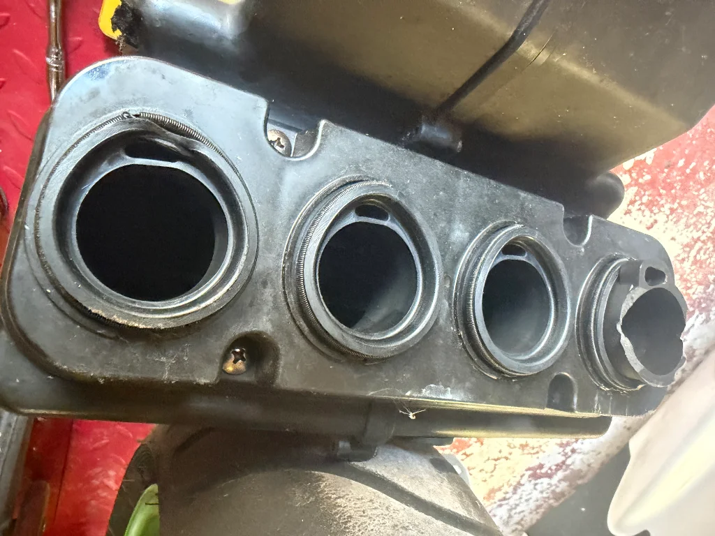

Took the airbox off today to gain more access for a good clean - good job I did as one carb wasn’t connected to the airbox - the rigid duct on the carb came away with the airbox - well 90% of it did 🤷‍♂️
Also one of the airbox side rubber ducts had been snagged the last time it had been fitted 😮
The air filter was a disintegrated mess too but I was replacing that anyway.

A job i always hated, getting a bank of four carbs into the inlet manifolds.:mad: Vaseline or washing up liquid was the way to go but still a shit job!!
I think this design will go on reasonably easy - the 3 that were connected still certainly popped of easy - time will tell... I need to find the parts now which are rare as hens teeth 👀
The ultamate find would be new old stock but as you say hens teeth, maybe get a a word out on a forum. :unsure:
cmsnl have new old stock :)(y) - none anywhere else on the internet, both parts are different to the standard model due to the flat side carbs with bigger inlets.

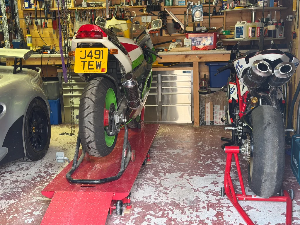

Got the Speedie MOT'd - my friendly MOT guy pulled his face a bit at the number plate, which he's never done on my previous bikes. Apparently he got a spot check on a car recently by the authorities.
I didn't want to put him in a position so nipped back for the original plate and a reflector and went and stuck it on with a stick pad.
