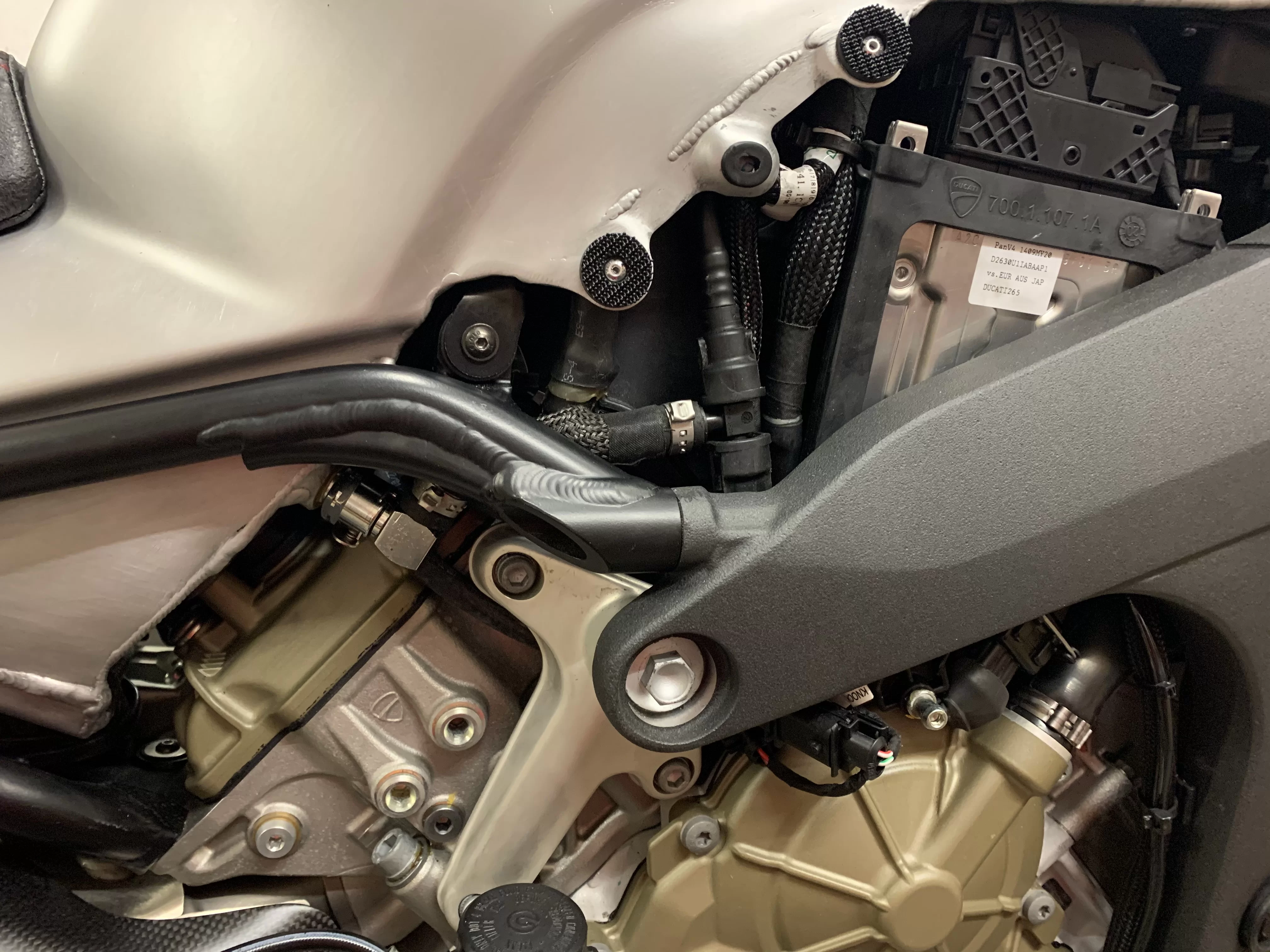

Bit of tidying up Ducati factory rear sets as the rubbers are push on and I know if I ever get to sunnier places they heat up and dlide off
solution is to drill and tap the shaft then a nice pan headed ti bolt lock tite in....that suckers not sliding off but still rotated for comfort👍

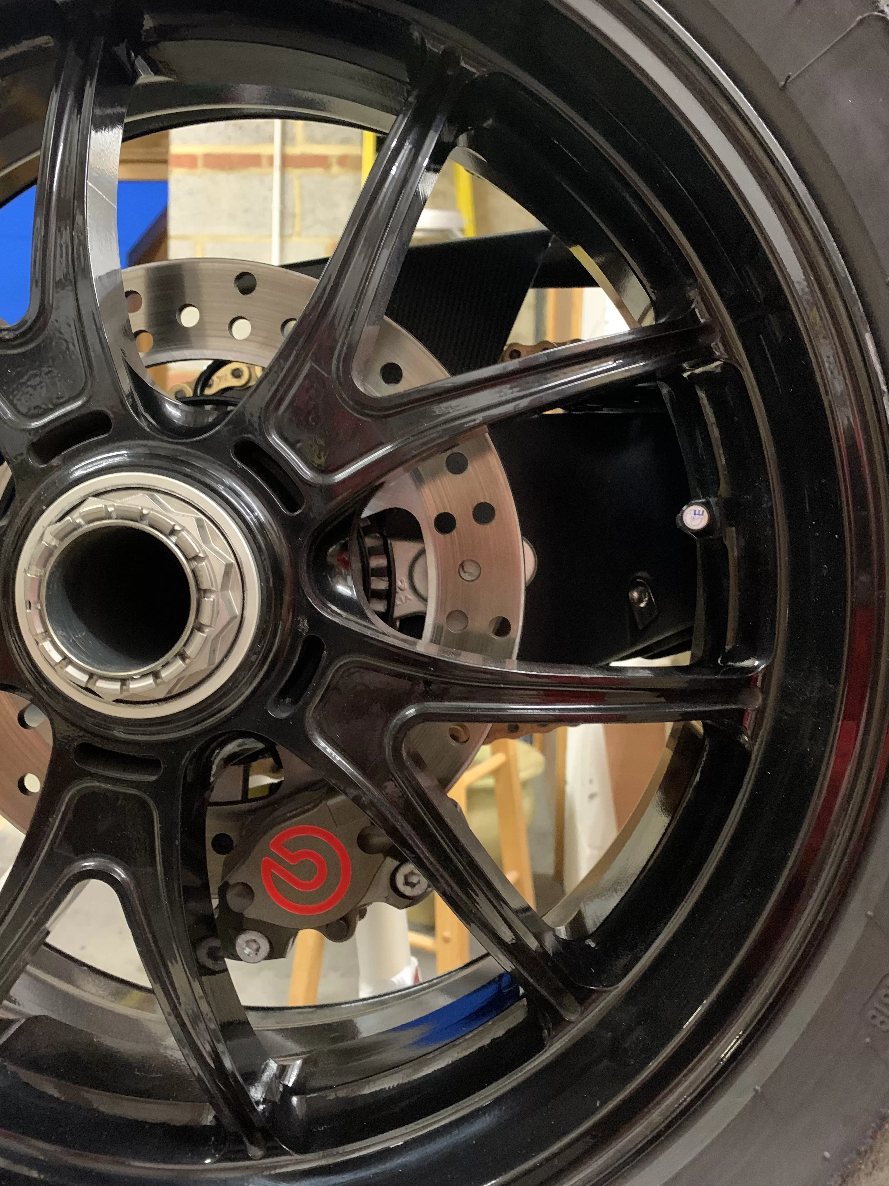

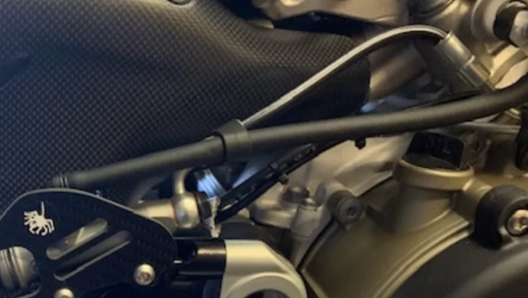

I’ve also fitted my Gucci brembo rear calliper ...
As the banjo mount is d sad lightly in a different place I took the opportunity to change the std brake pipe that goes from the abs unit to the calliper.
As std it’s a mix of flex pipe and steel pipe plus it’s routed in a really crap way on the inner face of the swing arm right by the wheel and tyre and too close for comfort with tyre warmers..
tge trick is to re route the pipe across the top of tge arm and around the rear passing the pinch bolts this eliminated the proximity of the pipe 👍
This is also the route the pipe follows on the corse RS Bikes with the longer arm

the black rubber is designed to spin but when they get hot they just ride over the std swaged end and you lose them... the pan heads are a slightly bigger diameter so they can’t come off...
I had knurled nylon on my old bike...

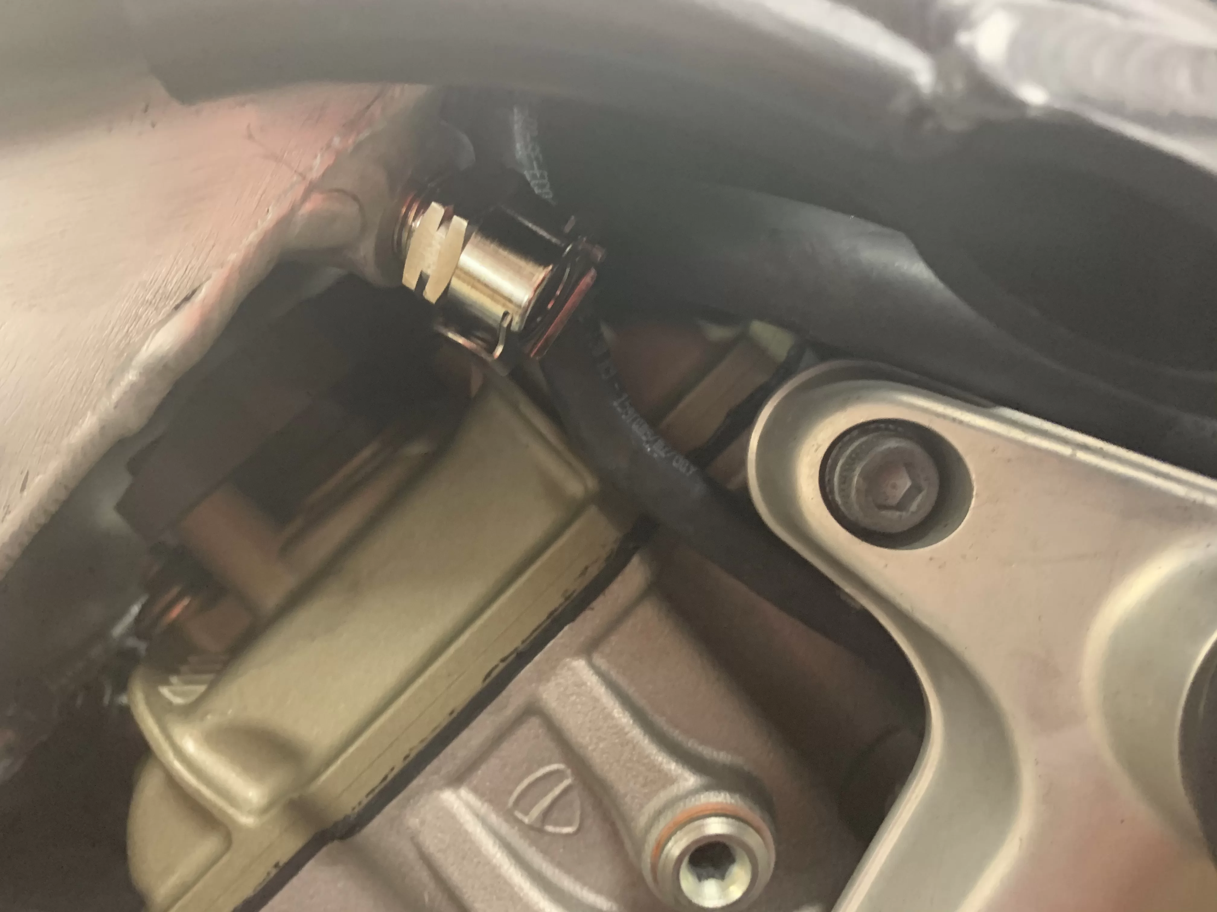

today I finished off sorting out the rear brake pipes. the std ones go from the rear master cylinder forwards to the ABS then all the way back under the rear exhausts across the top of the swing arm then down between the SA and the rear wheel to the rear calliper....its shoit. The pipes are half flex and half steel with permanent bend in that seem to follow no reasonable shape or path other than to create a high spot to trap air in... still ducati rear brakes are renowned for being easy to bleed,,.... honestly have a look at the rh side of a v4 just in front of the right rear set... crap!!!!!
So I removed the std and had some made up by Earls they are nearby at Silverstone..I could also measure the route and group them more tidier..
this also gives more clearance away from the heat of the exhaust...
