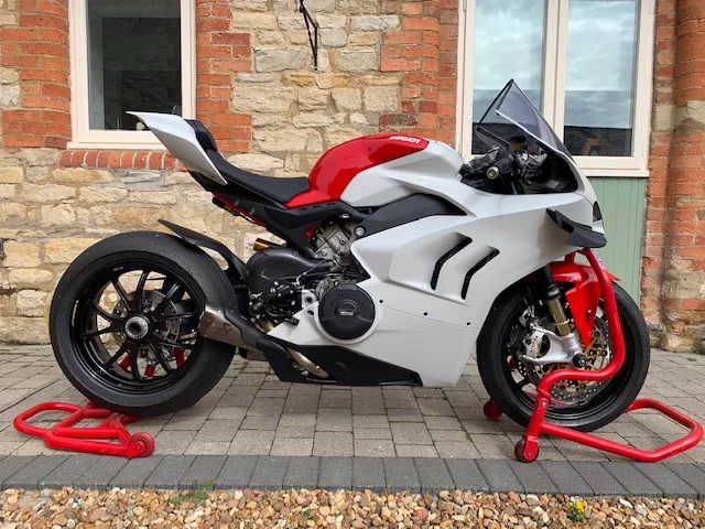

So in Aug this year i was in a position to buy one of these. I thought long and hard about whether to get the S or R or not but decided that I didn't want the electric suspension or the wheels, and so many things of the R had been put on the 2020 base bike i could use the extra ten grand plus for an R i would play with on extras for this one. Plus i already had Mag marchesinis 10 spokes and FGRT forks

in the short time between the Donington and Silverstone dates i got a genuine ducati track fairing kit and managed to fit it. Ironically the track fairings are the same stamped parts number as the originals just white....

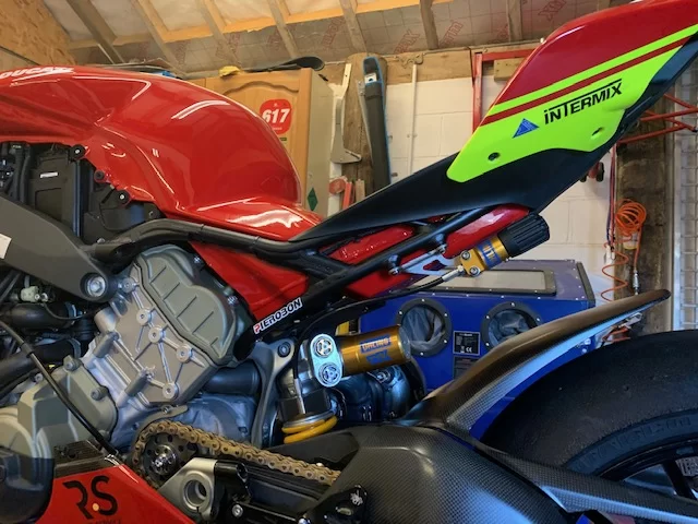

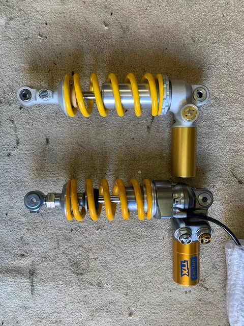

amongst a few new bits i aquired a ohlins ttx for the rear
here it is compared to the std sachs. there were some changes around ride height and suspension travel from the early bike to the 2020 version. My base bike has the same rear rocker and tie rods as the R interestingly the eye to eye length of the shock was different too... fortunately the TTX has an adjustable bottom eye to facilitate that.

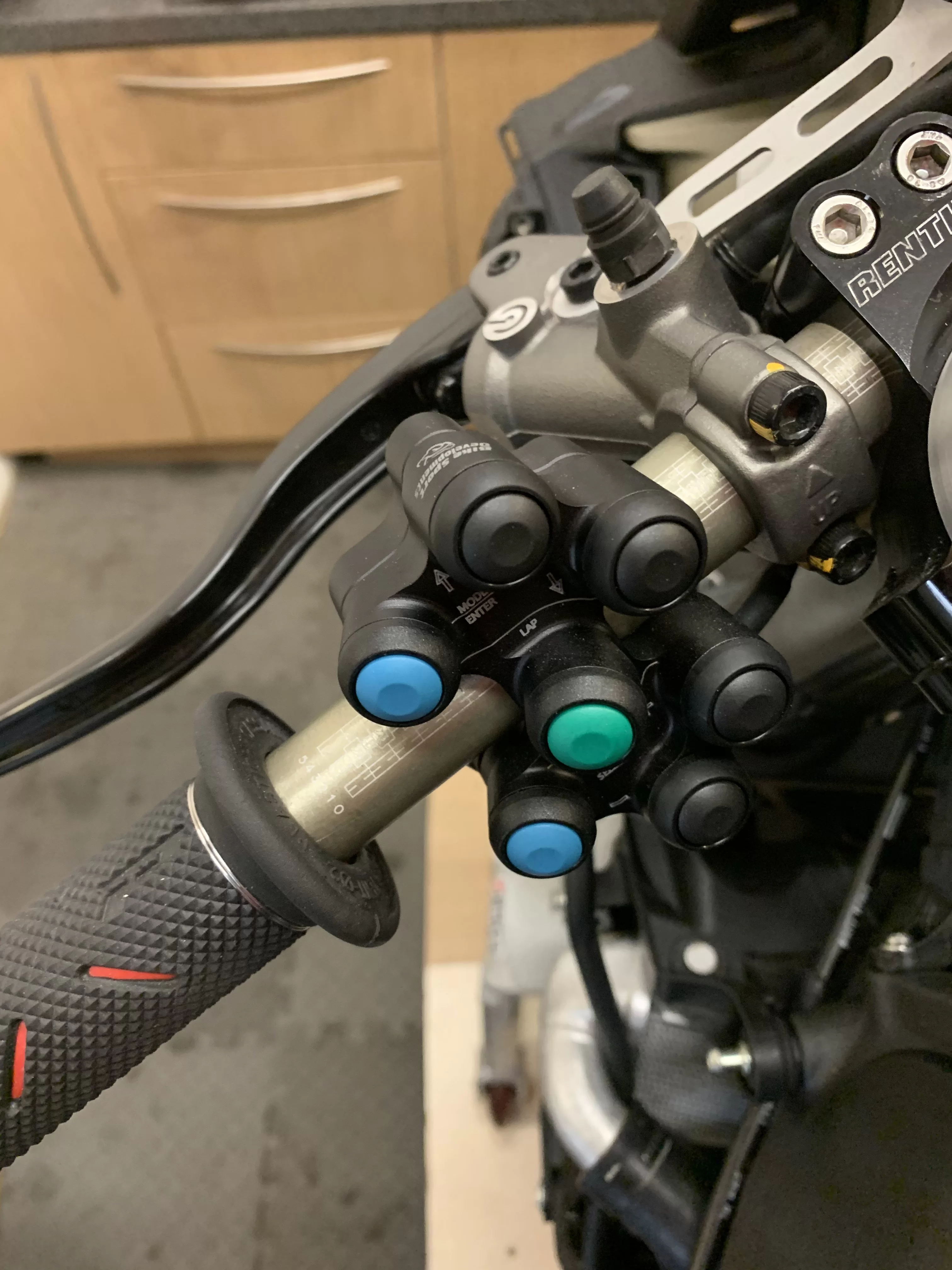

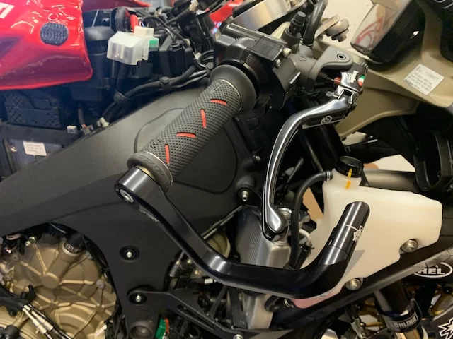

Looks like it will be compulsory next year on T/days so a spider lever protection and the corse grips. Also after much deliberation around swapping callipers and master cylinders a RCS master cylinder.
You can also see the combined throttle and on off switches made of alloy to help protect the expensive ducati electronics and more importantly move the loom out of harms way plus to create a bit more space on the clip ons which were also changed to renthal..

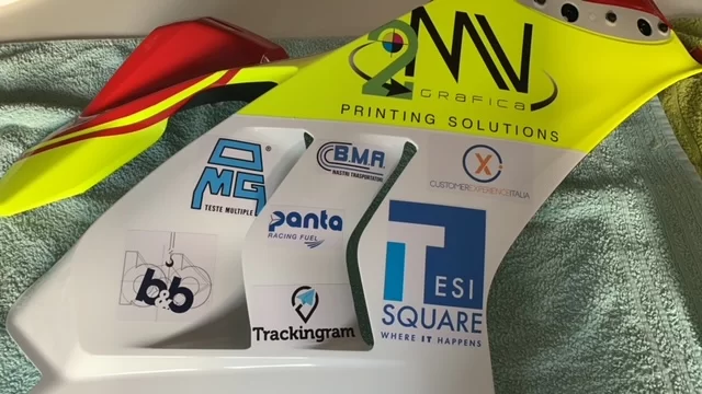

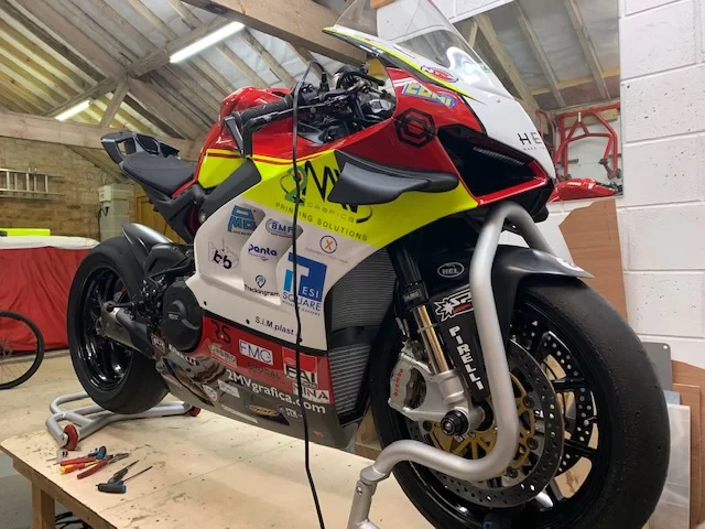

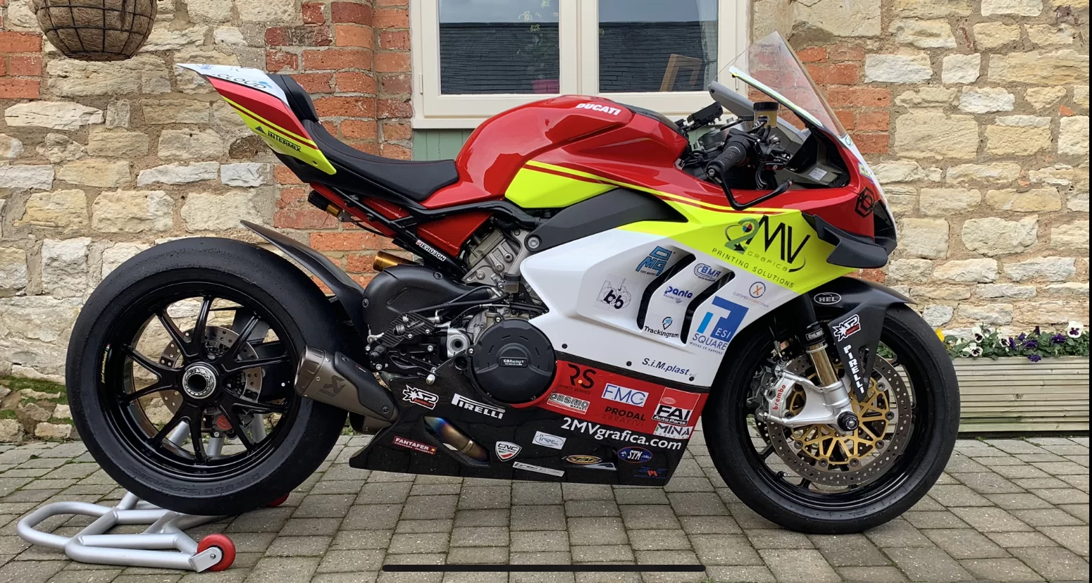

I had been looking for a while at what paint scheme to go with ... i wanted it to be Panigale v4 but the aruba thing had been done to death,,,, i quite liked the BSB josh brooks scheme but kept coming back to the team go eleven ... rubens rinaldi although tis chaz davies next year.
Its a bit of a sticker fest and several colours so i played with the idea of part wrap. I spoke with Evoboy over the other side who has done a lot of wrapping as you've seen. He did the base red and Yellow for me to a really great standard. He also knew what wrap to get from where and what worked as a ducati colour...
I had to research all the sponsors for team go eleven. find their logos and graphics, then find them in the correct format not an easy task. I then had to size the graphics to the panels and then get them printed. Fortunatel there was a local chap that could help me with this.
i hint fitted everything together as yet just in parts so the completed bike remains to be seen.... Ive also just sourced a new fuel tank and pump from italy which i may well bastardise back to brushed aluminium which is what the race bike had.

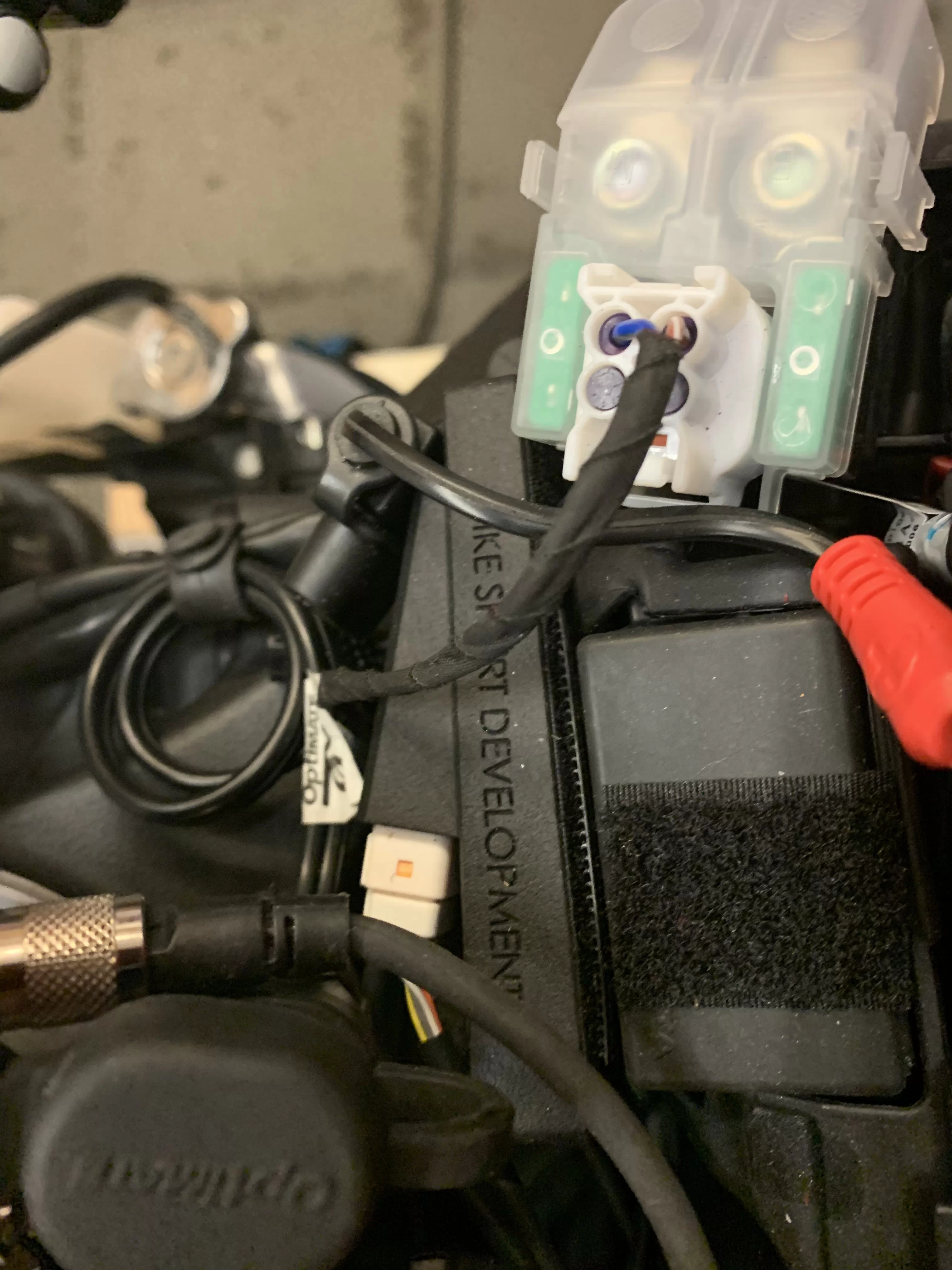

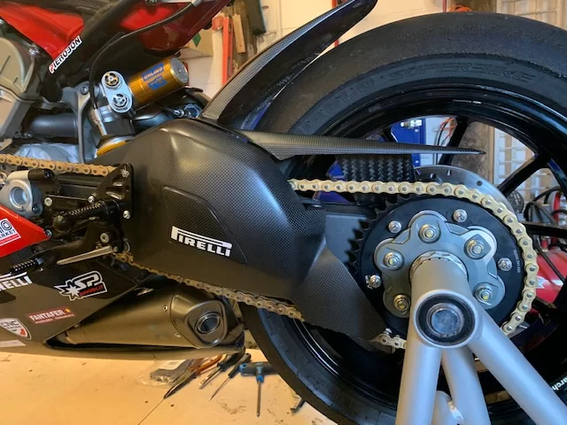

Another trinket I forgot...to replace the expensive headlight Std switch a bikesport developments Gucci one...that needs the electricity block you can see in pic 2 to work....

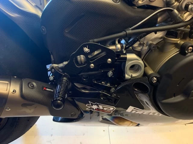

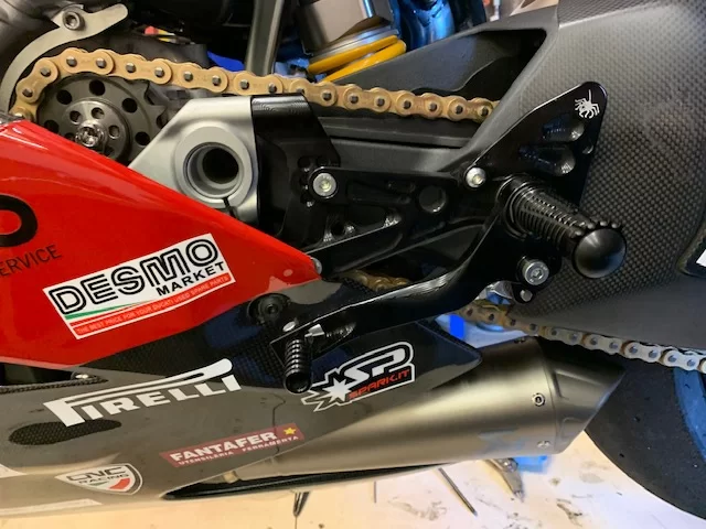

As an update... before I change the rearsets to DP ones... and my spare tank arrived from Italy so I can then make it brushed aluminium black Ducati and the put the tank grips on it....
