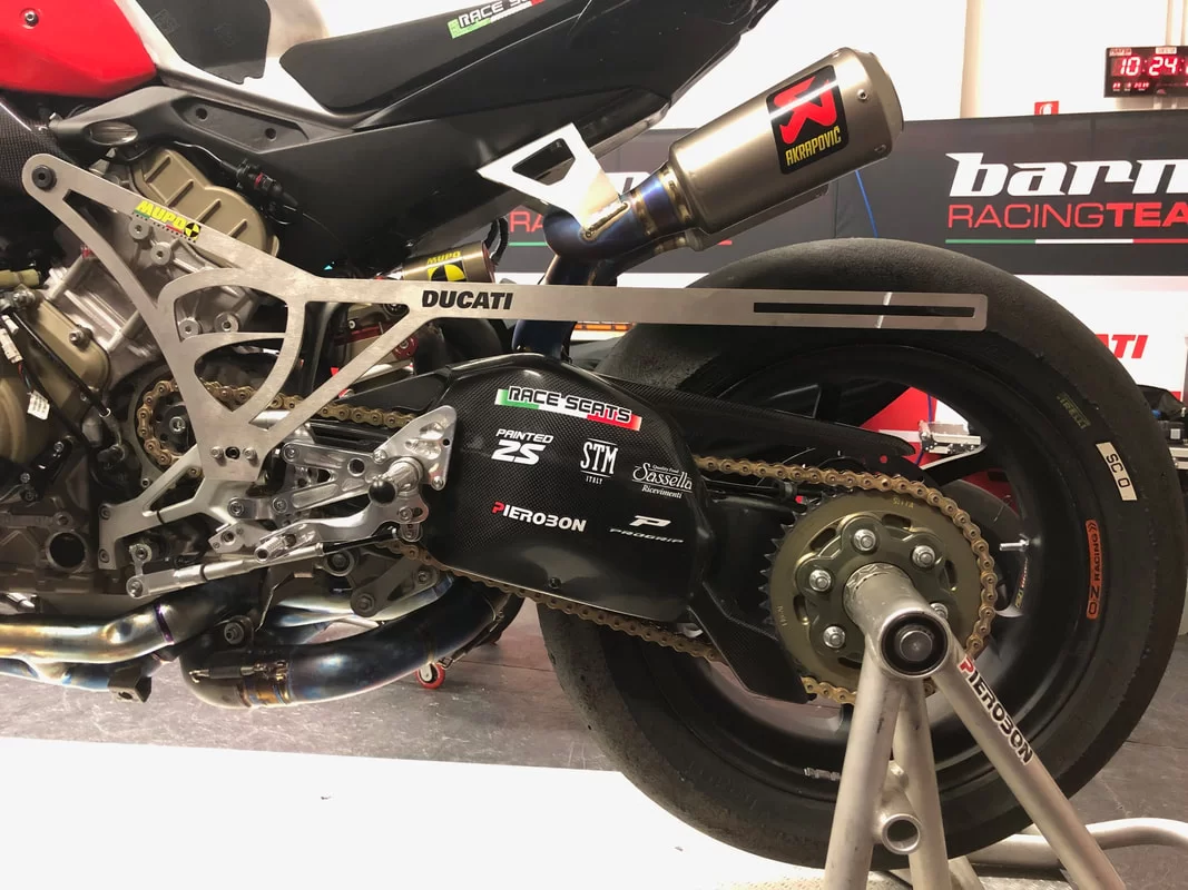

Now there has always been a rear ride height tool available which provides a datum line so you know where your bike rear is to a known value. In fact it was pretty much the same tool as 748 to 998RS to 999 to 1098RS. over the years. with the V2 and 1199 panigales I've seen a variety of ride height tools available too as those bike have the availability of a tie rod to adjust.
So where does this leave me with the rear ride height of the V4?
I was watching an American series where they are converting a v4R to an ultimate track bike. and saw them with a rear ride height tool.....hurrah I thought...it was a Corse part and corse price..

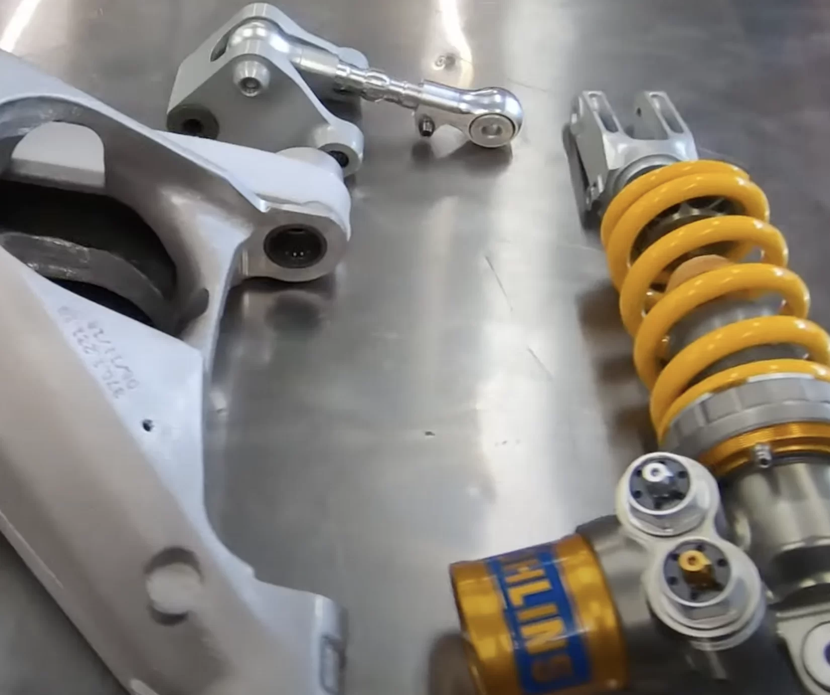

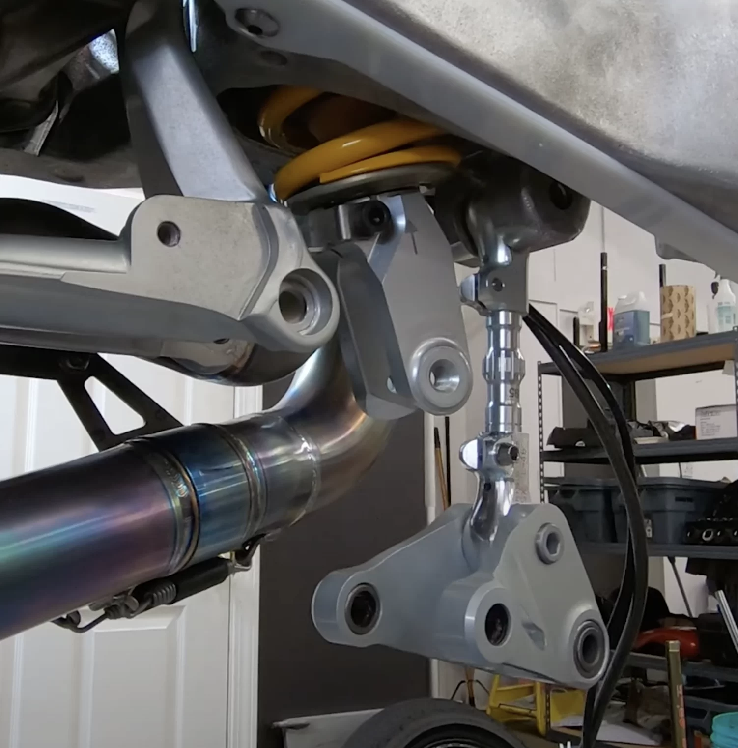

But it does prove that there is something out there. On the program it also showed them fitting a corse rear shock rocker and low and behold a tie rod. Albeit the set up was/is slightly different to the std bikes...

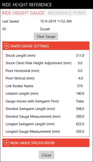

So I can now see where they mount it and an idea of where the cross bar sits for measuring. On the site linked to the tool I also found some numbers ie arm length ie where the wheel sits in the eccentric and the height of the tool I'm looking for completing my triangle of swing arm pivot, engine /frame mounting bolt, and the point above the axle..
