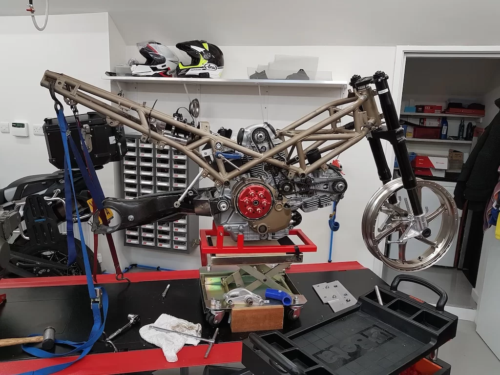

Sadly too, he was just starting a custom build Ducati that would have been epic & may very well still see the tarmac as one of his daughters has vowed to finish it.
It would have been nothing special in the great scheme of things, but his attention to detail would have made it awesome, one of those things you keep seeing things about it the longer you look.

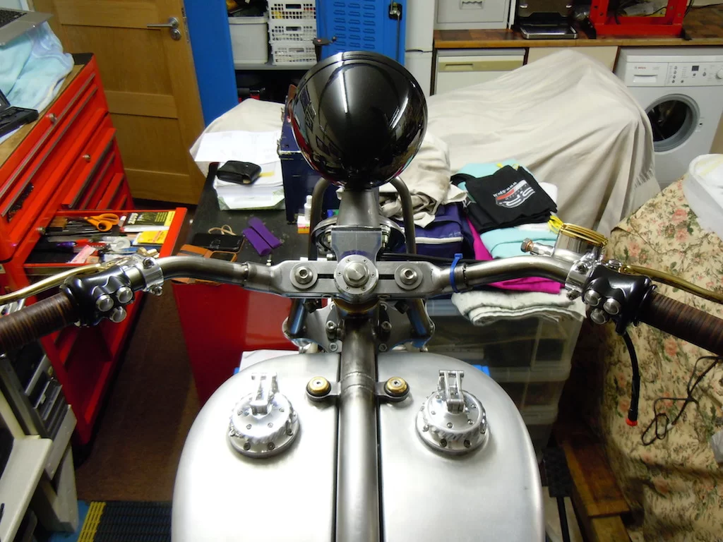

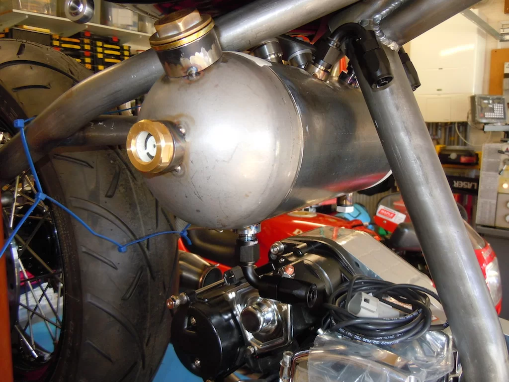

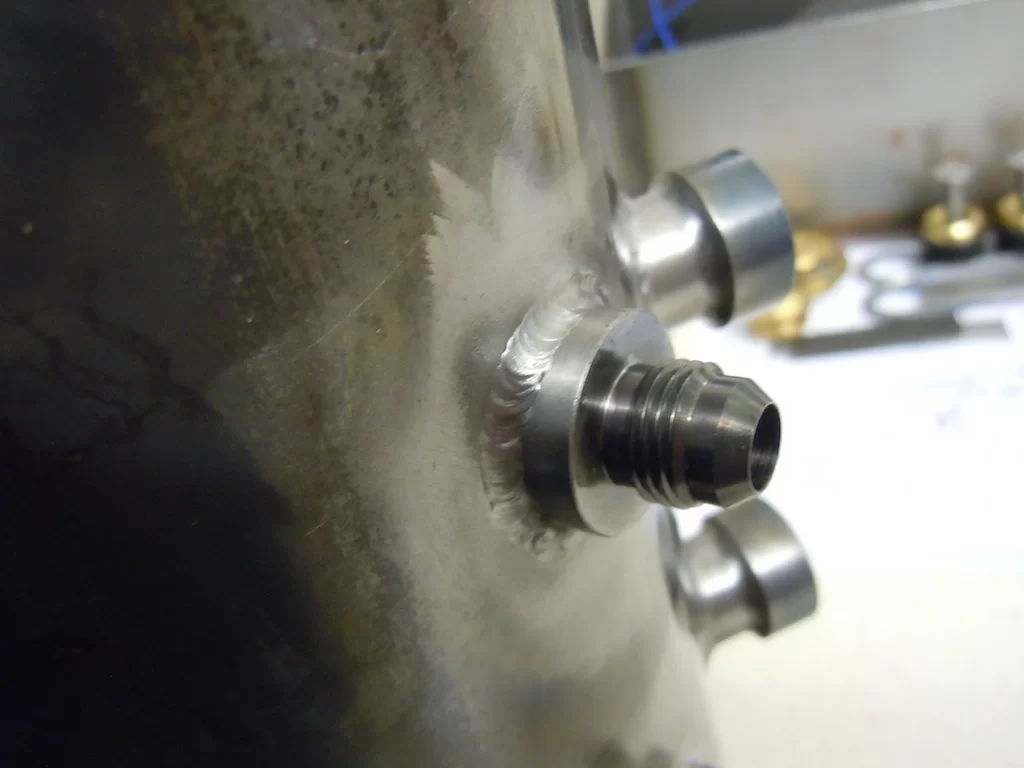

I was hoping to persuade him to let me do a build thread on here following it's progress, hopefully his daughter will let me do it now.

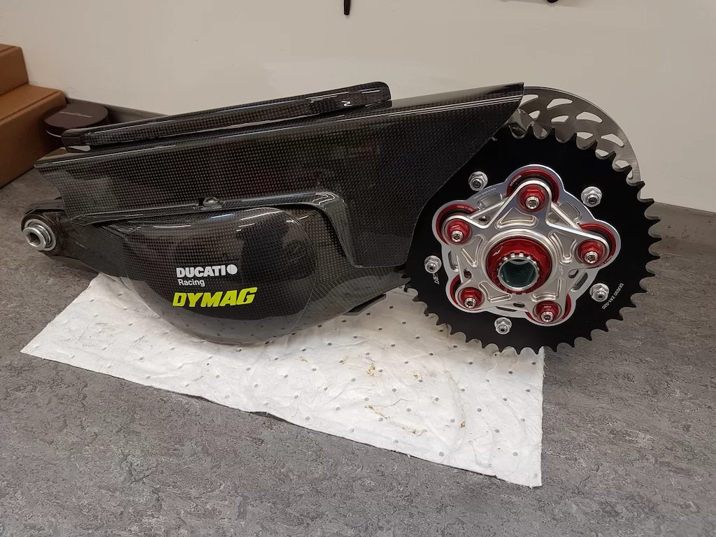

As a bit of a taster someone on here might recognise the swing-arm & another might remember selling him the ST they had, to use as a donor

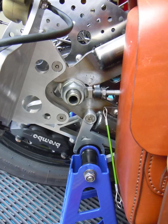

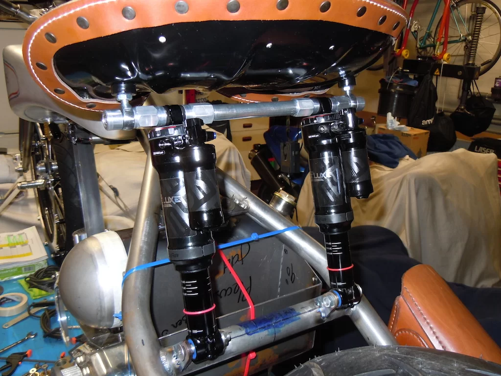

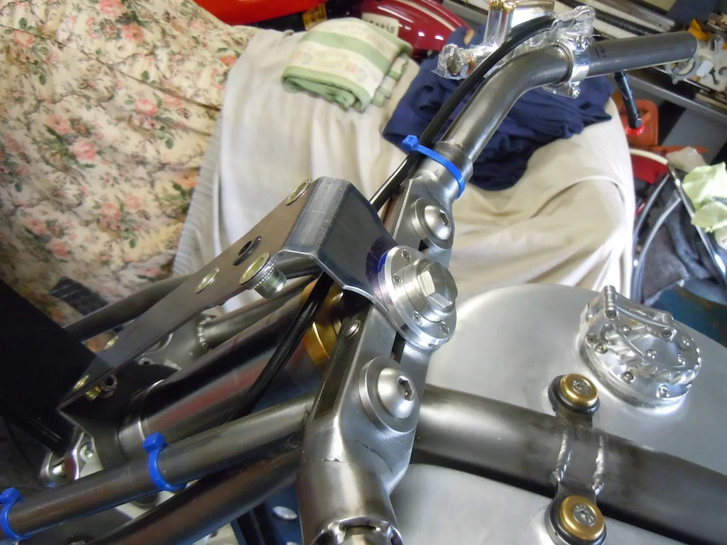

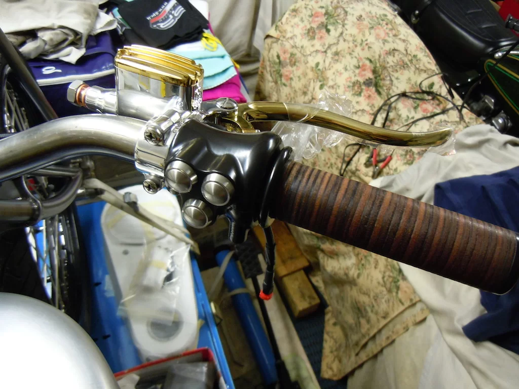

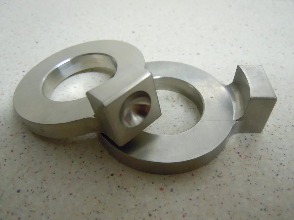

The ST frame was being used just to hold things in place & act as a basis for the geometry. Style was to be upright, no fairing, etc, air cooled motor potentially equipped with flat-slides, carbon swing-arm, Maxton forks & rear suspension, OZ wheels & StradaFab titanium frame. Rear suspension unit was to lie under the seat, out of sight from the side. He had printed all the linkage parts to check the suspension worked. there was to be machined side plates that were to hold the whole frame/engine/swing-arm together. Top quality Brembo machined brakes. RIP mate
