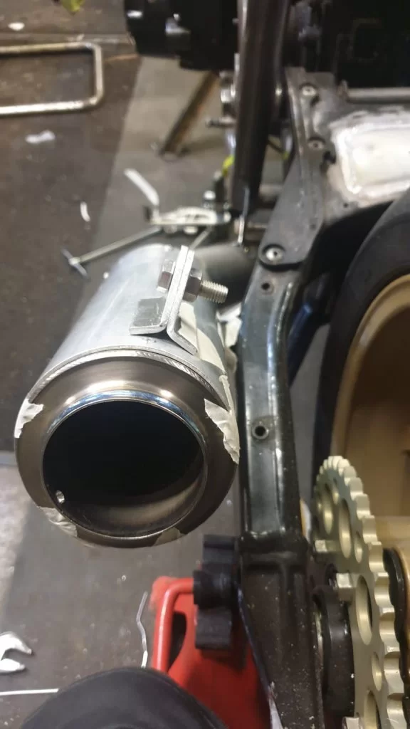

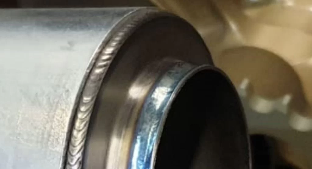

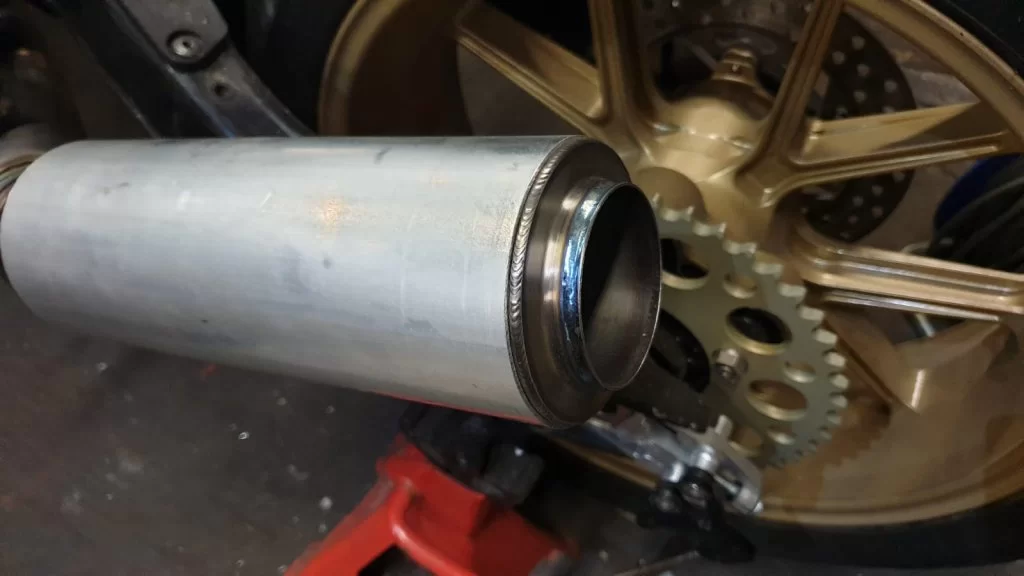

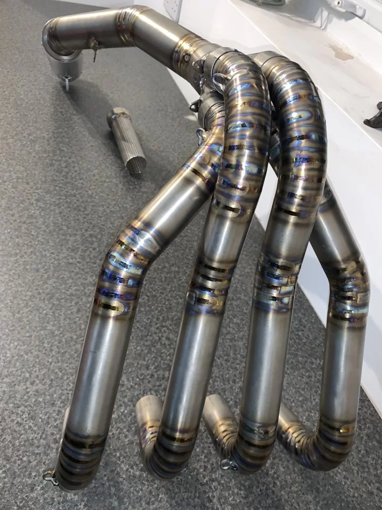

Some progress over in that there Hull 👀 :oops:🥳
So whilst your best welding dude is doing this for the bike, what else are you doing to it in preparation for when it comes back?
