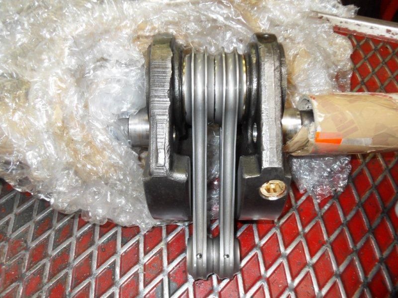

I think Godden have run out of their own bearings and Lacey make a modern replacement to the same specifications as the original. My bottom end is exactly as Martin says - The original rods have new inserts in which the Lacey bearings run on a new Godden pin; There is enough metal to do this. Even if you needed new rods, Goddens are a work of art...Snip... Godden use the same size of bearing in their own motors so are all set-up to make hardened inserts to reclaim rods rather than replace them. Ask whoever takes your crank apart to measure the width before they start, since a little over on the size when pressing back together can make the assembly too fat to fit in the cases, even without shims. Vacant used a special bearing from Lacey in his rods, if I recall.
I agree. Whilst it was a stinker of a bill, I was able to discuss the bottom end with Gary; I put forward one of my SS rod bottom ends I had lying around in a box to start with, and Gary discovered the sleeves had been drilled off centre and one rod was effectively 1mm longer than the other! Those rods went in the bin and I submitted my second SS set which he inspected and refurbished.Thats actually not bad, i mean its a silly amount but its competitive with replacing the rods bearings and pin.
Cranks are always a gamble. Chances are your will be fine i have three of four and all feel ok. The real giveaway is side float. there should be some but you should also be able to see if the side thrust washers are worked. Thats usually a good indication of how hard the crank has worn. Also you could clean out the sludge traps making sure not to push the sludge back in to the crank. If the sludge traps are chocka then there is a good chance the bearings might have suffered

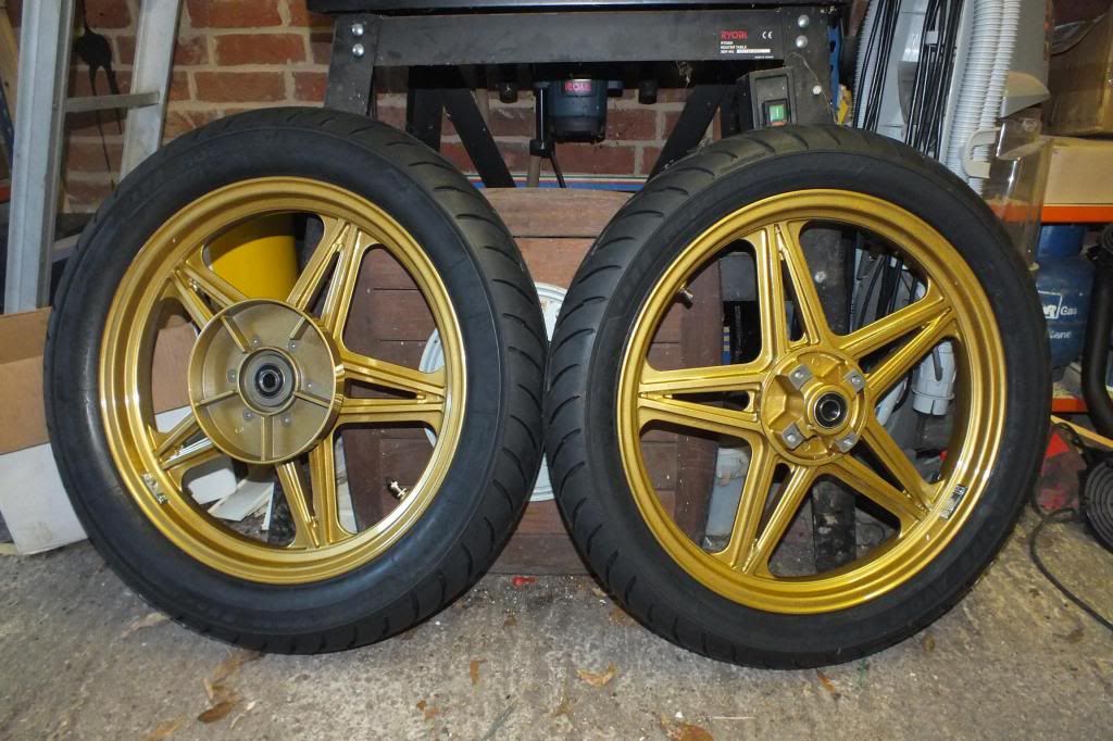

Bought these from openeo - free postage too at £144!
Avon AM26 Roadrider 100/90-18 56 V Front/Rear TL Quantity: 1 x 69 GBP
Avon AM26 Roadrider 120/90-18 65 V Rear TL Quantity: 1 x 76 GBP
I hope they are up to the hype!
