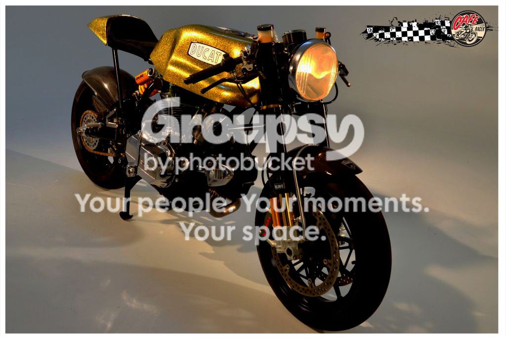

I just happened across the edition of Café racer where they tested the GT special. I loved the paint on that.
Many thanks Paddy for your excellent proposal for a painter - It's 178 miles from my place but better have a proper job done of it.
Pack kit up carefully and send it ?, maybe make the journey to pick it up to be safe ?
that special above doesn't work for me at all :-( If you are going to go over the top on the front then why leave that pencil thin swing arm. Maybe if it had the std SS controls on the bars it might look better but right now it looks like a classic with an ugly Monster front end cobbled on.
Sorry :)
I only said I liked the paint:o I agree that there is an imbalance between front and rear. I think that they shortened the swing Arm. I'd have like to have seen a different line for the seat support tubes (self-supporting would have been best) but it was for a TV show and we know how they distort reality. And that corn's not ripe.
