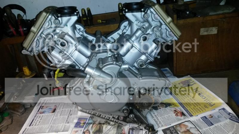

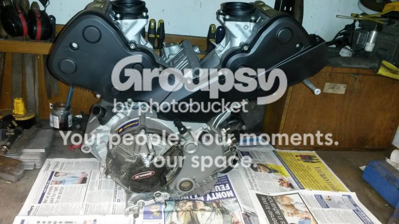

Last october i bought a 1098 engine from a track bike that was being broken, after getting it home i shoved it under a bench and left it whilst i finished a car project.
Saturday just gone finally saw the time for things to commence.

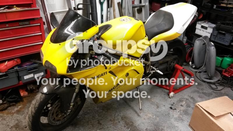

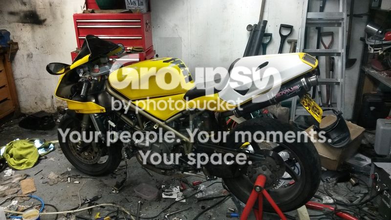

The unwitting victim of this swap, '98 916 biposto

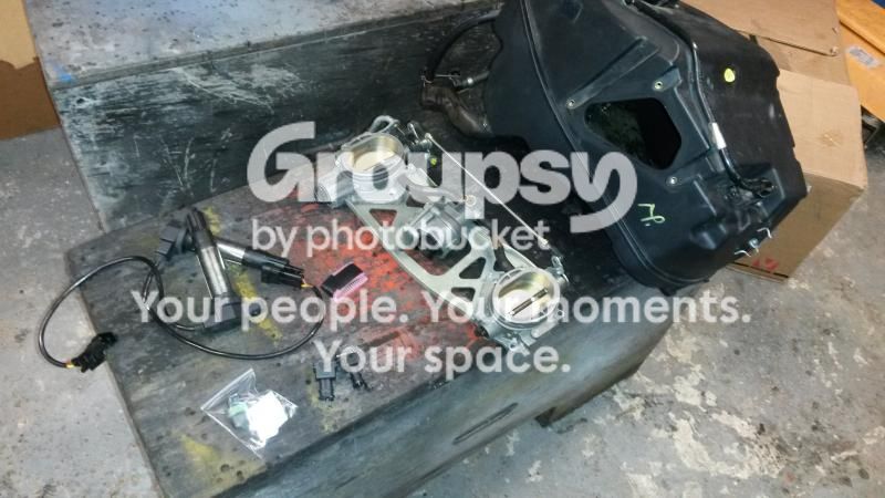

A few of the bits needed, from l to r, new 1098 tps connector, 1098 stick coils, new injector connectors, eeprom from tomtom on ducati.ms allows the 1098 tps to work with the 916 injection setup. 1098 throttle bodies, 1098 airbox with velocity stacks and shower injectors.

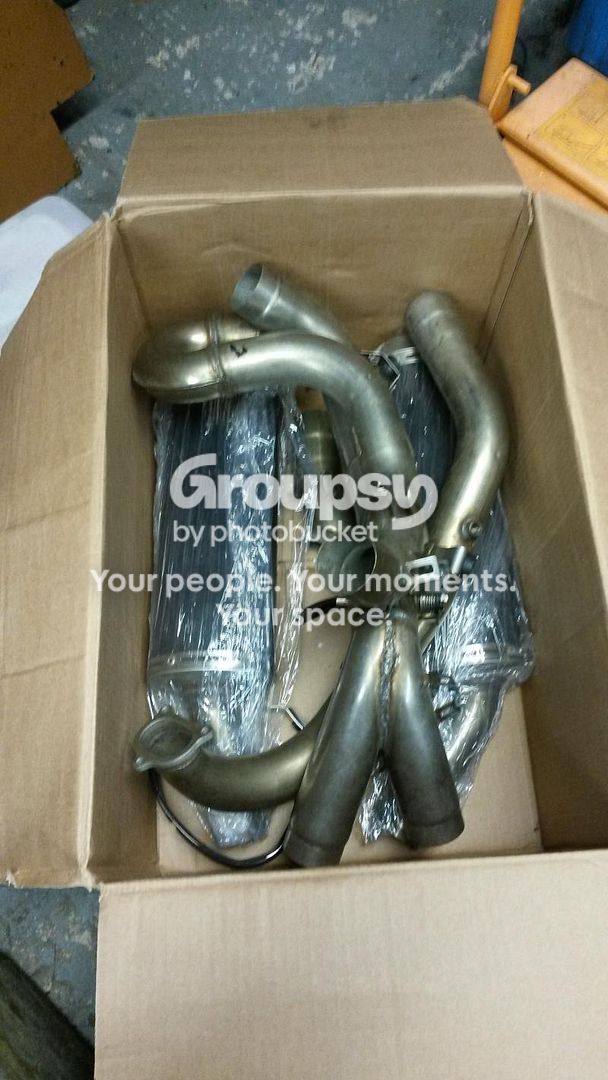

Complete 1098 exhaust system

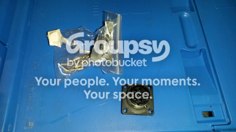

Now having never seen a 1098 engine before buying this one i hadn't realised i was missing a couple of important bits. The holes in both heads should have plastic outlets for the coolant hoses to attach to, the horizontal one also holds the coolant temperature sensor. The third hole towards the centre holds the crank position sensor.
I took a trip to see nelly at cornerspeed ducati, the 2 coolant outlets came to £32 and will be with me next monday. Unfortunately the cts and crank sensor were £65 and £80 at nearly £150 for the pair i didn't order them and sought other options. After digging around and a chat with derek it turns out the crank sensor from a fiat punto is the same so a trip to eurocarparts and £20 later i have a crank sensor sorted. Im going to use my 916 cts for the moment until i can source a reasonably priced alternative.

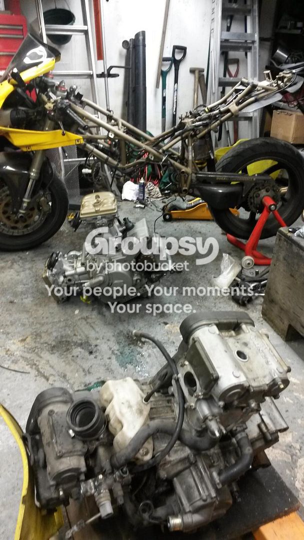

All parts sorted i set about removing the 916 lump
Stripdown was straightforward, the swingarm pivot bolt was a bit stubborn but eventually gave into my shortened sledgehammer, i will now need to check the swingarm bearings and bushes considering the hammering involved in removing the bolt.
Old vs. New

Ive trial fitted the throttle bodies and the linkage rod just touches the original coil mount so ill need to notch a piece out later.

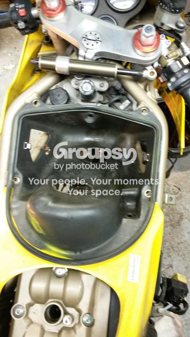

I also cut out the floor of the 1098 airbox around where it mounts to the throttle bodies, tomorrow will see me cut the floor out of the 916 airbox and friday ill start to fibreglass the 2 together and hopefully by the end of the weekend ill have a complete airbox.

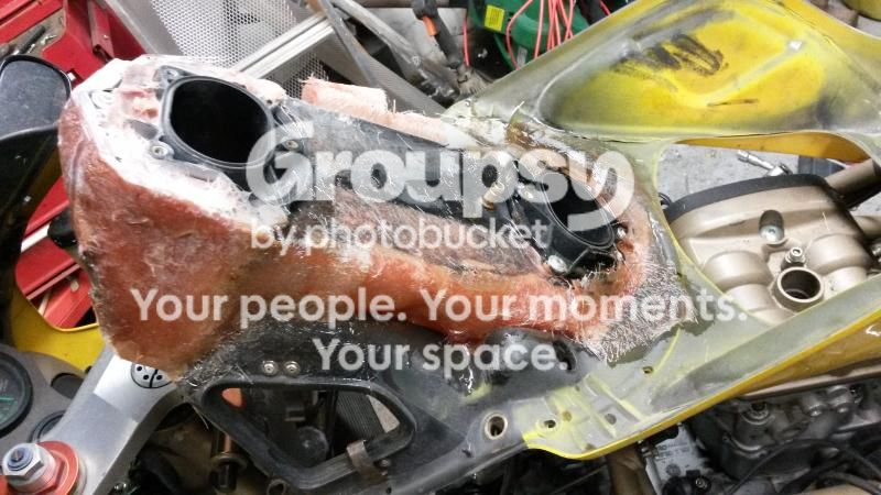

well the weekend has been and gone and i haven't got as far as id hoped, a few issues became apparent and the airbox is alot more time consuming than id planned but things are progressing.
the bit marked in black is the piece that needs notching to allow the throttle body linkage to operate freely

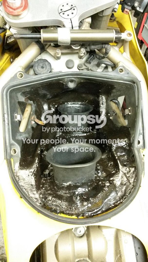

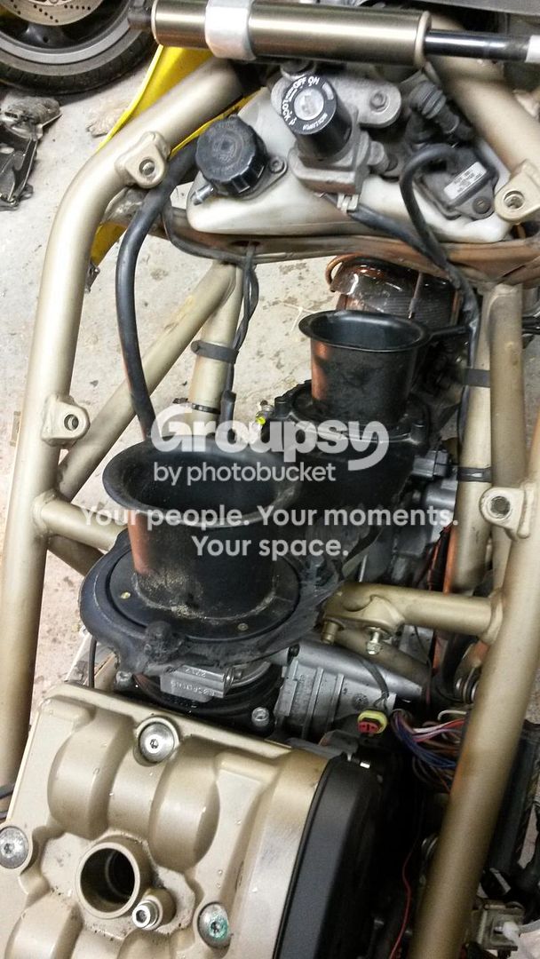

that's the bottom of the 1098 airbox cut out leaving me with the velocity stacks and flat plastic between to fibreglass the 916 box too.
the stacks fitted to the throttle bodies

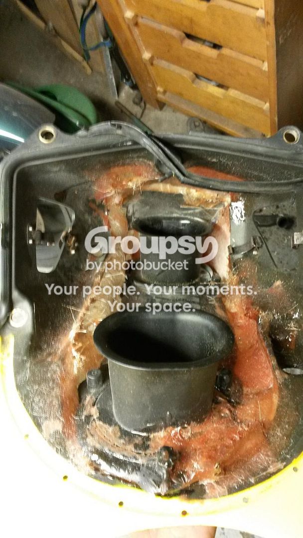

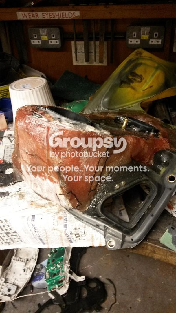

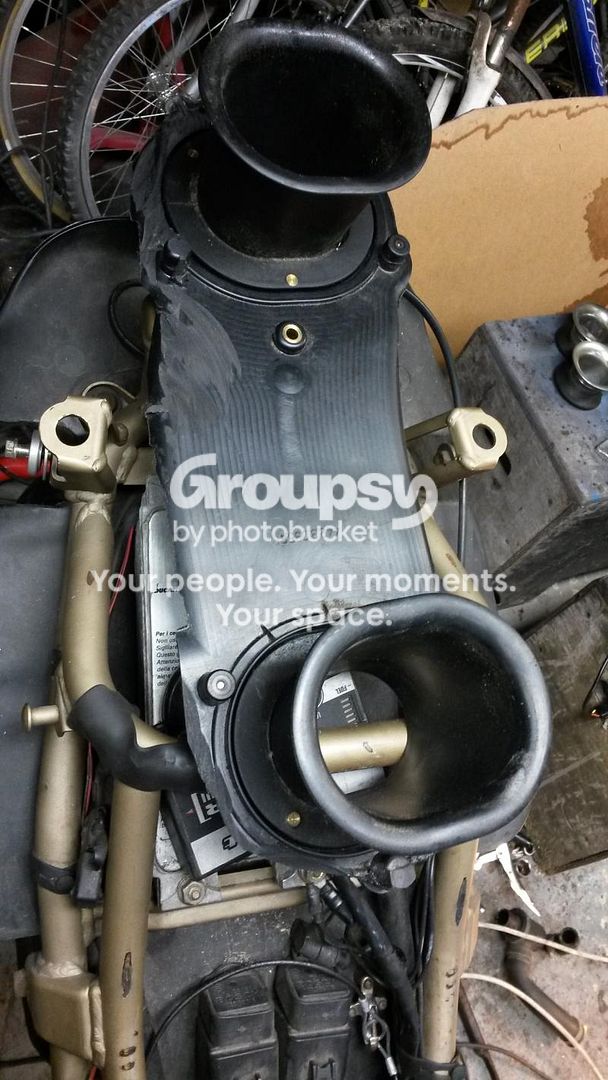

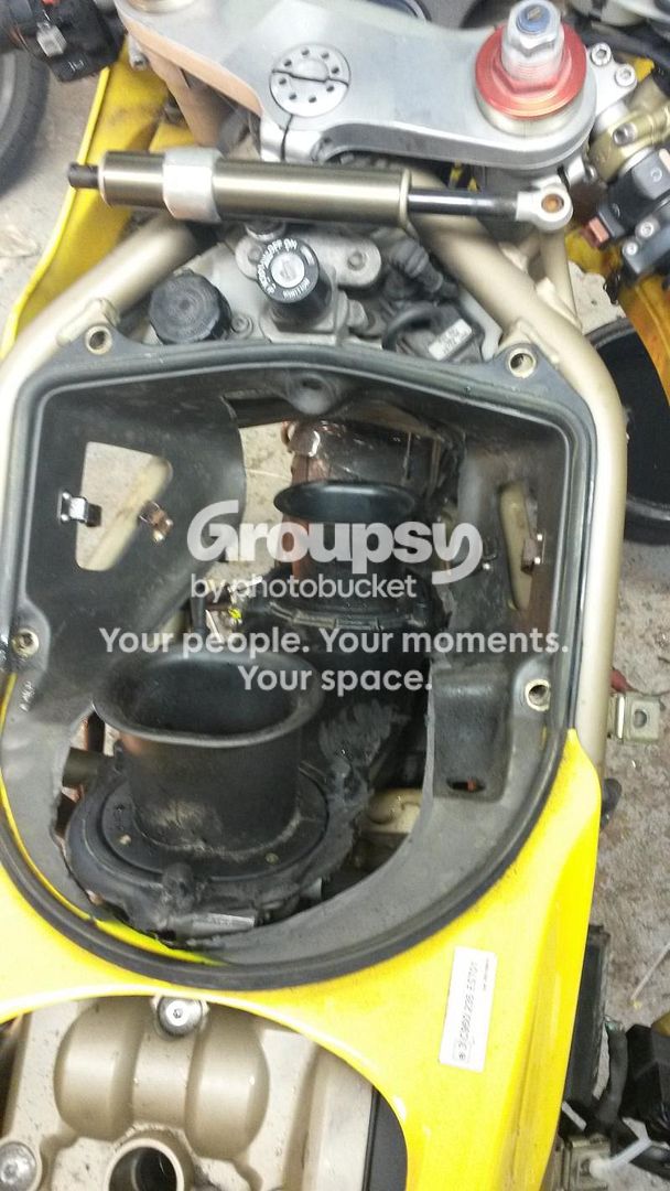

the stock 916 airbox before cutting

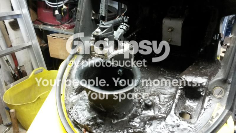

916 airbox after cutting showing how much needs fibreglassing to merge the two.

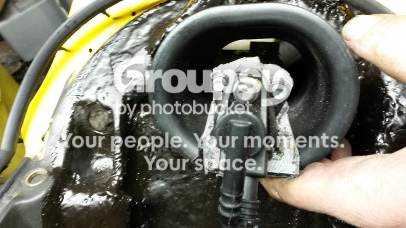

the fibreglass work has been tedious to say the least and has involved alot of laying down some fibreglass to make the two halves rigid then removing some of the first layers laid then replacing that with final more shaped pieces. adding more bracing pieces removing them etc. to get a workable shape, this coupled with constant trial fitting and having to wait 30 minutes drying time after laying each bit has made the job rather time consuming but i think im winning.
the underside
and fitted
ive also looked at the exhaust in between the airbox work
that's the 1098 link pipe fitted as you can see the angle of the exits are wrong for the 916 subframe
i also hadn't realised before i fished the 1098 parts out of the box that the 1098 uses a single link pipe with a y merge to the cans unlike the 916 which has seperate pipes for each cylinder
after some head scratching i took some action and ive cut the 1098 link pipe just below the flapper valve, a quick look on ebay and i found this and i cut the tops off a damaged 916 45/50mm link pipe i had. ill get the 916 tops welded to the outlets of the y piece then i just need to cut down the pipes on the cans so the y sits nicely under the subframe and then have a 54mm pipe bent to meet the original 1098 link pipe and the whole lot neatly welded up. i just need to bring myself to take a saw to my lovely remus cans.

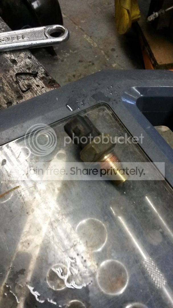

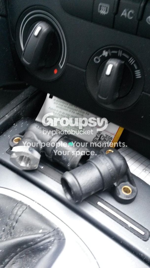

one of these arrived it'll take the sensor for the dash water gauge and ill drill and tap it to take the fan switch sensor too, the sensor for the dash sheared off when i went to remove it today so ill have to sort a replacement for that now aswell (£52 from ducati, can't believe the sensors are so much)
received a call from nelly at cornerspeed to say these had arrived
i removed the 916 coolant temperature sensor
the one i have the flange to the end is about 22mm and is marked wts09. when fitted to the outlet housing it's nowhere near the bottom, it'll probably still work as the coolant will fill the housing but id prefer a longer sensor which i guess is the wts05 derek referred too.

finally finished laying up the overall shape of the airbox,
it needs some more strengthening in quite a few places and i need to layup over all the joints again but the final shape is there
well plodded on a bit more with this, airbox is now done and painted with black fibreglass top coat to seal it
still looks a bit untidy but it'll do the whole lots hidden anyway.

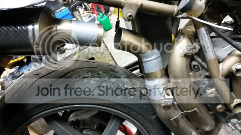

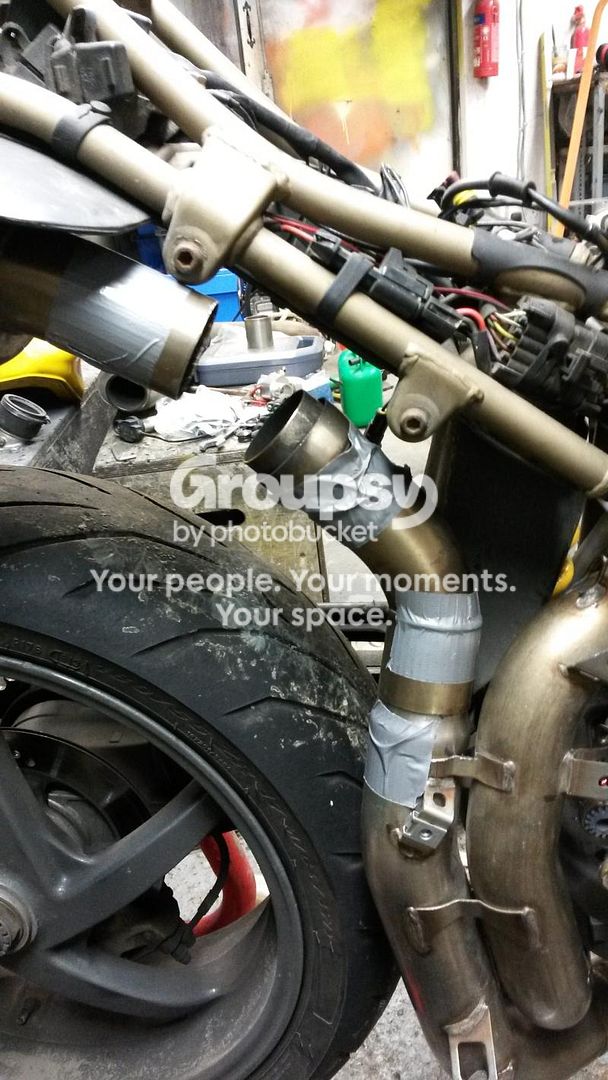

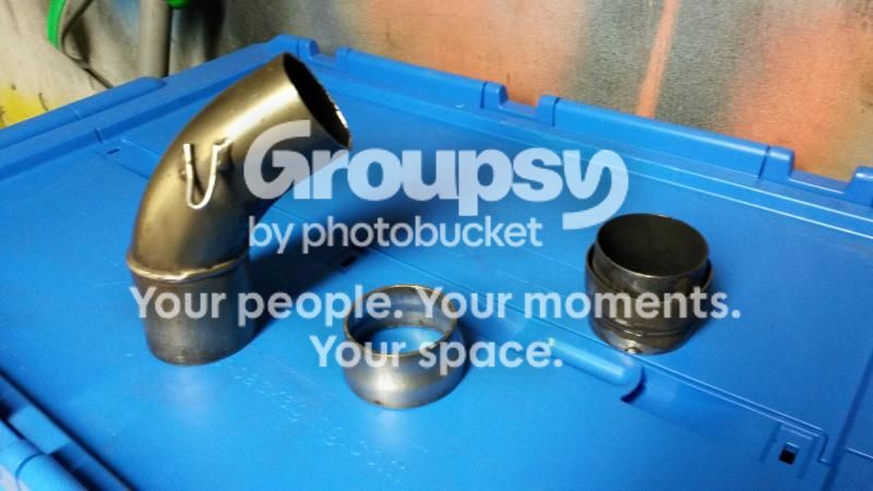

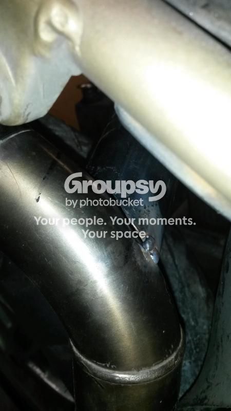

the other big job for the bike is the exhaust, i spoke earlier about wanting to use a prefabbed y piece but now ive actually looked at the job properly it's just not going to happen so ive had to set about hand making something.

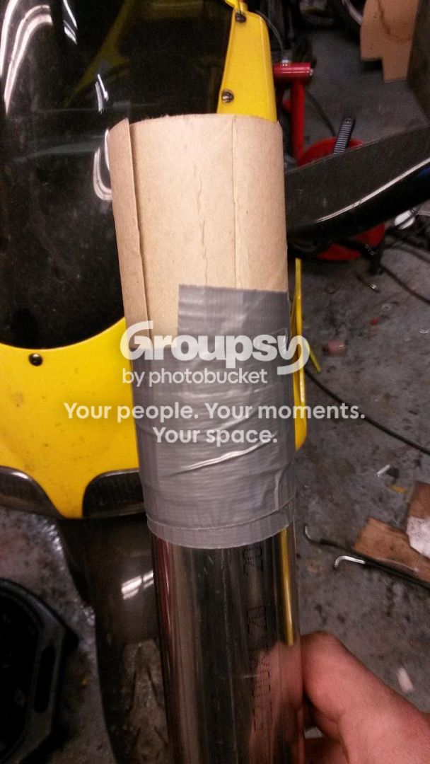

after a large amount of fannying about looking at numerous options it was decided that with a bit of cutting the right side can would just about meet up with the exit from the 1098 link pipe, i could then y the left can into the right just after the bend under the subframe. this decided i ordered one of these reducers to go from the 57mm o/d 1098 link pipe to the 52mm o/d 916 pipe.
the middle piece is the reducer ive cut it right down for my needs. the left is the end of the 916 exhaust can and the right is the top piece of the 916 link pipe. ill be honest i was very nervous about cutting my 916 cans, there not cheap to replace
used some duct tape to hold things together for now it goes 1098 link pipe, the small reducer piece, the end of the 916 can then obviously the 916 exhaust
this shows where the original 916 link pipe end will fit so the system is still removable in separate parts. (the exhaust can is slid right back in it's mount in the photo, i need to get the end swaged at my local exhaust place so it slots in the 916 link piece.) that lot will then need tacking together ready for my exhaust place to weld, that's the easy pipe the other can will just need one cut making then the end piece notching to merge into the other pipe which im not looking forward to ive got some spare pipe to practice getting the angles right on first.

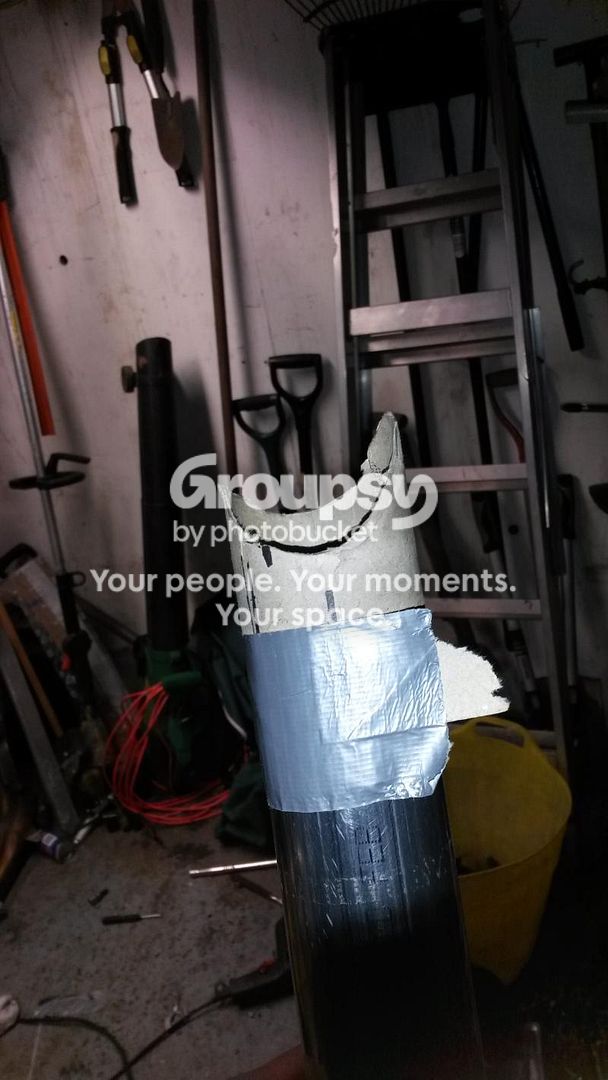

First half is finished and tacked together
I then cut the other can on it's straight part and marked it against the now tacked bend where i want both pipes to merge. I cut a toilet roll inner and taped it to the end of a pipe and used it to mark where i needed to cut the pipe to meet nicely.
I then transferred it to the pipe and started cutting it
It still needs some fettling with a die grinder but im happy it should work

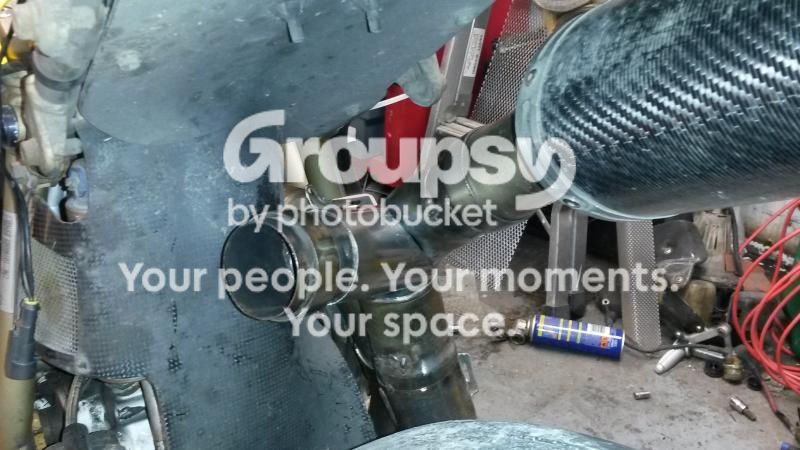

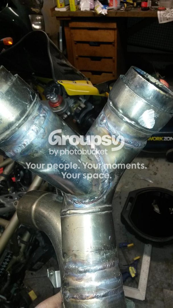

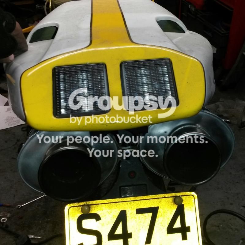

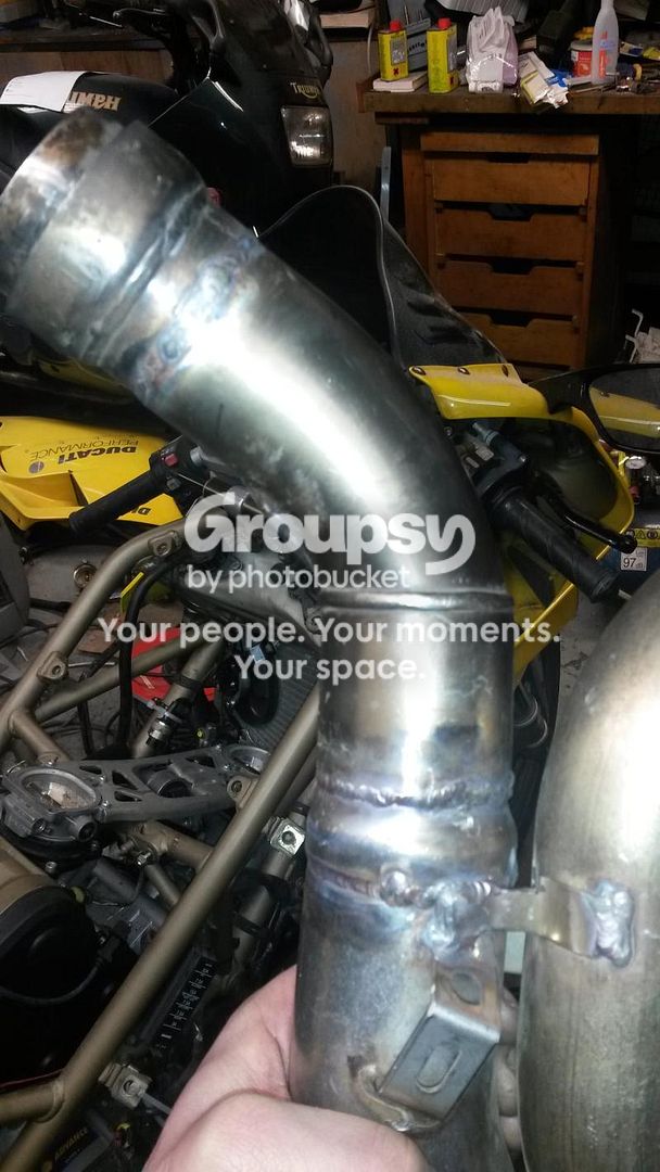

today ive been doing the y piece on the exhaust, it's taken hours and been a right pain but i think it's finally there, i need to get the exhaust can expanded to fit the slip on piece ive made then i can do the last bits of tacking and then send it out to be welded up properly
sorry only more exhaust pictures to see, it's finally fully tacked up and ready to go for tig welding, to say ive never done anything like this before im very happy with the outcome

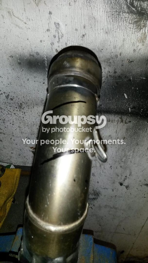

picked my link pipe up from the welders,
it's not a bad job for £40, the welds need tidying up which isn't a problem as i need to remove all the brackets and spring holders that aren't used and make a couple of brackets to match the 916 frame.

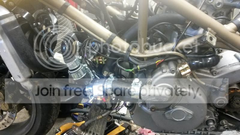

ive also worked out the coolant system plumbing and ordered the hoses i need, next up will be mounting and wiring the injectors and tps
after a break away ive returned and done a few bits more, the extra coolant hoses and bits arrived so ive test fitted the coolant system, im just waiting on some mikalor clamps and that job will be finished.

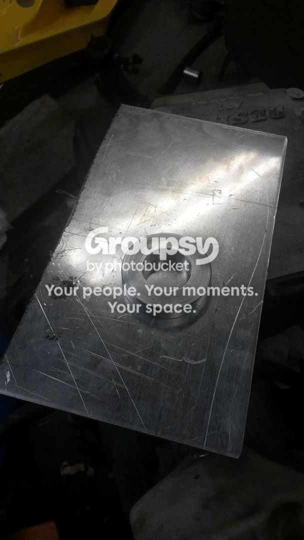

i also had a couple of spacers made up at work and bought an offcut of 3mm aluminium sheet.
after some cutting, drilling and bashing ive got an injector mount
i need to source some longer bolts then ill drill the ends and fit split pins to make sure they can't come adrift and cause any damage as one in the intake would be fairly catastrophic

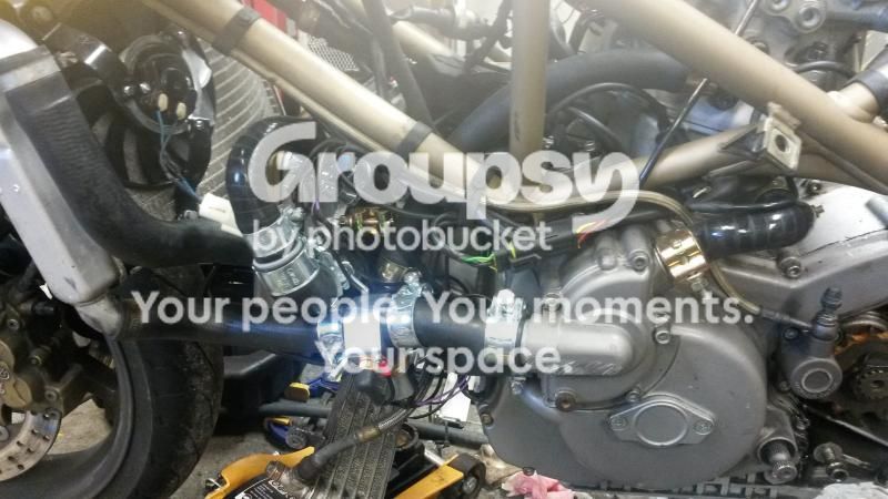

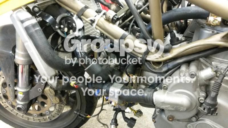

as you can see i finished my cooling system plumbing, it's not as neat as some but it should work ok
the 1098 doesn't have a earth point on the cases like the 916 does so i used this spare hole on the horizontal head, you can also see an amp waterproof connector i used these plugs for all my wiring.
i made a bracket to mount my injection plug where the stepper motor used to be.
that's about all i have pictures of as the majority of what ive done has just been running the wiring, fitting fuel lines etc. nothing much to photo.

ive done the final fitting of my airbox and throttle bodies, ive adjusted the linkage so both valves are in sync and set the air screws to 2 turns out as a start point, i need to adjust it all up and sync it with a manometer once it's running.

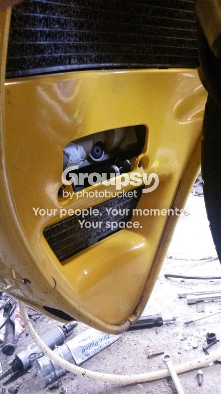

i then looked at mounting the 916 oil cooler and v piece,
i cut up the brace for mounting the 1098 oil cooler, the left hand mount in the picture is the old 1098 right side with an m6 hole drilled and tapped into it i then screwed in an old 916 seat mount and ground it all down to the same size, this extended hanger allowed me to shift the oil cooler far enough to the left to line the v piece up properly. i just need to machine a spacer up for the right hand mount and it'll be finished.
v piece nicely lined up, to secure it im going to make 2 L brackets secured by the oil cooler brackets and fix it with 2 dzus fasteners. for now im going to fill the top recess with black mesh and come back to it later.

Whilst doing some minor syncing of the throttle bodies i noticed the alternative sensor i got for the temp gauge doesn't work so ive bit the bullet and bought a new genuine one, at the same time the upper coolant reservoir sprang a leak, fairly common issue this one is the original so im waiting on those parts.
Outside of those things ive finished my exhaust link pipe having added extra hook mounts for the springs and removing any brackets i didn't need. Ive the spacers for my v piece mounting bracket being made this week and that leaves me the chain to fit and rearsets to set up.

with the new temp sensor fitted i had a working temp gauge, i can confirm the up to date part number required is 55210442A. unfortunately i noticed the sensor was weeping slightly so i removed it fitted a small amount of ptfe tape and a new crush washer and i sheared it on refitting it that's 2 of the poxy things now :jerkoff:

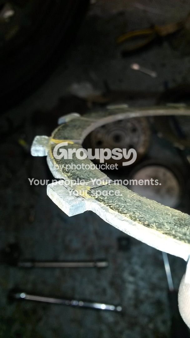

whilst setting up the gearchange on my rearsets i wasn't happy with the clutch action so decided to pull the clutch basket apart and see what was going on,
that's the best of the friction plates, there supposed to be 2.8mm minimum the majority are nearly fully smooth so they'll need replacing fortunately the plates just need a light clean up.

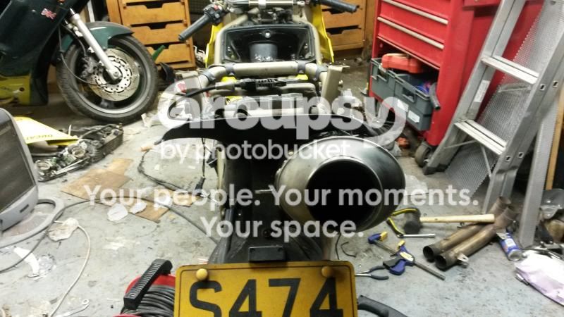

and that's the bike as she stands now, ive the chain to finish fitting, the front sprocket is on im hoping to get an alloy coolant tank and clutch friction plates this week but besides those it's finished and hopefully ill make fridays dyno session else there's every chance i won't be riding it this season as were a couple of weeks away from getting the keys to our new house and that will be taking up all my spare time
