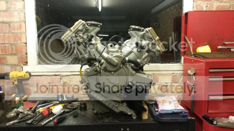

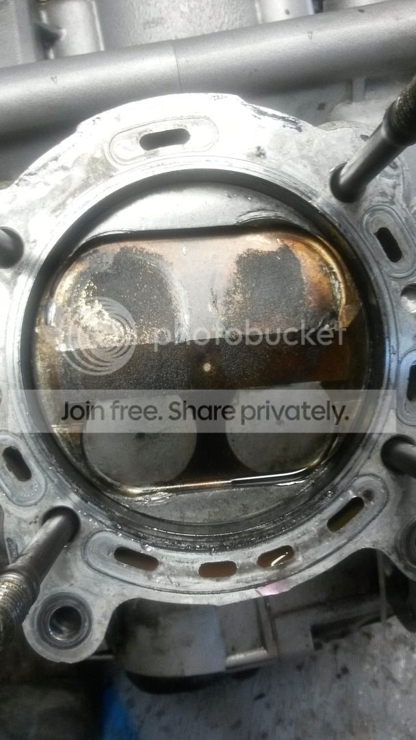

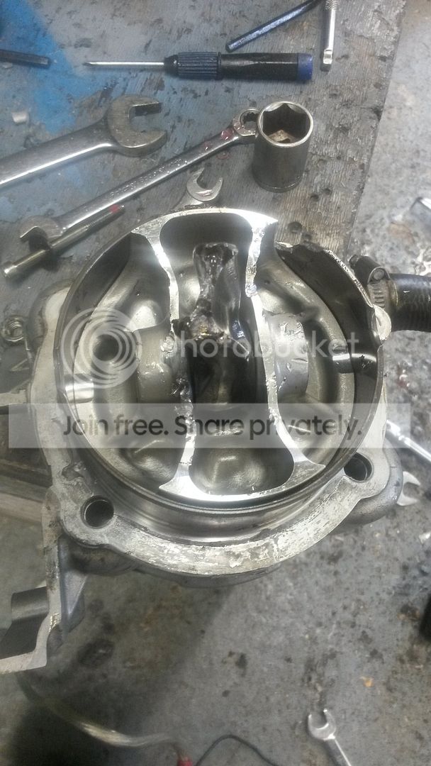

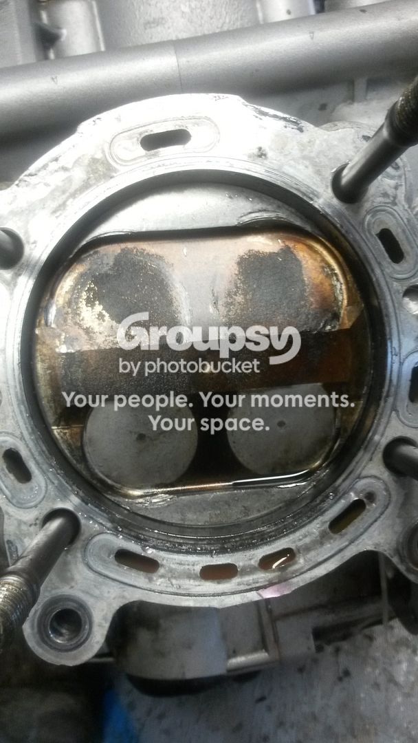

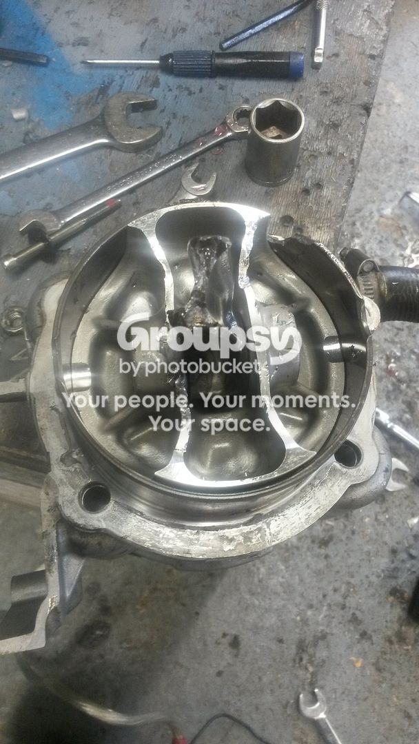

It's a mess, I am really sorry after all the hard work you have put in.
There must be a reason - although I see it doesn't help you now.
Flog the un-shagged engine parts separately to get the best return and await an eBay replacement?
I wish you good luck, what a mess :(.
It happens unfortunately part of building non standard stuff, ill look into the exact cause at some point but im mainly happy it happened on a dyno and not out on the road as the results would be alot worse than the £900 i paid for the engine.
Yes ill be sourcing a low mileage replacement at some point.

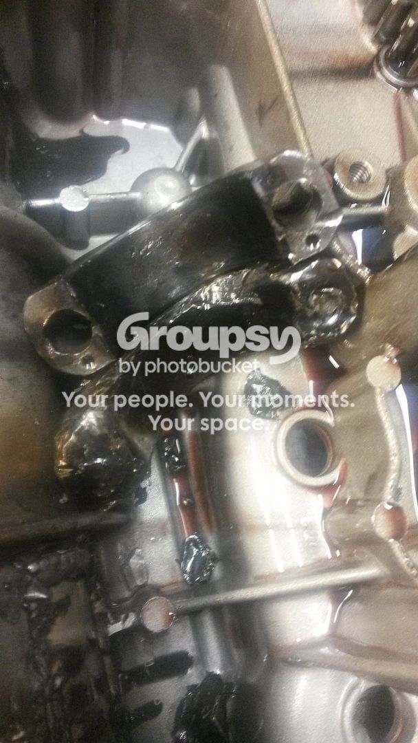

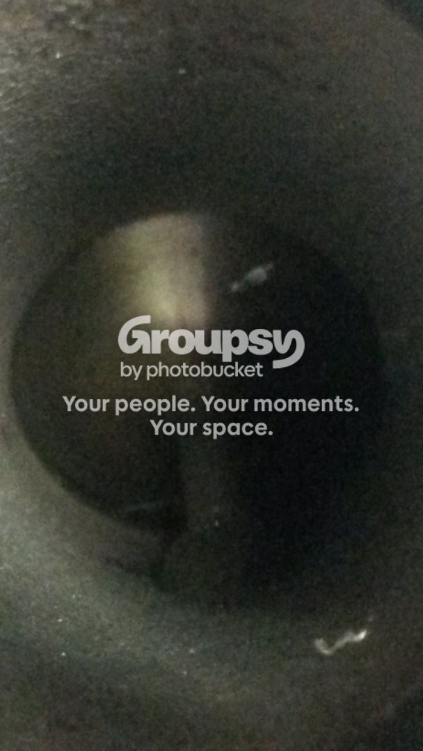

Looks like the valves started hitting the piston, which broke the valve stem & broke the con rod which...
(There is a very good chance I have misread the pickies :scratchhead:)
Surely a rev limiter would have stopped this? Is their a limiter on the 1098?

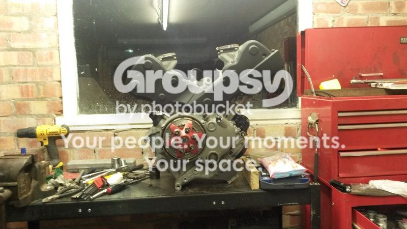

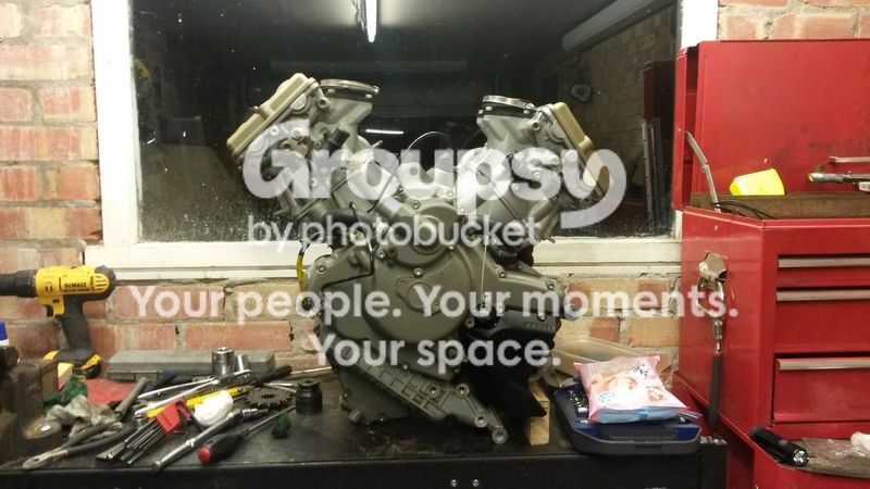

time to dust this one off again. at the end of september i managed to find a low mileage engine with full dealer history but due to house renovations and other stuff it's just been left in a corner.
this weekend i got it out and swapped out the few 1098 bits that need replacing with 916 stuff.

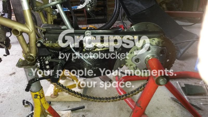

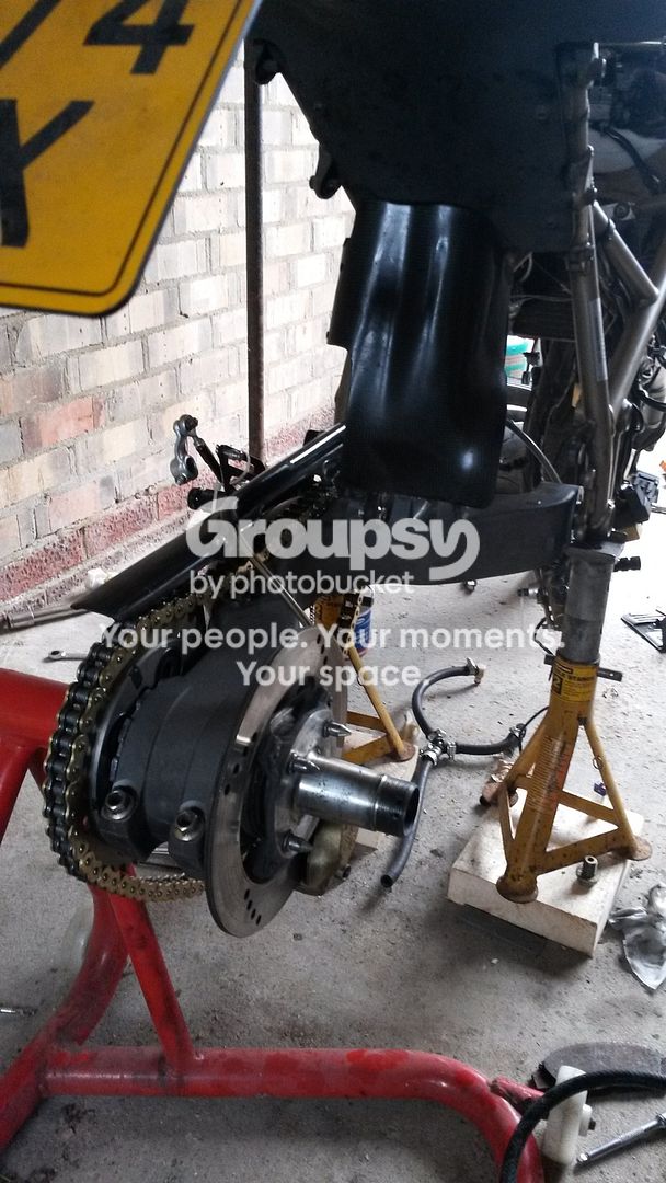

i also stripped down the rear swingarm and suspension, everything was cleaned with a mixture of paraffin and baby wipes, i replaced the swingarm bearings everything else was greased/checked as required. i also fitted new rear brake pads as one had delaminated from the metal backing.

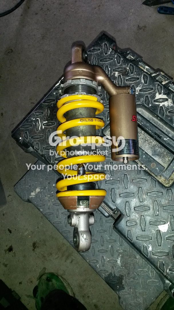

and lastly i finally stripped and refreshed my rear showa shock including fitting a more appropriate spring for my weight, tomorrow ill take it to have the nitrogen recharged
it's booked in at cornerspeed for mapping on the 18th, hopefully the engine will be bolted in tomorrow then ive the rest of the week to plumb it up and reconnect everything should be doable

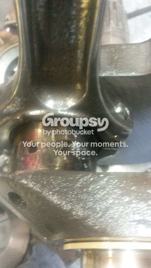

Did the oil stink of fuel? the overfuelling can cause bore wash and then you get fuel getting into the oil, and then you start spinning big ends.
No there was nothing obviously unusual, since i posted the pictures last year a few have said it's happened to them even on bikes with full service history

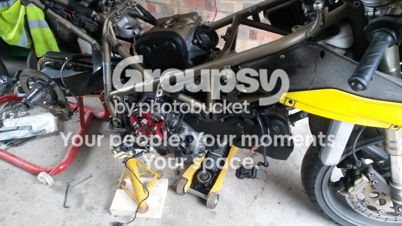

spent the last few days fitting the new engine back into the frame,

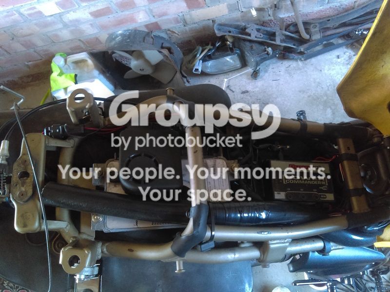

I'd decided awhile ago to relocate my alarm to under the seat and to change the ecu, fuel pump and ignition relays for solid state relays, quite a straight forward job just time consuming
Whilst moving those relays I also decided to move the indicator relay next to the regulator/rectifier this now means I've clear access to the oil filler and it looks tidier in my opinion
Stock 916 relay locations
My bike
I've also relocated my crankcase breather filter to under the seat to keep it out of the elements, and lastly I've reworked the piping for my coolant system as the bike was getting warm during extended dyno runs.
[qimg]http://i46.photobucket.com/albums/f109/thomp1983/1098%20swap/20160412_145123_zpsmwixehzc.jpg[/qimg]
dropped it off at cornerspeed this morning for nelly to tune it, hung around for a few hours whilst he looked it all over and did the first few warm up runs, first runs were showing 144bhp at the wheel which neil reckons is on the money for a healthy stock 1098 engine now just have to endure the wait until he's finished with it and then i can bring it home and take it apart again
when it's home i plan to refit the kawasaki stick coils ive got, ive bought some solid state relays to fit so im going to rewire the bike to do away with the stock relays down by the battery and those under the seat, ill mount these in a box in the tail along with my alarm unit.
i also need to remove the tank, fit a new fuel filter and go over the fuel circuit then lastly rebuild the front forks and reset all the suspension hopefully ill have it all squared away for may and be able to enjoy a hassle free summer of abusing her again :D
