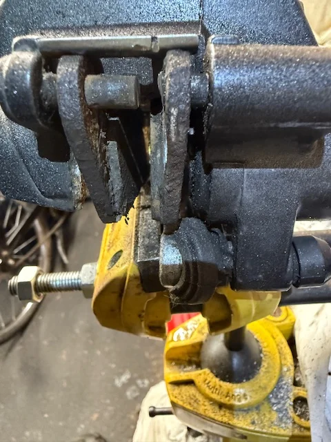

You don’t know how true that is 😕. I’ve a Honda CBR400RR with me at present which spends its life outdoors. I had to cut the glide pin in the front right caliper to be able to remove the pads to service the pistons and replace the pads. The glide pin was, still is, seized solid 😞. Couldn’t be removed at all, not even drilled out. Ended up having to buy a replacement caliper 😕.

I wasn't sure if you were being facetious or genuine, thanks for the tip. However, an eductaed guess says it won't work, the viscosity of the melted wax being too low and fully penetrate as a penetrating oil does.
Incidentally, I did try heat, got the MAP torch on the caliper, didn't work :(. Waiting for teh replacement (2nd hand) caliper now.

Normally I would agree but as it was the caliper itself I was heating up I didn’t want to take it too far in case the piston chambers distorted irrevocably. It was beginning to catch fire in places as it was 😮.
Anyway, it’s a pile of rusty shite and as the replacement only cost €30 + €7 delivery there comes a point where one has to bite the bullet and accept it’s cheaper to replace than spend time trying to repair.
