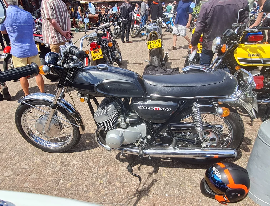

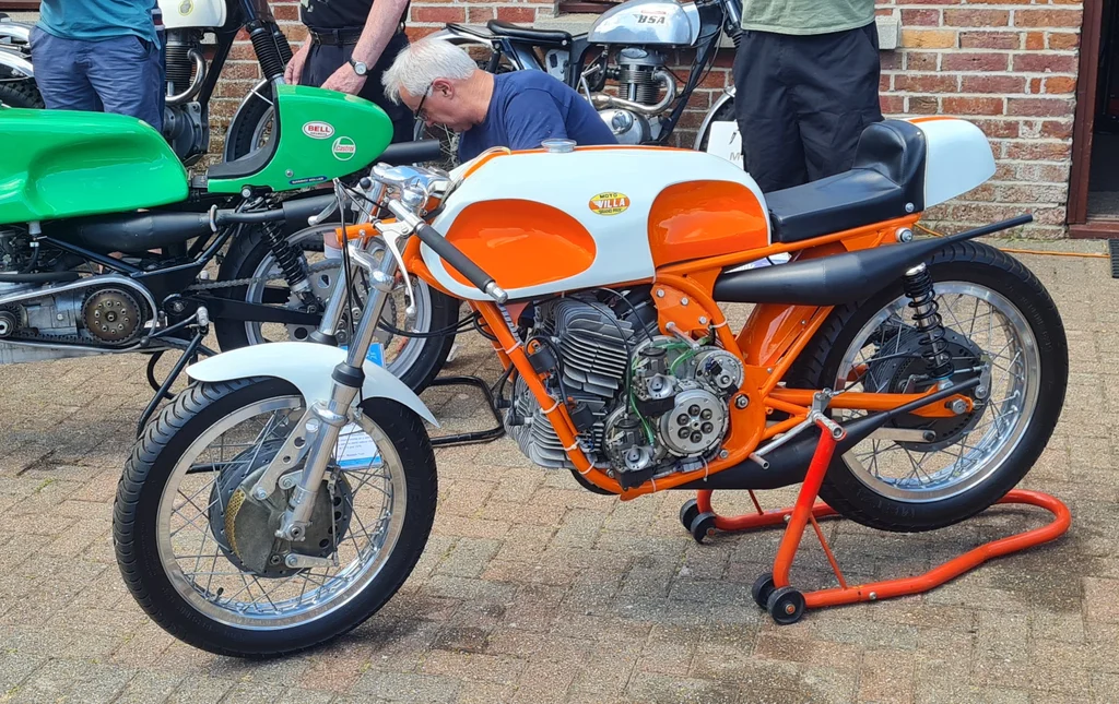

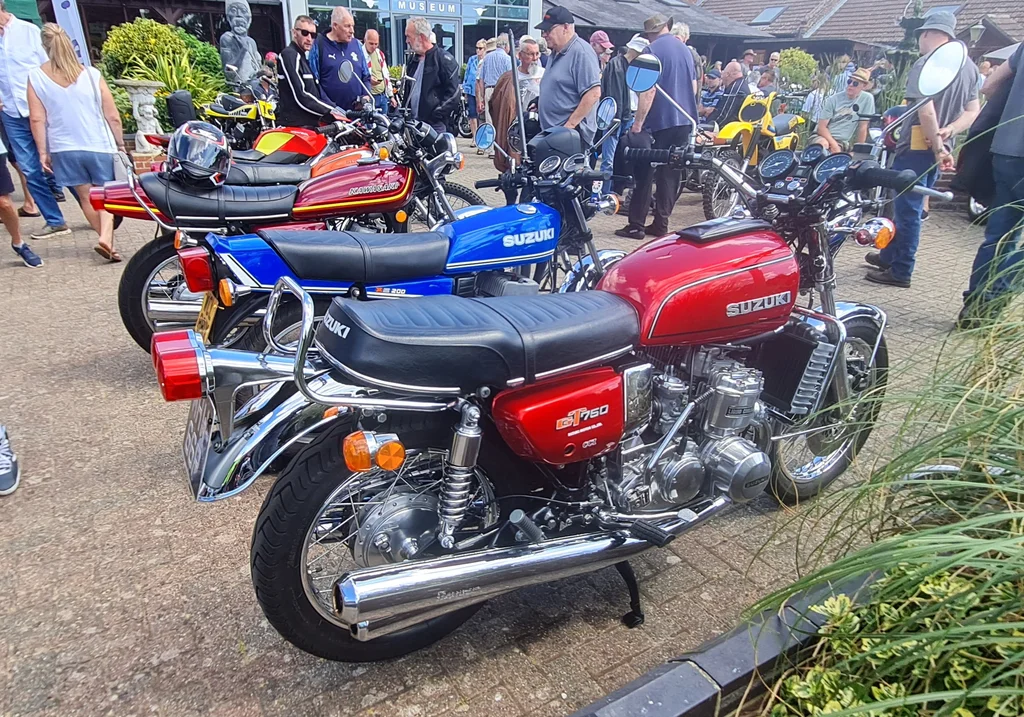

Today i rode to Mcdonalds for a breakfast muffin and some Sprite, after that i rode down to Sammy Millers for 2 stroke day.:) I had to put some air in the tyre this morning and it had lost 5psi, still not taken the whateverthefuckitis out yet going to do it tomorrow. Feeling knackered today for some reason and can't be arsed so it can wait. It was a massive turn out today at Sammy's so much so bikes had to park on his other field, in all the years i've been going i haven't ever seen it as packed.(y)
