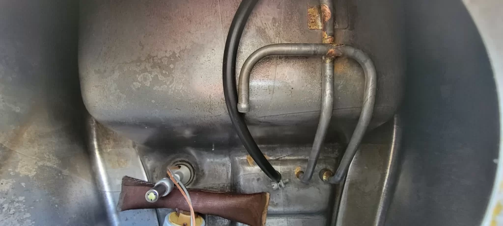

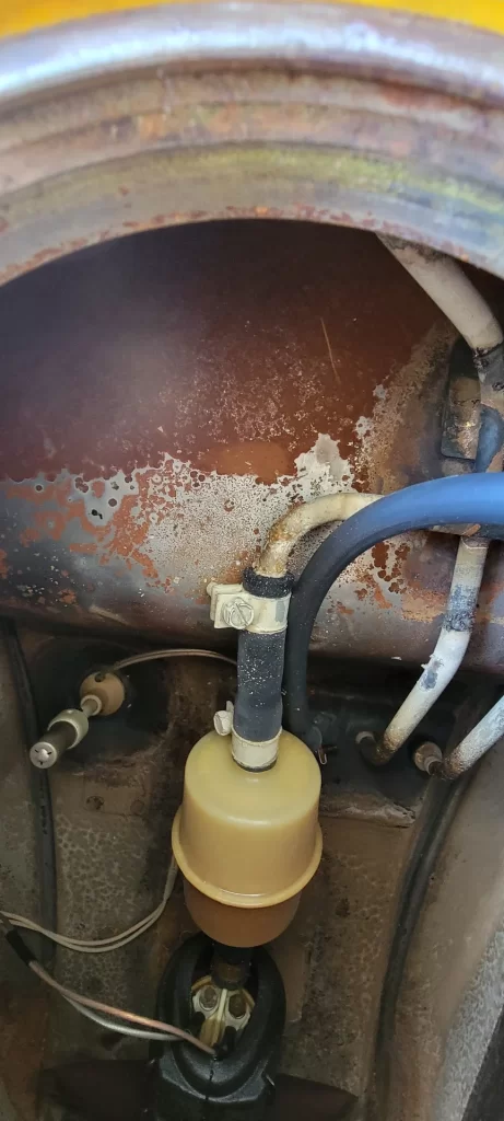

What did you soak it with
are you going to use a coating?
I used a product called EvapoRust. Its supposed to be water based and non-toxic. It took about 10 hours for it to remove the rust. I have thought about getting the tank coated but decided against it. I live in Southern California where it isnt damp at all. None of my other Ducatis with steel tanks have rust so I think I should be ok leaving the tank alone.

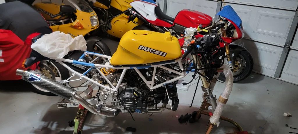

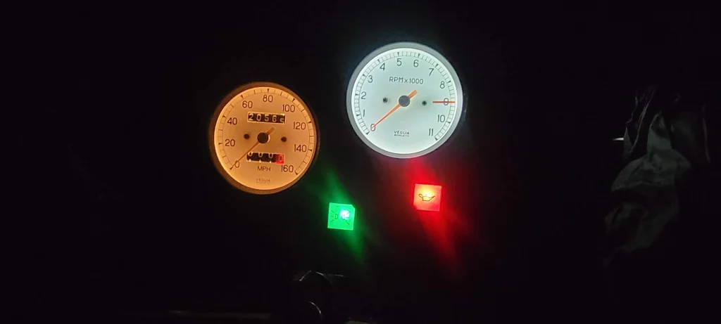

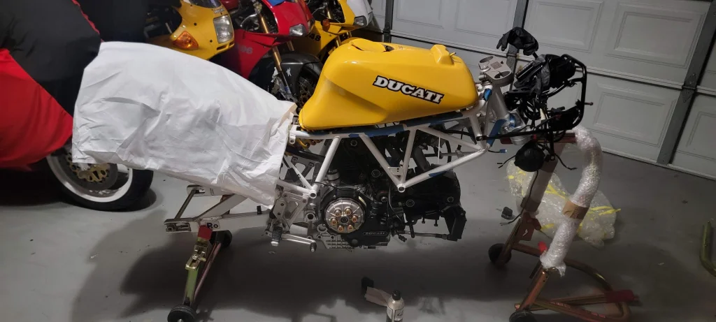

Happy New Year gang!!! Apologies for the long time away. You know the usual excuses...life, work, kids, health, money, etc, etc. so I wont bore you all with the details. The good news is that I am back restoring this bike with a vengeance, as much as my meager earnings will allow of course. So what has happened since January:
  • Got the bike back from the painter
  • Stripped the bike down to the bare frame
  • Replaced or replated every single nut, bolt, and washer
  • Recoated the Marvic magnesium hubs and restored the wheels
  • Rebuilt the carbs
  • Rebuilt the forks and replaced the progressive springs for Racetech straight rate springs
  • Replaced the fork outer tubes and bush with NOS ones I found in Italy
  • Bought Ohlins rear shock
  • Installed LEDs for the various idiot lights (I can actually see the Neutral light in daylight now!!)
  • Replaced front and rear brake caliper seals
  • Reassembled everything except the wheels
  • New steel braided brake and clutch lines from HEL
  • Fired her up! She actually started on the first try and now idles very nicely
Whats left:
  • Install wheels and tires
  • Chain and sprocket
  • Voltage regulator
  • Stainless steel rotors
But sadly since Xmas just passed I am low on funds again so I think I will be stuck here for a while. I will check back in another year folks. Just kidding. I should be able to road test this baby in about a month
