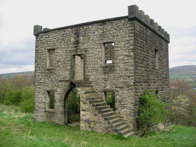

TIL the origin of the saying "on tenterhooks"
A Tenter Tower
By the mid-18th century, the phrase on tenterhooks came to mean being in a state of tension, uneasiness, anxiety, or suspense, i.e., figuratively stretched like the cloth on the tenter.
Cloth being stretched on a wooden tenter with the tenterhooks visible. An undyed cloth suspended on a wooden frame by small hooks.
This listed structure, known as a Tentering or Drying Tower, was once used to stretch cloth on wooden frames—called tenters—to ensure it kept its shape while drying.
The tower was part of a mill complex located further down the hill in Stubbins, built in 1877 by the Porritt family, prominent figures in the local textile industry.
In the days of its operation, freshly woven cloth would be carried up from the valley mills to this elevated position, where the passing wind helped speed the drying process as it flowed through the open tower. Stubbins, Lancashire, England
