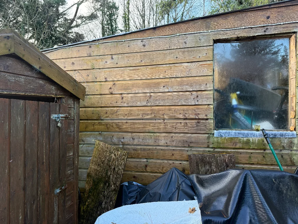

So here are the steps rising up the back yard area.
And here’s the side of the workshop shed.
If the line of the steps were extended it would hit the workshop shed just to the right of the window. Therefore I can’t extend the workshop shed in full.
I plan to remove the shiplap cladding to the left of the window, there’s a stud obviously running down the side of that window, and the membrane wrapped OSB that’s underneath the cladding will be the wall to the office shed on that side. I’ll leave in place the battens the cladding is mounted on and use them to mount my internal ply boarding. My porch area for the all important rocking chair etc will extend out where the window is but be truncated so it doesn’t impinge upon the top of the steps. That way some natural light can still get into the workshop shed on that side (east facing).
I’ll lay some blocks, using mortar to make sure they’re level (plus I have a Parkside laser level I picked up in Lidl a couple of years back which I haven’t used yet), then I’ll cover the blocks with DPM sheet and cut 12mm WBP ply to size and screw it to the blocks with concrete screws.
I’ll then lay the joists, 400mm centres on the ply, screw them to the ply, then lay 18mm osb on the joists and screw that to the joists. (I’ll put carpet tiles or some sort of covering on the OSB once it’s finished.) Thats the floor (and one wall) sorted 👍.
Does that sound like a plan?

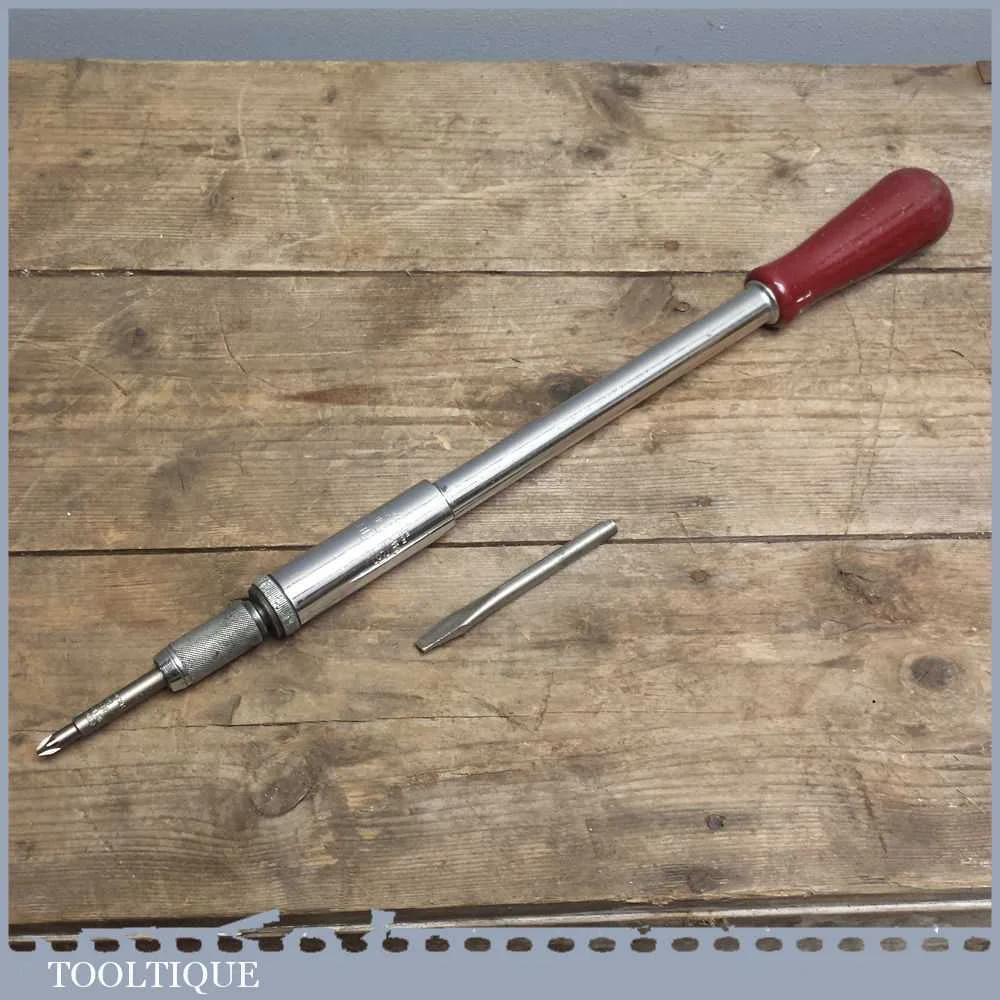

You shouldn't have time to put it down 👀. You're right though, cut roofs are usually nailed, but back in the '80's I watched a gang of chippies finish a cut roof on a new bungalow we'd come to tile, and they screwed it. Why I don't know - time maybe - but it stuck in my memory. I think they'd just fucked up their timing and had forgotten we were coming to roof the place that day (no mobile phnes then). They'd been fitting some Veluxes and there was loads of rafters and jack rafters still to fit. About four of them jumped on it and just whacked everyting in with their Stanleys. By the time they were clearing off the scaffold we were running our first row of felt.
But every job where you use a battery drill today was done with a pump action Stanley not so very long ago.
