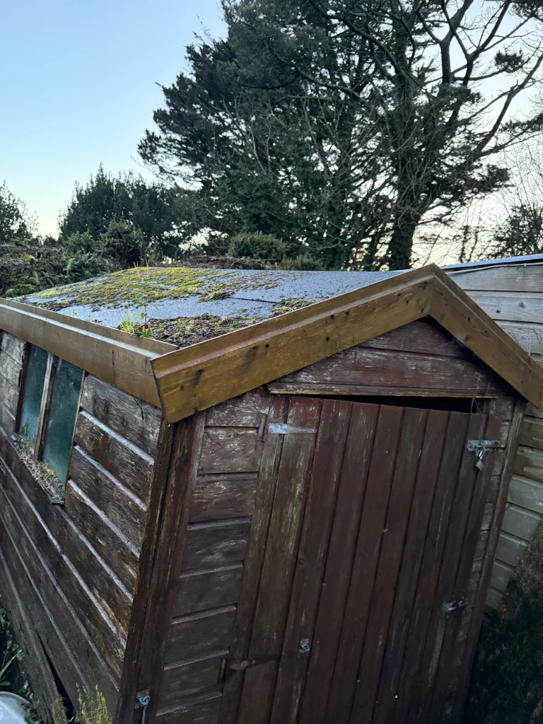

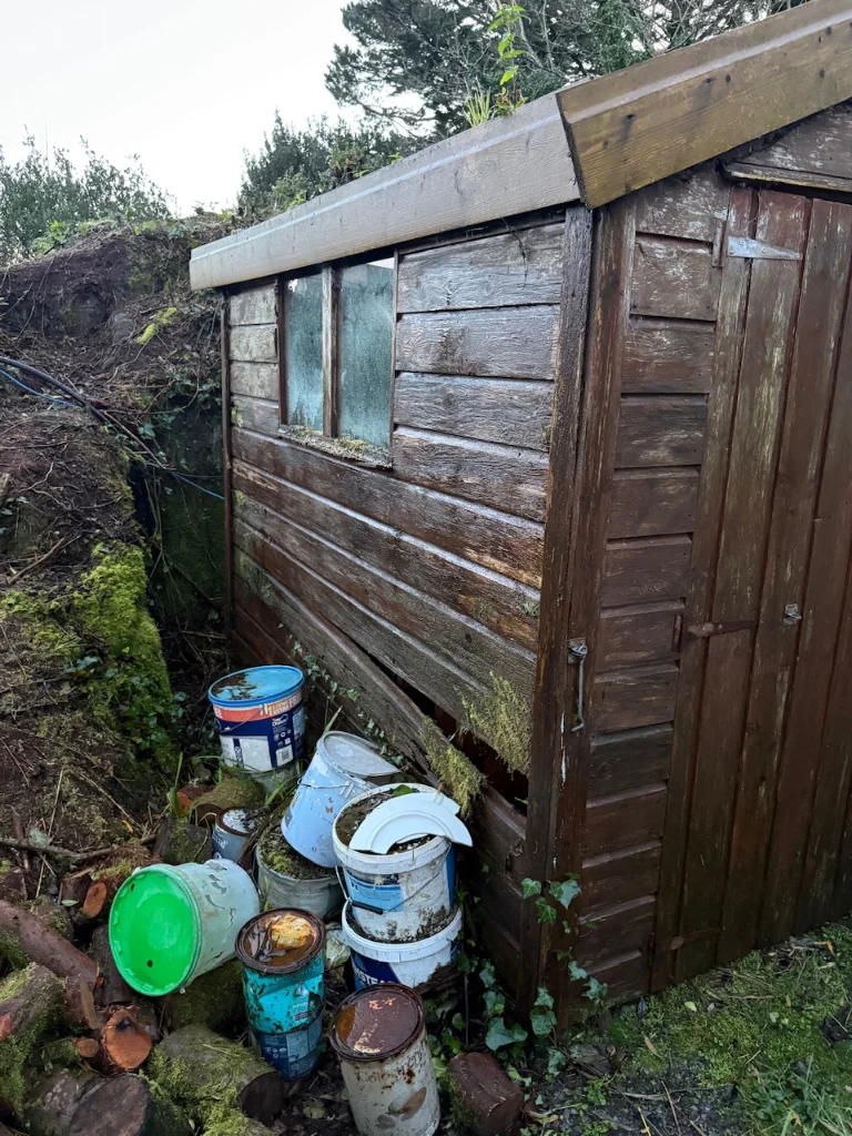

The shed in question is ‘The Shed’, the one with the famous roof. The roof is fine, a bit of tree detritus on it but otherwise it’s in fine shape, hasn’t let a drop of water in. The problem is the sides of the shed are rotting away.

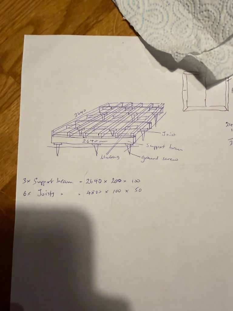

The first thing, once the current shed is removed, is to frame the floor. I don’t really want to pour a concrete slab as I’ve got enough issues with water run off that area since the slab for the workshop shed was laid. Thus, I’m thinking of using screw piles. I’m going into rock once I get a couple of inches down so recognise I’ll have to drill a hole for each pile. I just think it will be easier and cheaper than laying a slab apart from the water diversion issues.
Measurements are approximate at this stage on this sketch but I think this is what I need to do.
I’ve checked span tables but am a little confused by them as they may seem to go up to 125kg/sq.mtr (1.25kN/M2). The confusion lies in whether that’s the dead load on the floor placed on the joists, which seems ridiculously low, or the dead load on the top surface area of the joist itself. I’m guessing the latter but would rather not guess.
Once the floor frame is down how do I insulate between the joists and what thickness insulation? Would 75mm suffice in the floor? What do I use to suspend and hold the insulation ?

Need more info.. as in what height will the ffl be off the existing ground roughly? This may or may not play a part in how you go about your build
For the floor you definitely need 18mm on the top but I used WBP ply for mine. Much nicer finish than OSB for a floor.

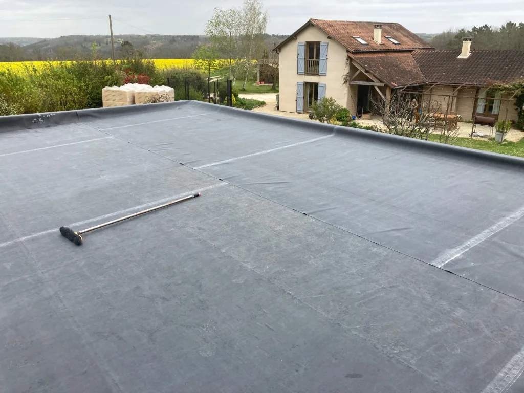

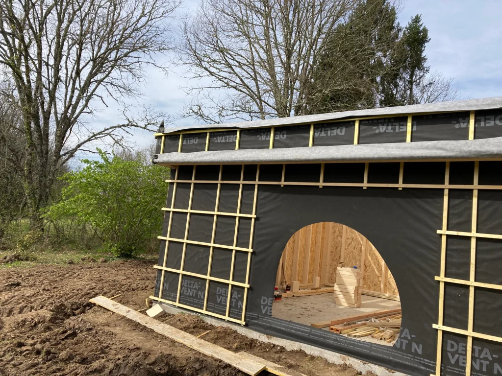

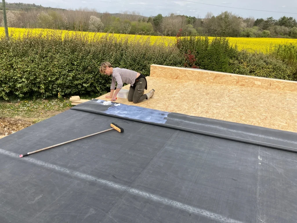

I did this one in France a couple of years ago with the help of my OH and my mates mum. My mate was supposed to help but he put his back out the day before when we were screwing the roof boards on.
It was my last day over there so I had to get it finished and did it in one day.
Thank you, and some good ideas.
If I understand correctly I use the concrete blocks as the foundations? But how do I fix the joists to the blocks? The same way I put my sill plate or whatever it’s called onto the concrete slab for the workshop shed, ie with those hammer in frame fixing thingies? That’s fine for the slab as it weighs XXXX tonnes but how would I anchor the concrete blocks to the ground? Mind you the current shed hasn’t blown away and it’s just sitting on paving slabs.
Get yourself concrete screws for the timber to concrete work they are far superior than express nails and you can unscrew them if you want to adjust your plans

Though seriously, @Chizel - Founding Father the floor will be the height of the concrete blocks (whatever they are), plus 12mm (marine or WBP ply) plus 100mm (4x2 joists) plus 18mm (final floor boarding - haven’t decided what type yet).

Plus I have to be realistic, it’s just me, there’s no young muscle to assist in the heavy lifting. I can lift an 8x4 piece of osb or ply but I won’t be able to lift, manoeuvre, support and fix 2 bits of osb with insulation sandwiched in between and a frame running round the edge of 5x2, it will just be too heavy.
I like the idea of the sleepers but think I’ll use concrete blocks as I worked with railway sleepers once before and they’re buggers to cut through unless I get the chainsaw on them.
I like the ideas suggested of making up the floor pan and laying it down on the sleepers/blocks but again weight is a consideration so I think I’ll lay out the blocks (or sleepers), cut some 18mm OSB sheets to size, lay a DP membrane over the blocks/sleepers, lay the OSB sheets down, fix some 4x2 framing/joists on top of the base sheets, fill the voids with insulation panels, then lay more OSB on top and that’s the floor done.
Now, 600mm or 400mm centres for the joists? 400 I guess.
Also 18mm or 12mm OSB?
Also, I guess I’ll have to get a mini digger in to scrape off the top 2 inches and get down to rock.
What’s the best way to level the concrete blocks or sleepers? Do I need to get a mixer and make up some concrete to pad out under the blocks?
