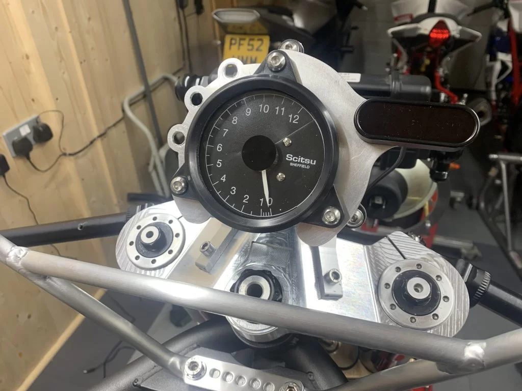

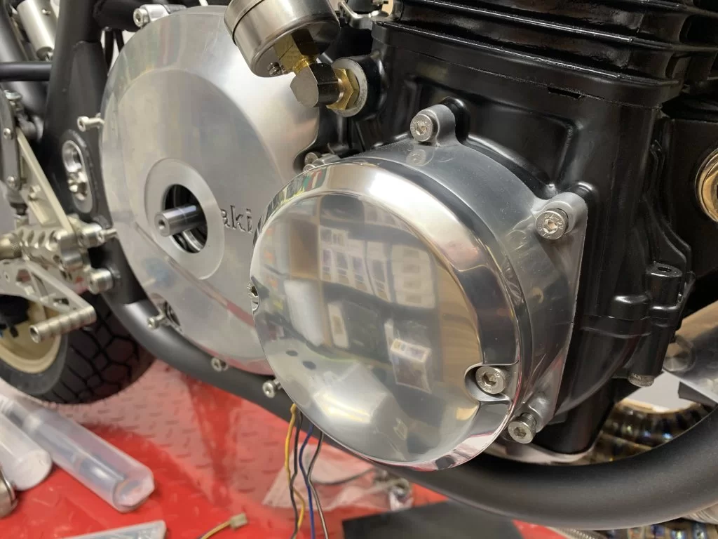

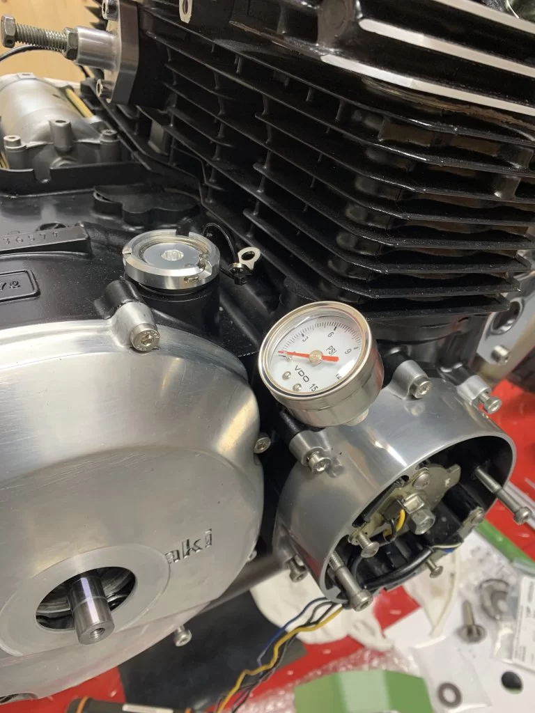

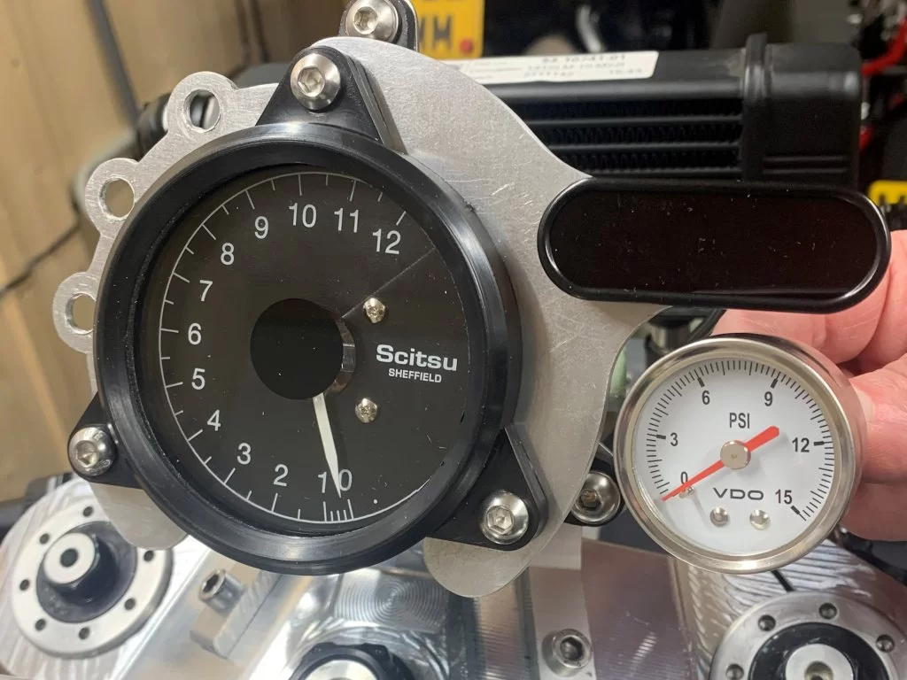

Dash.My Oil Pressure Gauge came from Germany, via the USA - now I need to decide whether to mount it here where the Y'mericans do, or mount it up on the dash
That’s just added a few more weeks to the buildDash.![]()
Lazy Guinness!!That’s just added a few more weeks to the build![]()

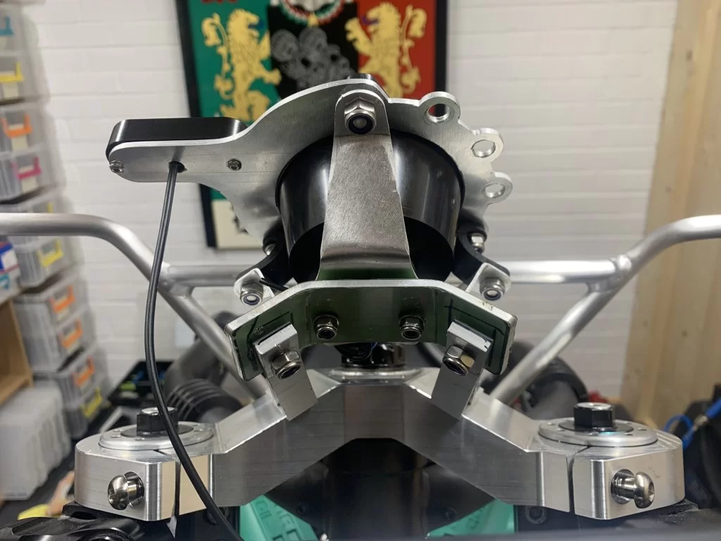

It wasn’t - it’s just a nice to have though as I’m unsure the oil level sensor these engines used works yet and they haven’t been available for more than 10 years… I was thinking of just fitting it low down for the initial start up, then removing, but it might look good on the dash permanentWhere was it on the original that you are replicating?
True - it doesn't look so large in real life btw: the face is 70mm dia.Being the rev counter is so large and black, it draws the eye in a way that the oil gauge doesn't, so doesn't look out of place

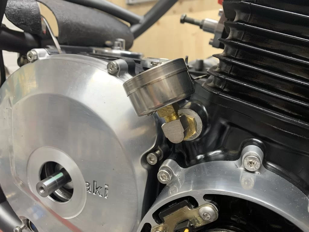

Just looking at the oil pressure gauge scale, is it a bit high for your engine ? Only asking as I'm sure my Z900 engine has a very low oil pressure due to the crankshaft roller bearings. Is your's the same ?Still lots of fettling / tidying and then final polishing but I threw it together today to get an idea of the final assembly. Not quite happy with the overall profile yet so more changes to come...
Not sure about the gauge yet - it looks passable here, although I'm thinking I might just use it as a set up tool. I may also mount it further back nearer the oil cooler so it's more obscure if I leave it on permanently
It is low pressure, 15psi gauge not 15 barJust looking at the oil pressure gauge scale, is it a bit high for your engine ? Only asking as I'm sure my Z900 engine has a very low oil pressure due to the crankshaft roller bearings. Is your's the same ?

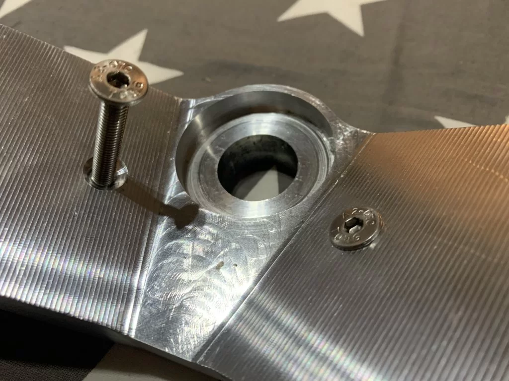

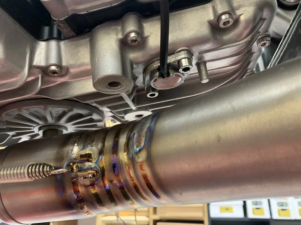

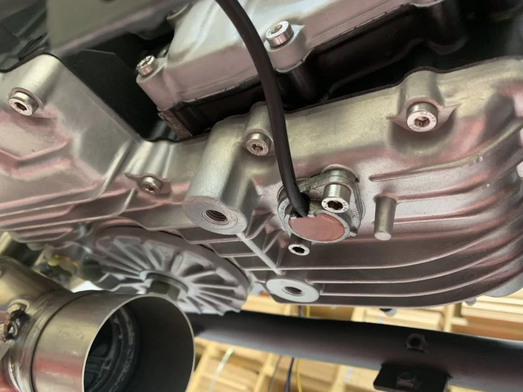

Ocd is kicking in that needs shallow head hex boltsWhipped the rear section of the Exhaust off today to fit the Oil Level Sensor which has been thoroughly cleaned out and tested... then re fitted the Exhaust
