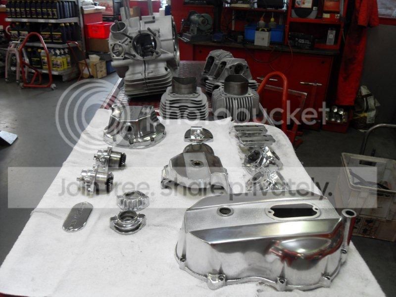

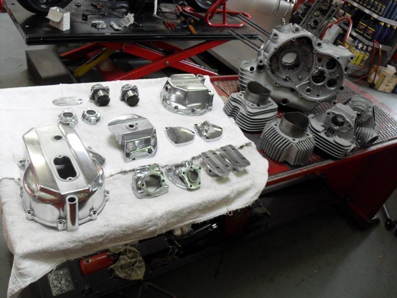

Jan Biggelaar has received the engine parts back from the vapour blaster and polisher, engine building starts this week. It is going to be one handsome GTS engine...

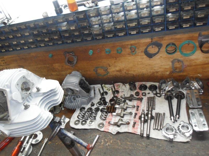

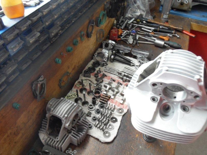

One of the heads awaiting rebuild...

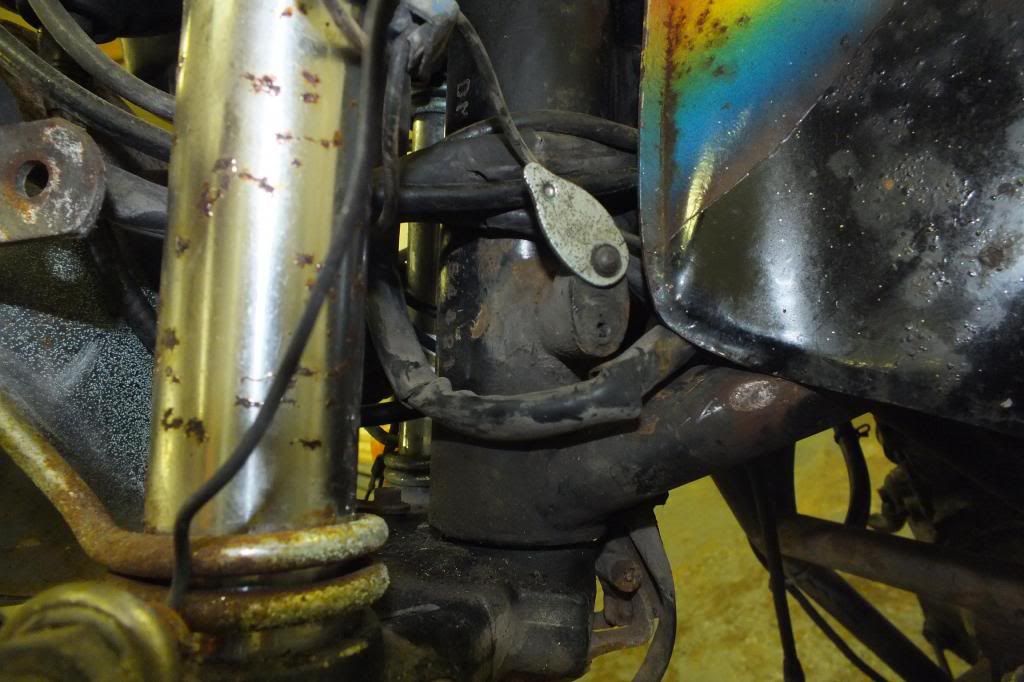

I have already fitted the steering head bearing to the lower fork yoke, so now all I need are the swinging arm mount ally converters to allow me to mount my Metmachex swinging arm and I can build the rolling chassis!

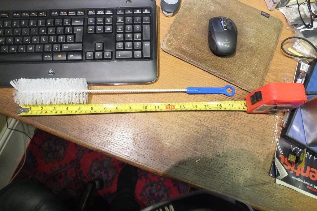

I found it at The Brew Shop and now I can scrub out the inside of my fork stanchions and build the front forks!
I got rather distracted whilst I was there and the best bit is I can clean off the brush and use it to clean things for my Christmas brew of Festival Old Suffolk Strong Ale. Might as well make the most of it.

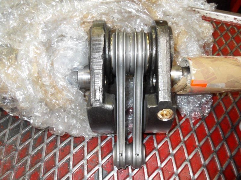

The bottom end, those are Godden Engineering's own con rods. Beautiful.

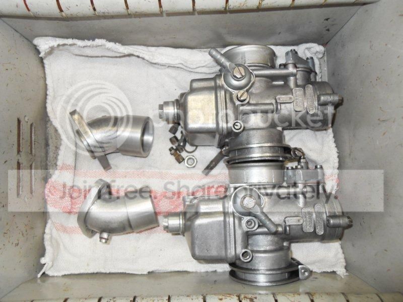

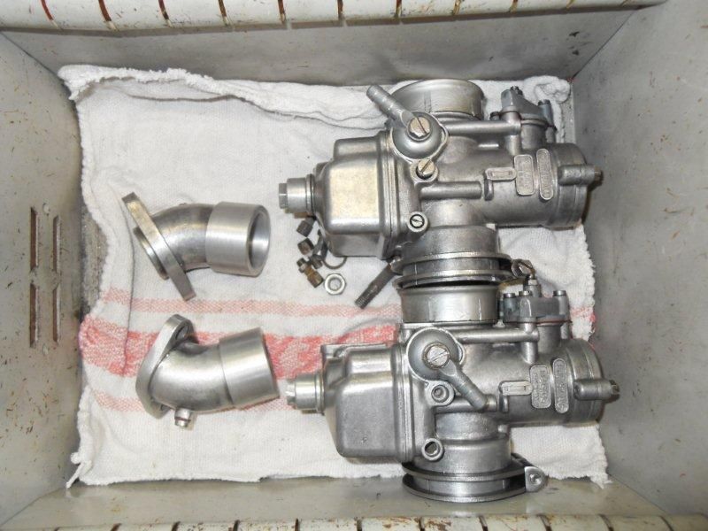

Refurbished 32mm carbs...
All polishing & cleaning done...

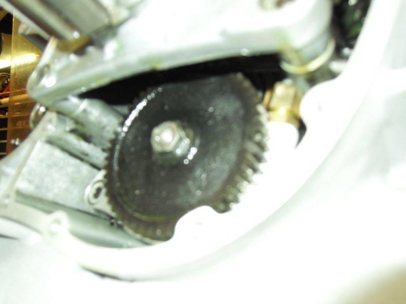

Blurry picture of inside the alternator cover showing the oil pump installed. If you look, you can just make out the full flow oil modification installation.

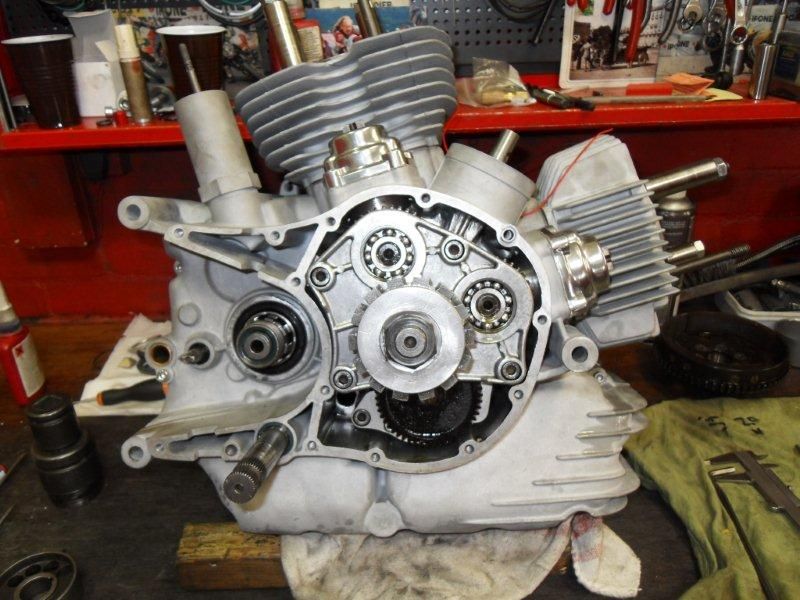

Crank in...
Lower bevels & blocks being fitted. Those are Wiseco 88mm high compression pistons, giving the bike a capacity of 905cc; Cams are standard and there has been no gas flowing or fiddling otherwise. Carbs will need rejetting. I am hoping this bike will be more of the same, a GTS engine with more bite but with the same (charming IMHO) characteristics...
Lower bevels & blocks done.

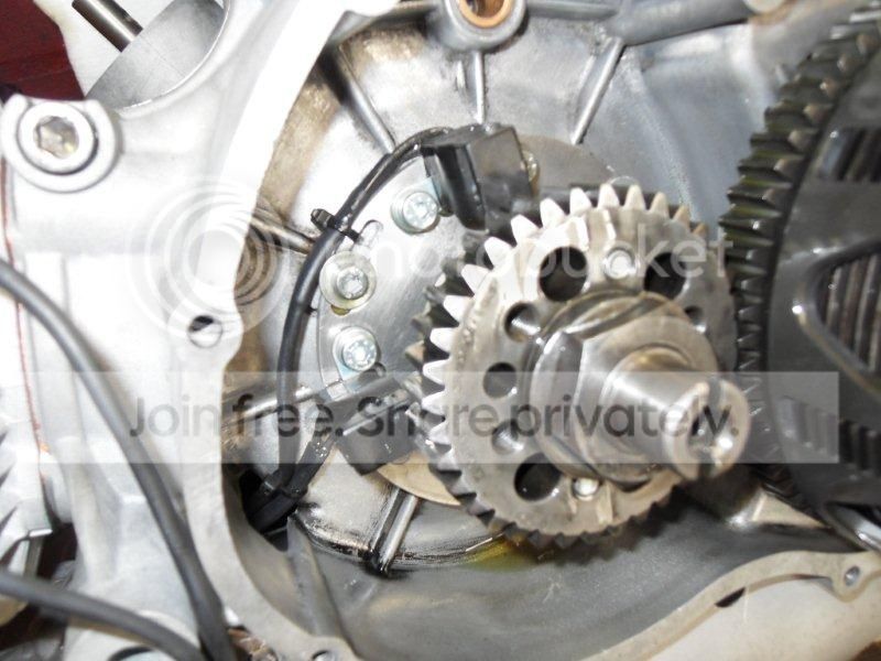

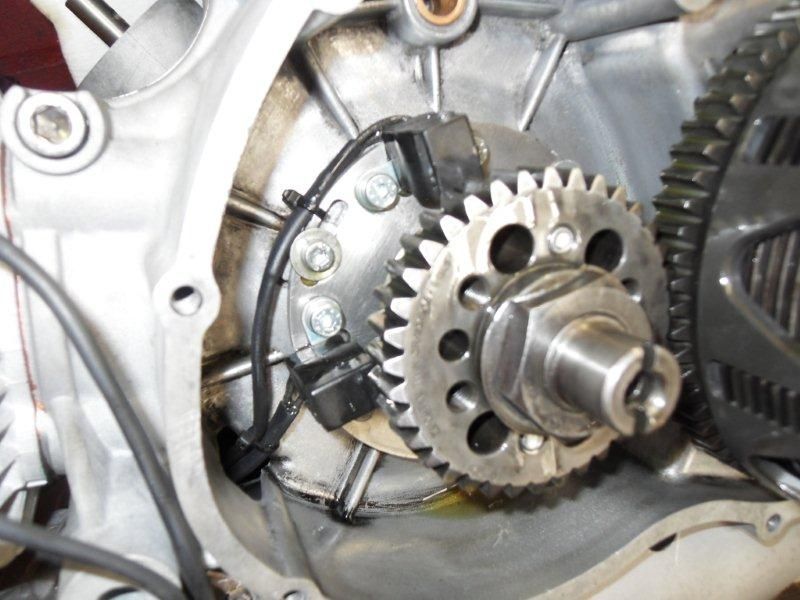

Yummy Nova Engineering straight cut primary drive gear set installed, underneath the gear is the Silent Hektik electronic ignition installed.
Clutch installed...

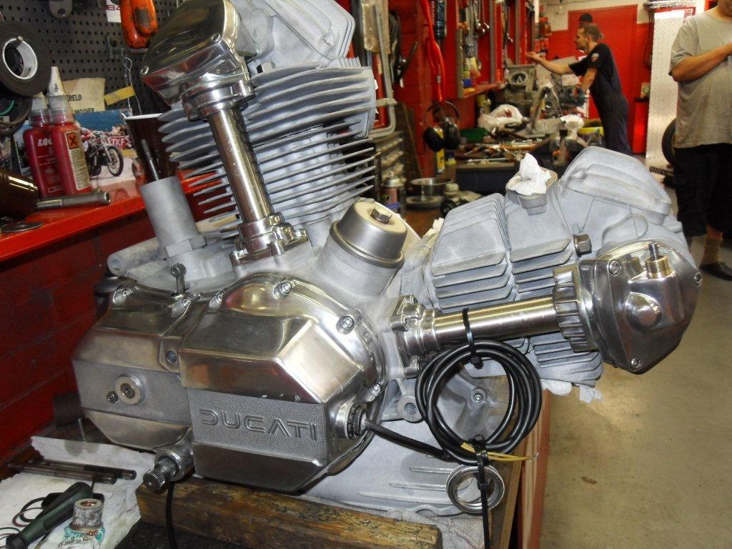

Engine complete, left side...
Engine complete, right side...

- Carb cleaning / refurb. I'm yet to do this. I'd like someone to ultrasonic clean and replace all the seals and gaskets. Who did yours?
Jan Biggelaar - I sent the carbs off with the engine. Jan did a great job but it was poor use of a masters time ;-) Knowing what I know now, to save money I would strip & clean them myself and have them vapour blasted by someone who has some mechanical sympathy. Some of them blast every square millimetre even when you ask them not to; I'll post an example elsewhere which trashed a set of lower bevels.
I do have some links to carb cleaners and I'll look them up - when I have fed the clamouring family their Shepherds pie. Done. Links are:-
I don't know *any* of them but was thinking along similar lines re: my 40mm carbs, hence the research. Comments/endorsements welcome.

I'm sure I'll need to put in a new ignition system. I see you have the Silent Hektik system. Is this also suitable for electric start engines? I see you dispensed with the starter ring so I guess it may be a different system?
That is just me - I changed the primary drive gears; As far as I know Silent Hektic will fit and work fine with an electric start engine. I can't yet vouch for it as I haven't yet run the bike, but I am looking forward to it.
