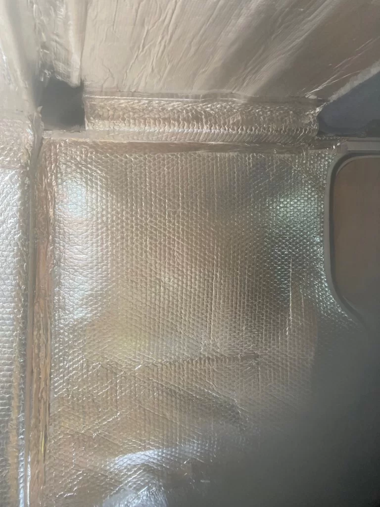

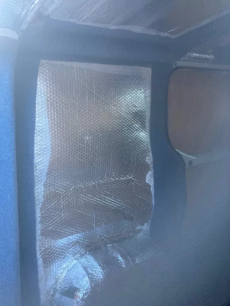

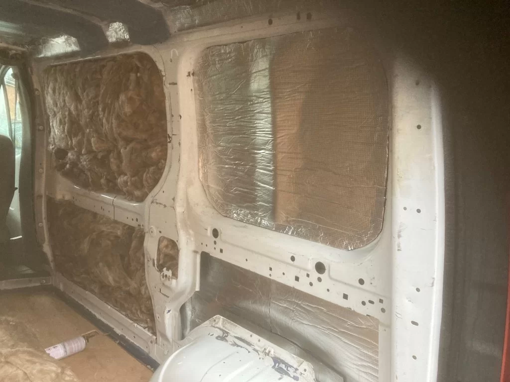

My brother ripped all his mineral wool insulation out as it traps damp air.
Loads of posts / threads about it on the campervan websites.

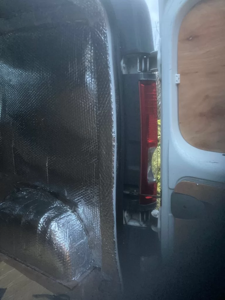

Yes I had a good read up on it. The insulation has to be mould resistant and natural fibre and the cavity has to be fully sealed and air tight to stop condensation hence the silver insulation to seal it.
It is a trial van that I won’t be keeping too long so if it’s a problem I’ll do it differently on the next one.

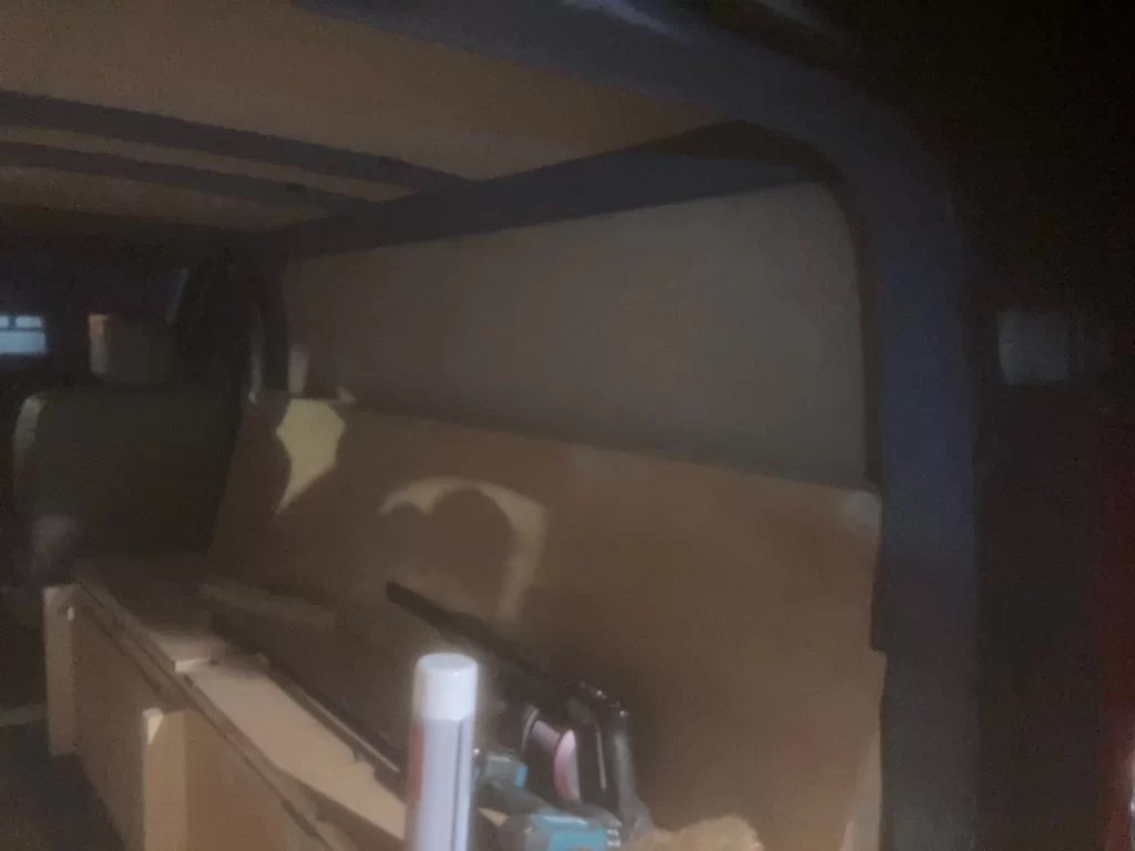

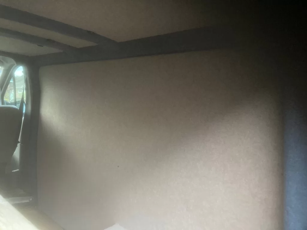

First panel fitted. I will be trimming the box section with angle beads.

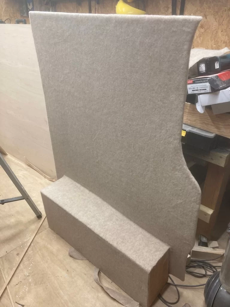

How do you make the templates for the panels you have to cut? I’ve never done this (but that’s never stopped me before 🤣) and my van could do with being panelled.
Also how do you fix the panels to the van ? Tek screws?
I cut the main shape square then use paper or cardboard templates for the shaping. Yes Tek screws or self tapping screws in this case.

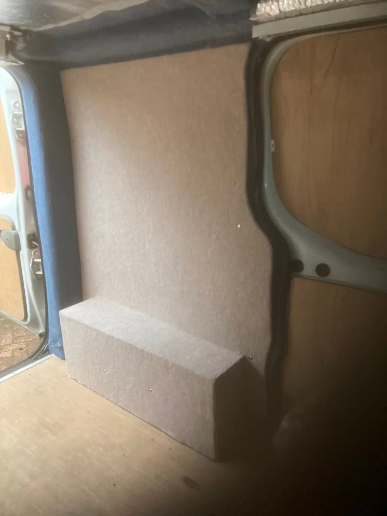

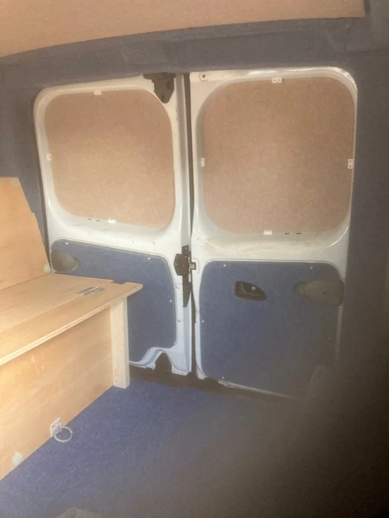

Finished some of the trimming today.

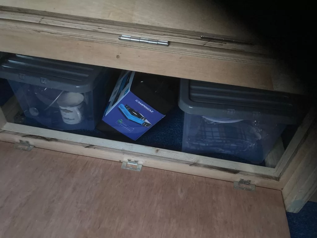

Bought some boxes for the cooking stuff, pots, plates etc.
Tomorrow I'm going to have a go at cutting the bulkhead down and carpeting it. I might go to the upholsterers if I get time to get a price on the bed/seat cushions.
I need to finish the bed/seat but the weathers not been fit as I need to paint it outside. I also need to fit the side window but will probably wait for warmer weather for the adhesive.
