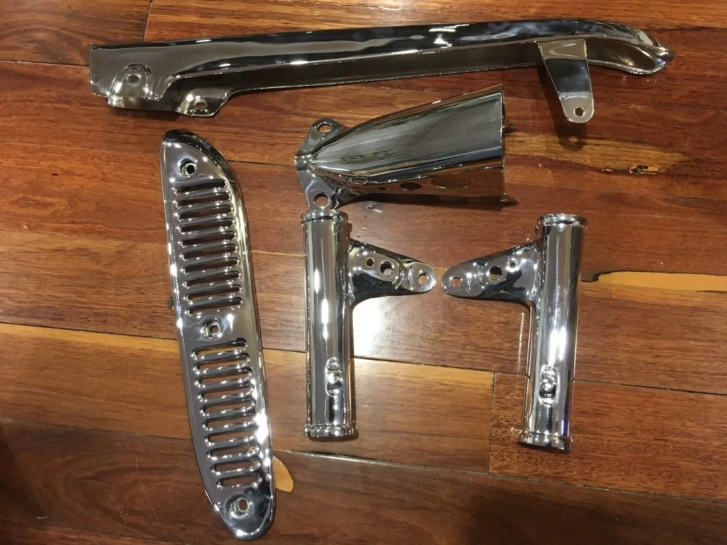

I had to google that, and no, I am going to use a spray clear that I think is up to the job. Will let you know how good it is in 1-40yrs. YMMV!Do you finish of the forks once sealed, with 3m helitape?
You can get DTM (Direct To Metal) lacquer developed for alloy wheels on cars which is probably what you have? It's OK if your finish isn't mirror polished and just Scotchbrighted but still lifts if chipped. I was doing my Swing Arm in it but I'm now going for clear Cerekote I thinkI had to google that, and no, I am going to use a spray clear that I think is up to the job. Will let you know how good it is in 1-40yrs. YMMV!

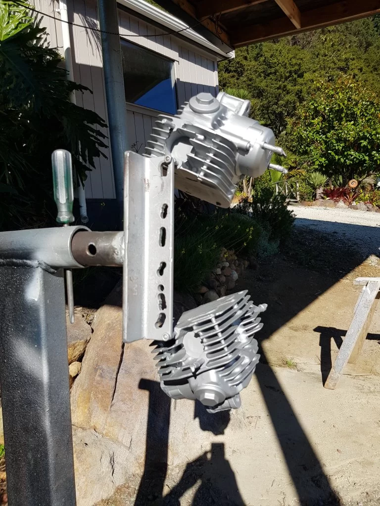

Did you sandblast them yourself or get them done elsewhere?Sandblasted engine casings today except for barrels. Just need to deep clean now and I can rebuild the bottom ends.View attachment 30263
I did them myself, only took about an hour but fiddly as you can imagine. Am going to hit the inside with some oven cleaner then a thorough wash out and immediately reassemble the bottom ends.Did you sandblast them yourself or get them done elsewhere?

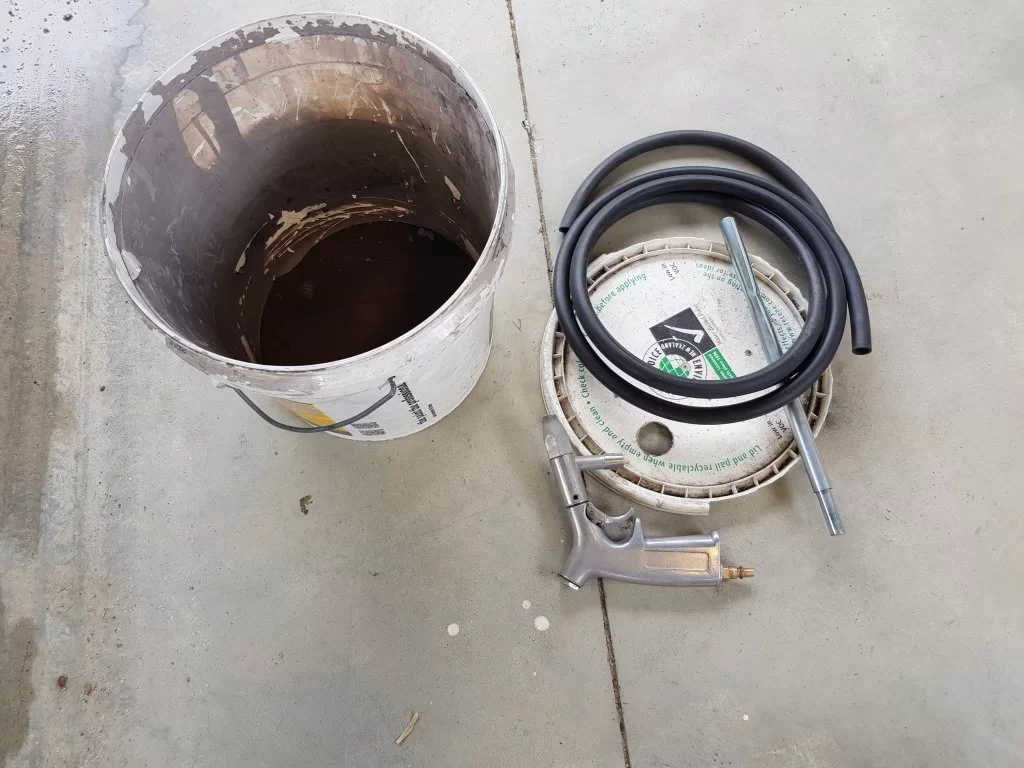

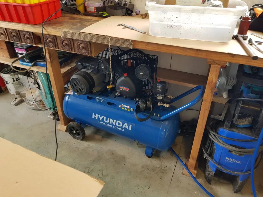

And I have a cheap and cheerful, but effective, total loss setup which is basically a handpiece with a drawhose. Obvs this is messy but outside on our gravel driveway is perfect. Practice makes perfect and although I didn't, it would pay dividends to youtube the hell out of it. Also pays to have a good water trap for the compressor which falls into the category of, the bigger the better! Mine is mid size I guess?View attachment 30377View attachment 30378View attachment 30379
Correct, the venturi effect. So there are many variables involved. It is just practice to set it up right, or so it at least works!Am I right in thinking then the difference in pressure between the glass beads and air in the bucket and the fast moving air from the compressor as it exits the gun, causes the beads to be drawn up the black tubing above and then ejected with the air?

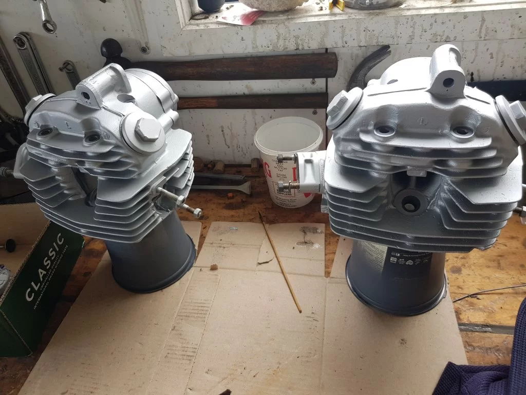

Is that poor mans hammerite smooth silver?Aand, top coat...View attachment 30664
Lucky for me I remembered what you said and attacked the bottom before giving up!Is that poor mans hammerite smooth silver?
Looking brand new again !Aand, top coat...View attachment 30664

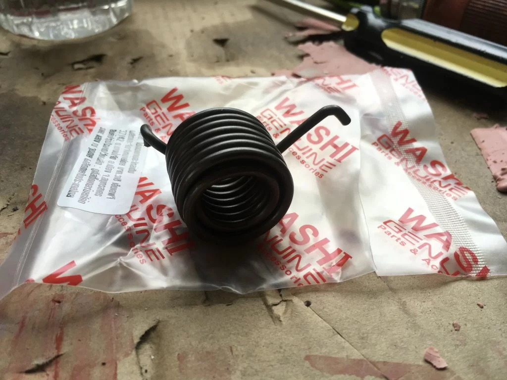

Not bad for a 50yr old motor that was covered in corrosion when I got it and I had it out in the weather since then about 10yr ago! Inside, the bottom end was in really good nick, just a busted kick start return spring.Looking brand new again !![]()

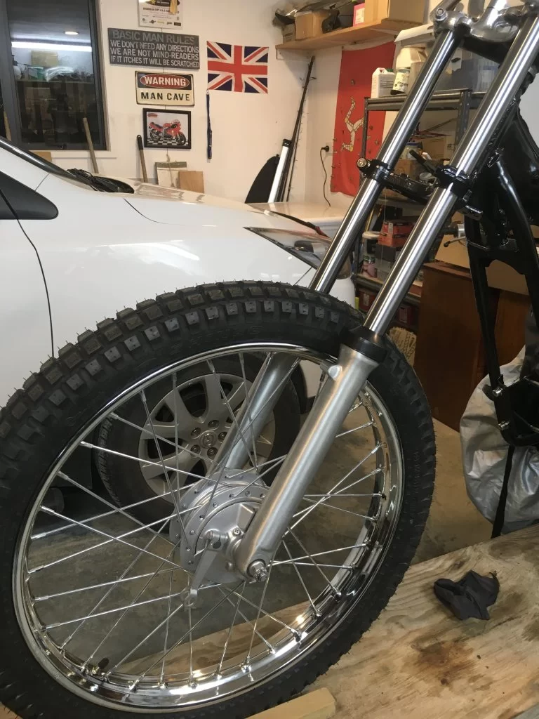

Are you sure those forks can handle ... errr .. a big lad...?Aaaaand voom! Not here to fuck spiders! (I have no idea why us tradesmen say that?)View attachment 31205
Great job dude!!
