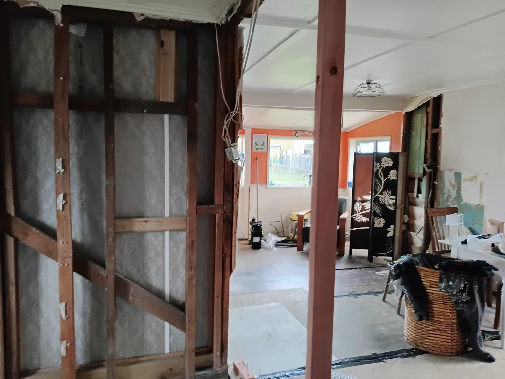

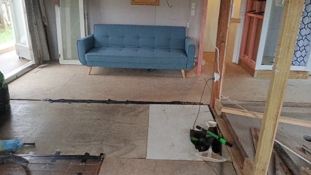

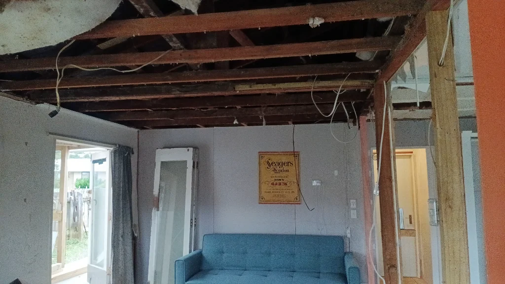

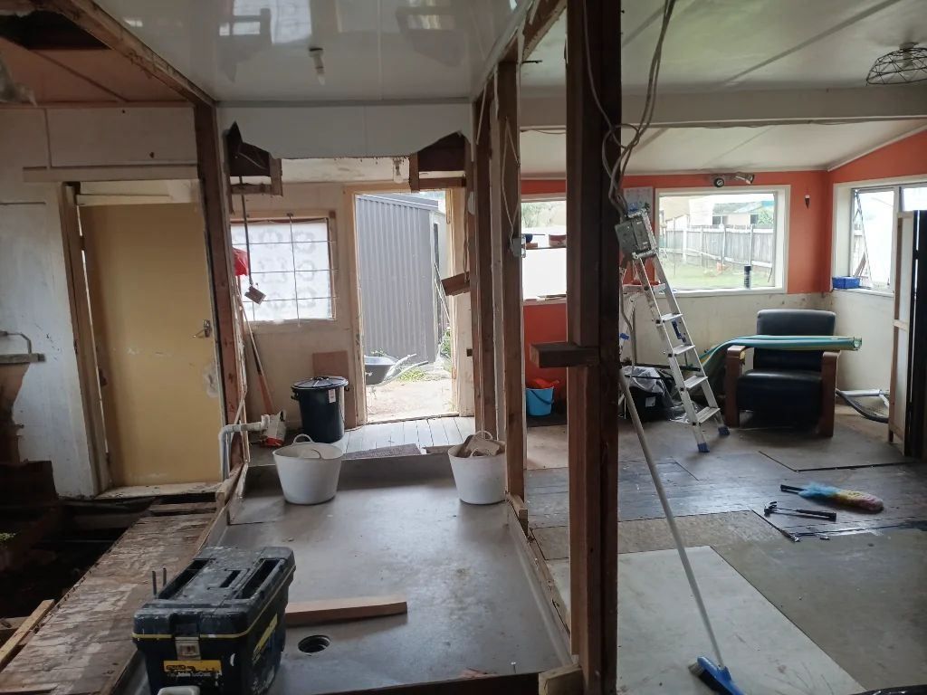

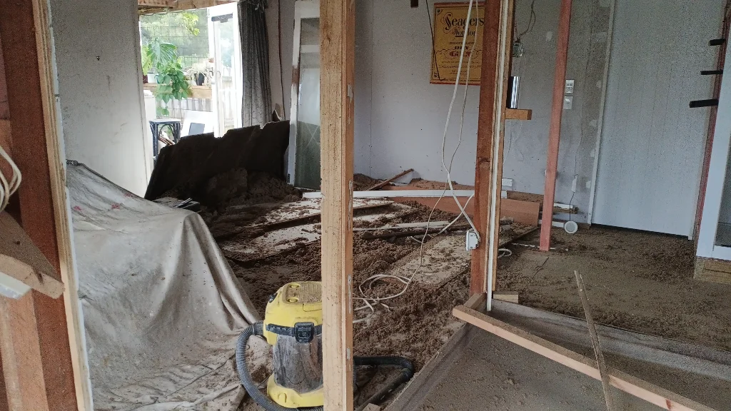

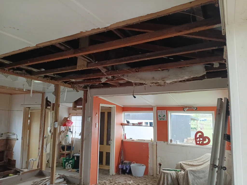

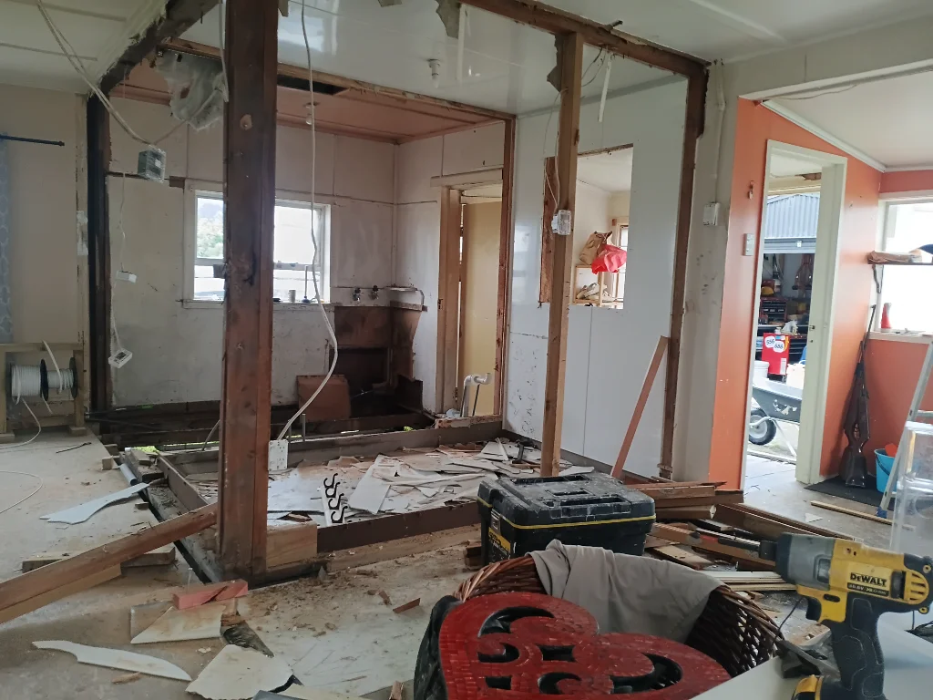

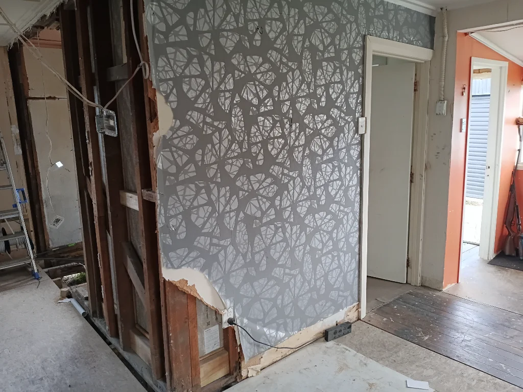

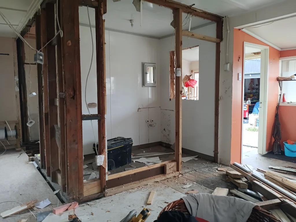

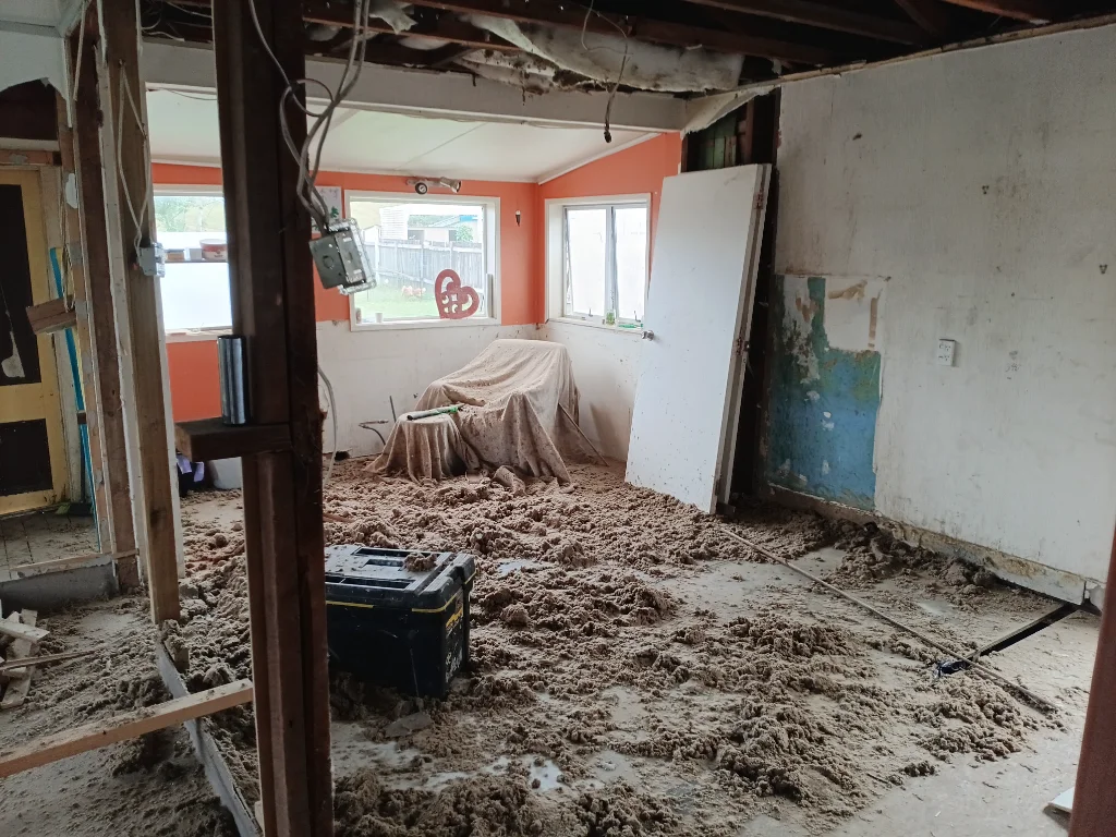

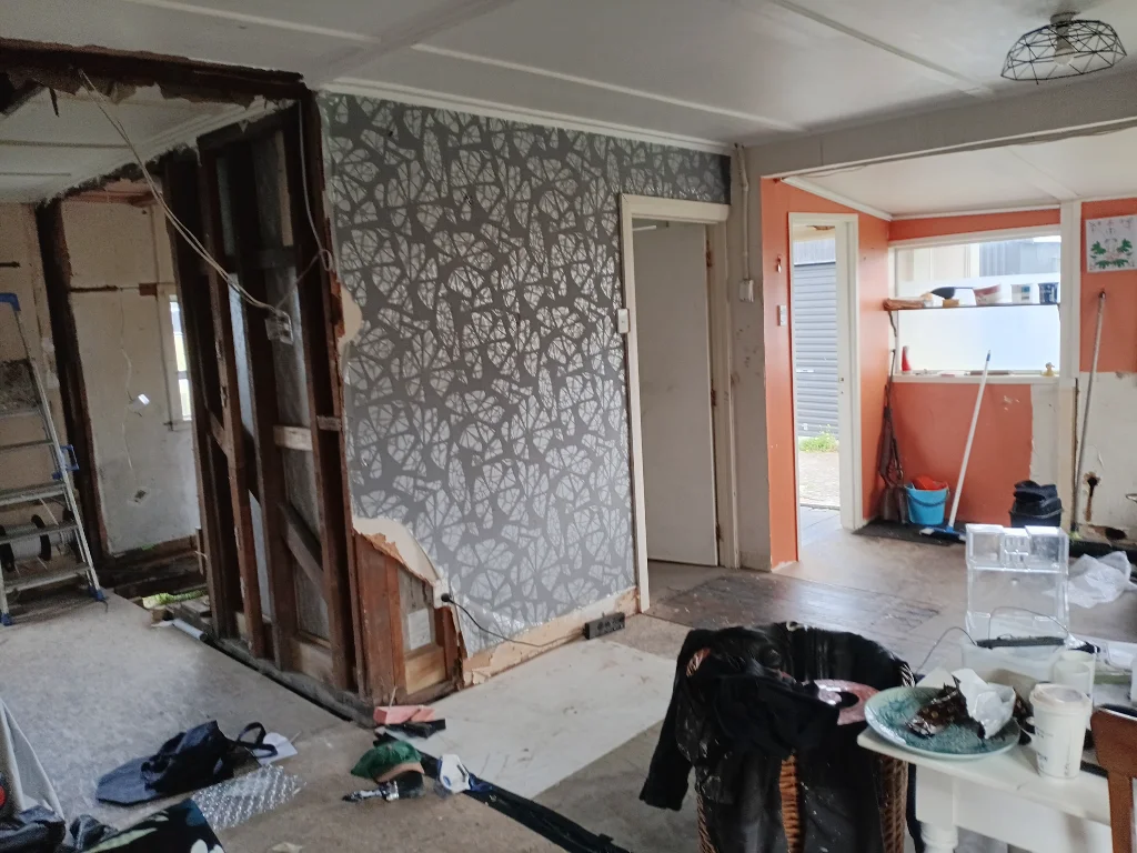

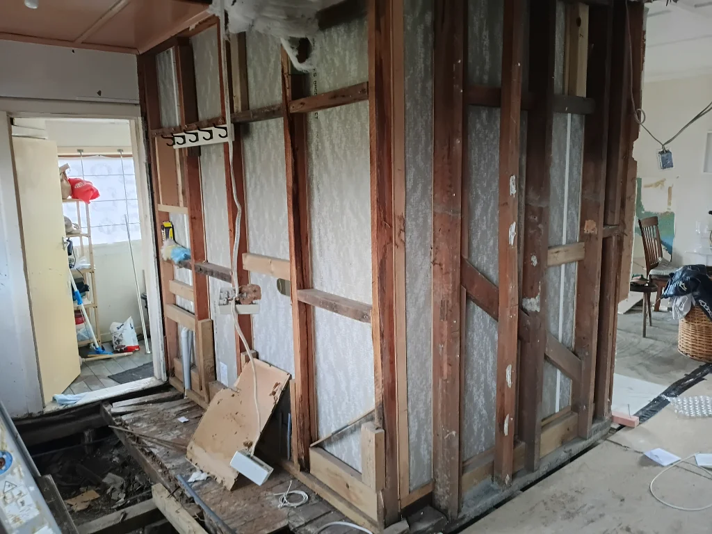

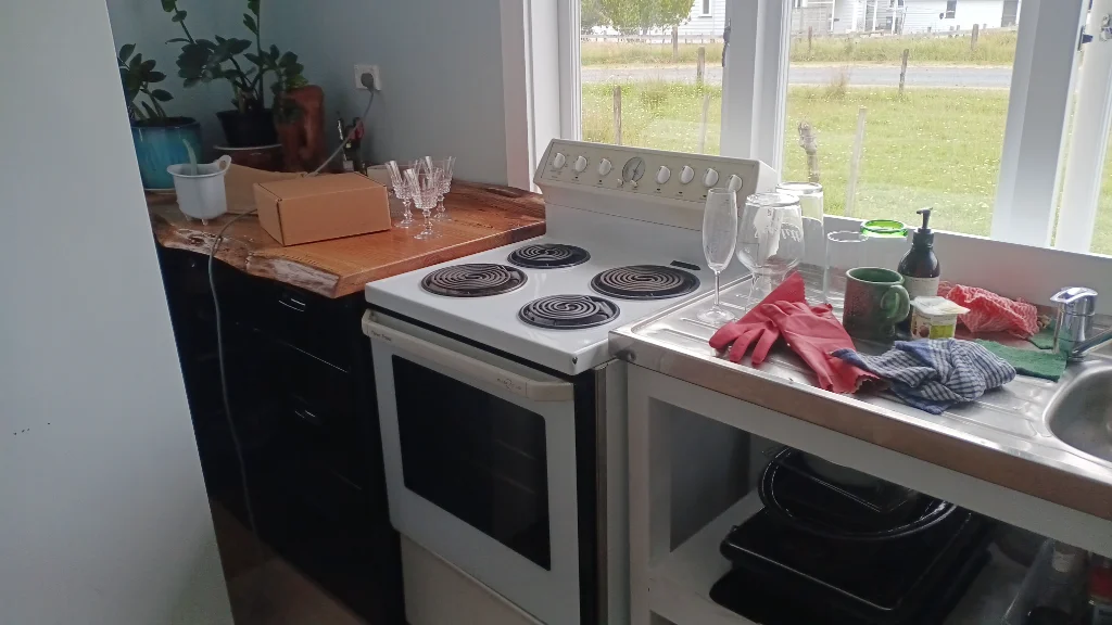

Managed a few hours work at home yesterday, finally got the stove wired in in it's new home, just need to get the fridge out on to the deck now so we can use the kitchen.

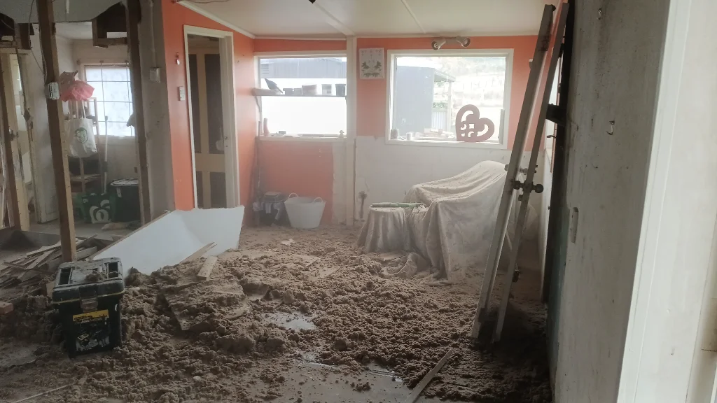

Today, although I feel absolutely shit, i can't just lay in bed so im gunna try and tackle some demolition.
Gunna smash out the old bathroom. Been really looking forward to this!!!!
It's sorta in the middle of the living space so removing it will create one big space and give an idea of what we really have to work with..

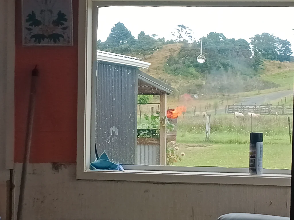

5.45 and ive just finished for the day.. almost.. dropped b at the bub 20 mins ago, prepped dinner and have a few more wheel barrow loads of timber to burn.
I've had the fire going for six hours solid! Amazing how much timber is in a small area..

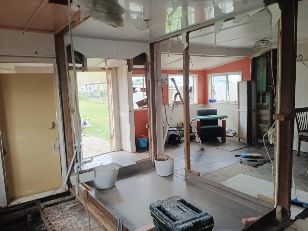

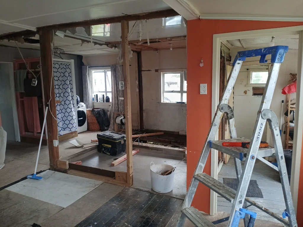

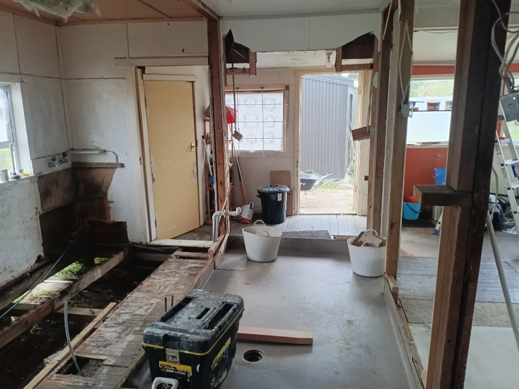

Anyhu it's largely opened up.
We have 43m2 in this area now minus 2.4 x 3.2 for the bathroom leaves 35 ish for kitchen/dinner and living room. Pretty good i think..

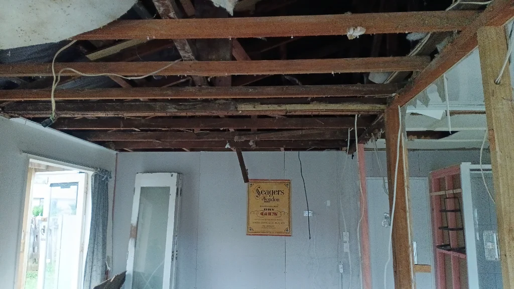

View attachment 154107View attachment 154108View attachment 154109View attachment 154110View attachment 154111
Big space to work with Chiz, so load bearing walls ?
What are they? Lol.. yea, there was a spine wall mid span running the length of the house. I've removed a section of that and will be installing a beam in its place. The beam is only spanning 3.3 mtrs and carrys nothing other than the ceiling joists/weight of the plasterboard and the roof ridge was propped off or it. It's a lightweight iron roof coming in at around 5kg per m2 plus rafters ect . No snow load here as it doesn't.. gunna put in a double 8x2
This is also why there are a few sticks of timber remaining mid span. Im gunna drop the ceilings and put ties between the rafters before I remove those! Honestly though, it's such a small structure/roof i can't see it going anywhere. I've built roofs with a larger span in the uk that were slate tiled and had no ceiling ties or propped ridge, the only detail was brackets from rafters to ridge.. I didn't like it but it passed muster ...
