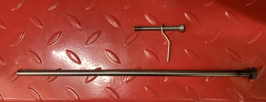

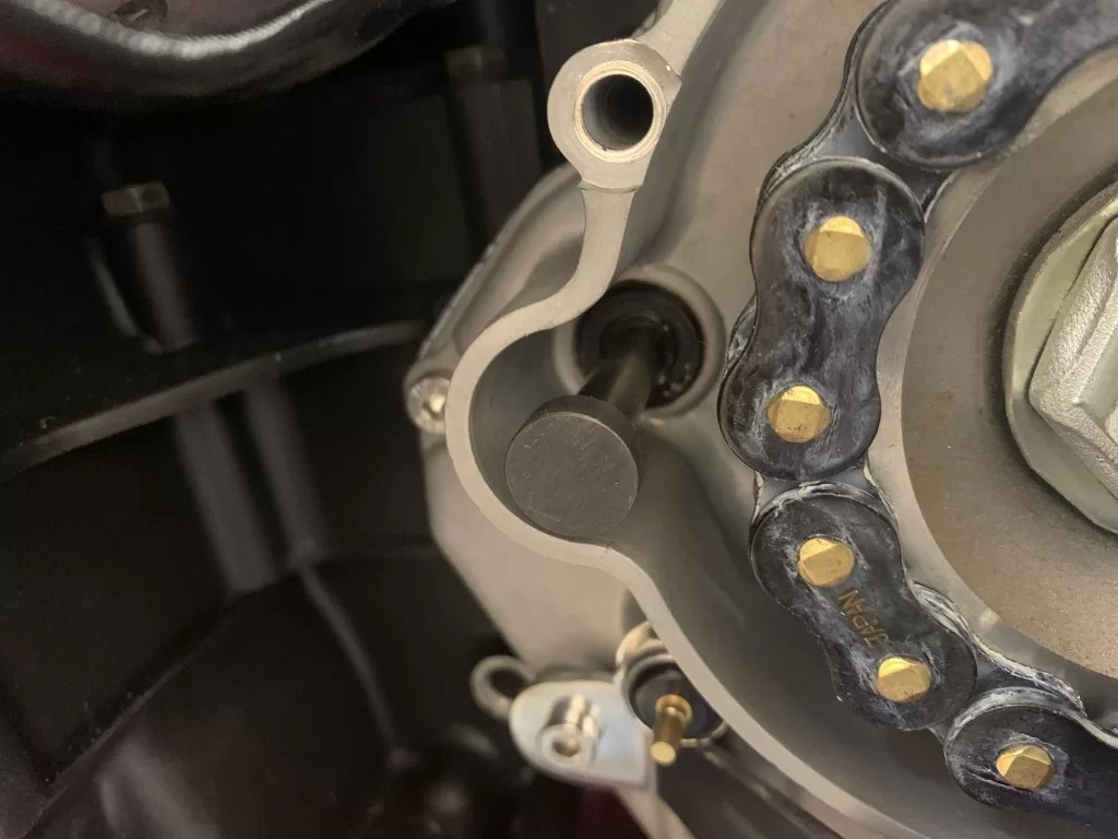

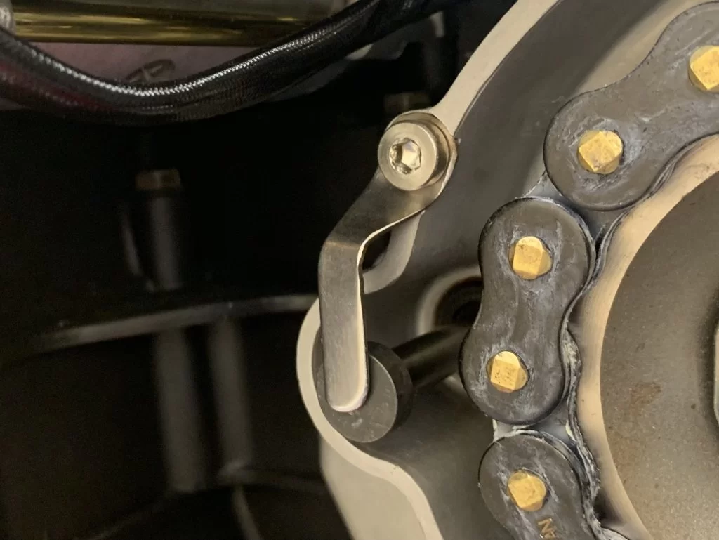

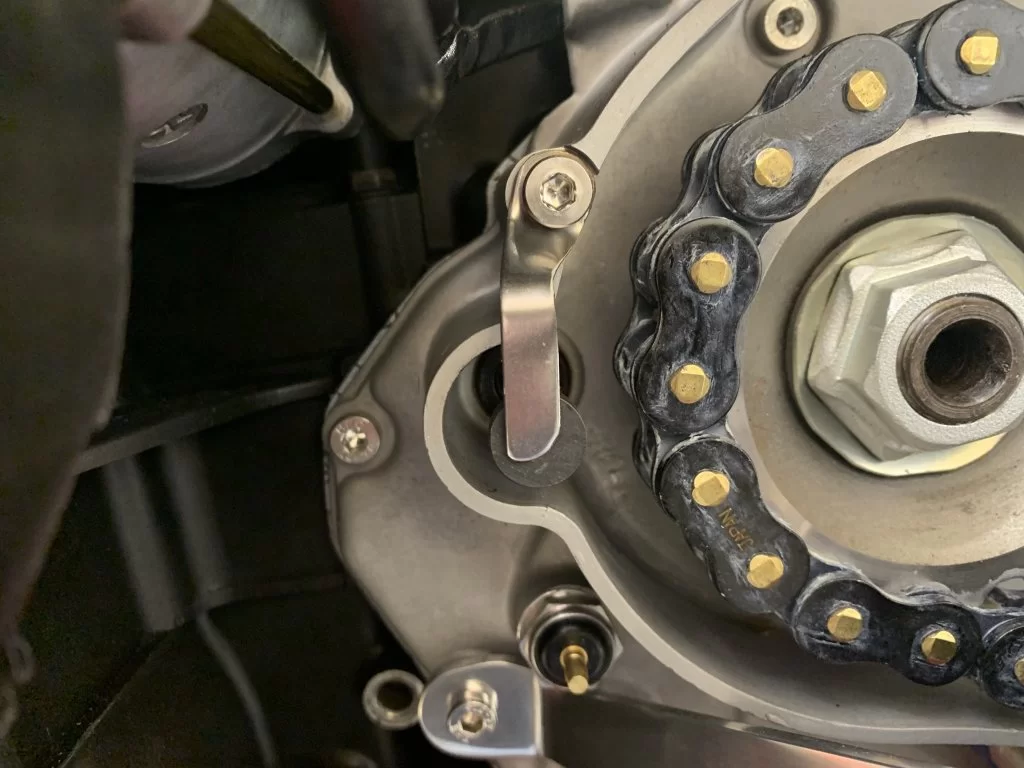

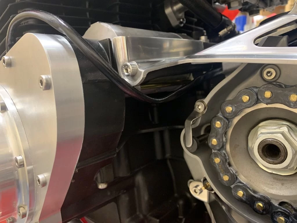

So, airport run over and an afternoon fiddling with a long awaited task - plugging the redundant Clutch Push Rod seal/hole.
I had decided just to plug it with a new rod (thanks Mark) and hold it in place with a spring clip. I made it from a microphone clip ordered off eBay for a couple of £. It was ideal once cut to locate into a countersunk recess in the casing which prevents it turning.
Clever. 👏

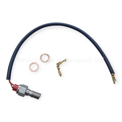

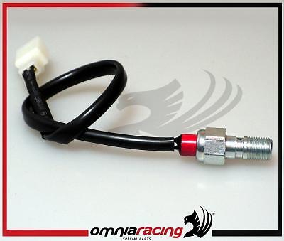

I also need a brake banjo pressure switch for the rear brake - I think light-tec do one again rather than buying cheap stuff of of eBay.

Brembo do the banjo pressure switches.
Thanks, found this one but it says M10 x 1.25 in the title but in the notes it says M10 x 1.0 are used on all Genuine Brembo Master Cylinders :unsure:
So I guess it's this one:
That's the wrong thread :)

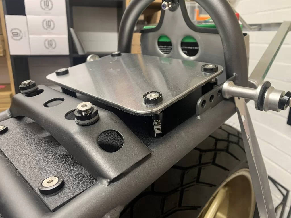

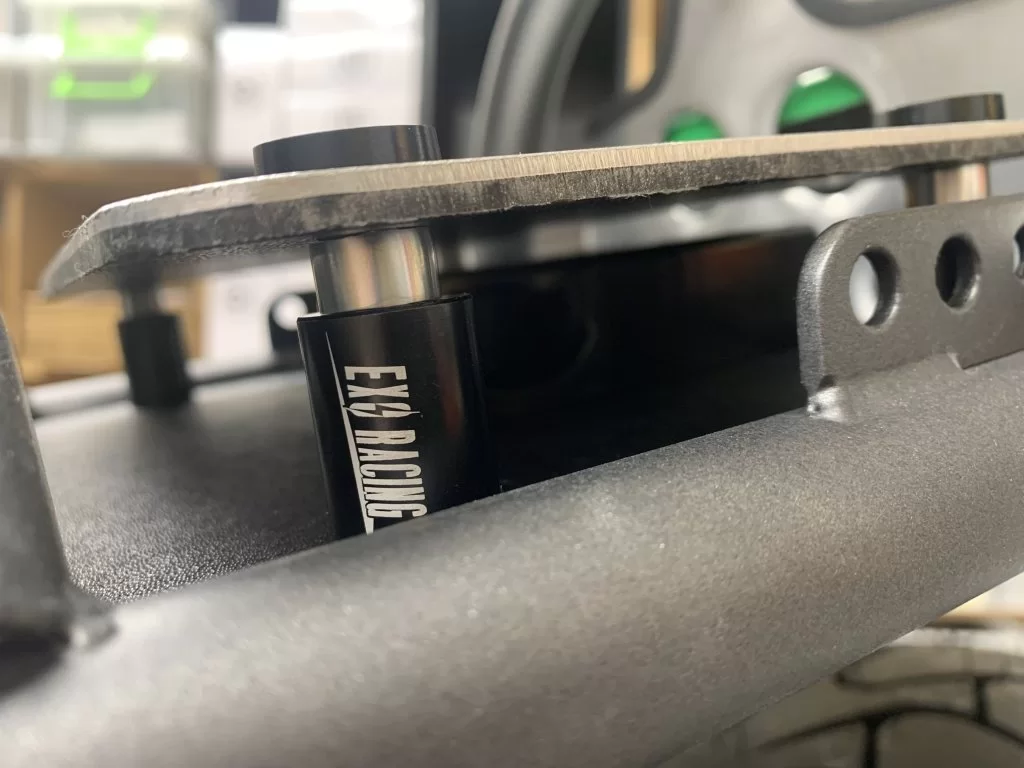

Yesterday I added 4 spacers to my electrical platform so I can fix the igniter box under the plate if needed. I will see what room I have on top when I get all the bits together.
Today I’ve ordered my fuse box and ignition switch 🙂
