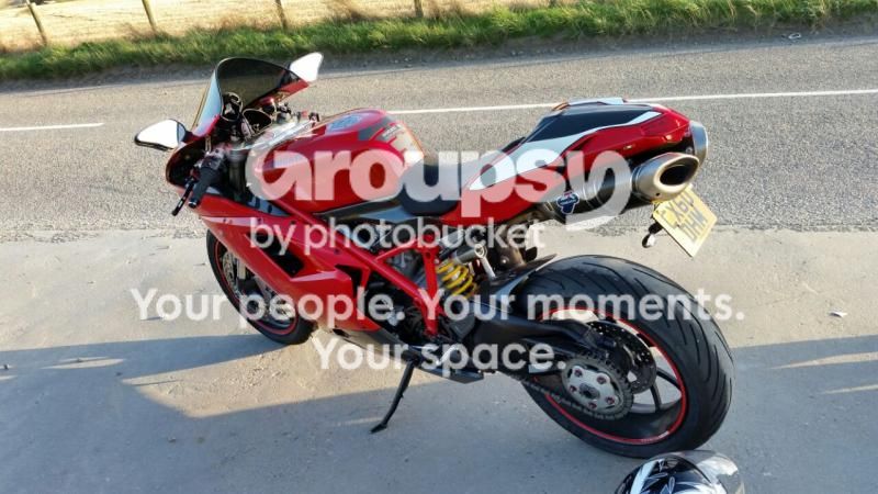

I've moved up to a 10 plate 848 evo with all the extra's, FSH and so far I dont like it. I disliked my 748 when I first got it as it was uncomfortable, a handful in town, clunky gearbox and loved nothing more than to cut out when the lights started to change to green. The 848 is exactly the same minus the cutting out.
I'll do the usual mod's, smaller sprocket, suspension and get it dyno'd. Is there any way to soften up the brutally jerky throttle in town? Perhaps a power commander with switchable maps?
At one point I was doing 300 mile a week on my 748 commuting without any back or wrist pain. One 30 mile trip to Aberdeen on the 848 and Im in bits. Before I even got to the city anyone behind me must of thought I was trying to play a game of twister on the bike with the positions I was trying. All to get the pressure off my wrists and back.
The Termi's do sound amazing though.

I'm wondering if your trouble with the riding position is related to the suspension settings..? I have had no trouble at all with the riding position having ridden a GSXR 750 for 6 years prior to my 848. I reckon the 848 is about as comfy as a bike like this could be, but I had the suspension set up near the start of my ownership and the seat height is a good 25mm less than stock, which takes a lot of pressure off my wrists.
I'd get that done asap and see how it goes. My confidence wasn't great when I first go the 848 but the setup transformed it, and my confidence.
I've got the Termis and ECU too and the throttle response is superb. How much slack have you got in the cable? Maybe it needs a wee tweak?
Sorry if this sounds patronising, I'm just thinking out loud...
I'd still opt for a sprocket change, every Ducati I've had has felt better with the smaller front sprocket.
+1on the sprocket change - the only Ducatis of mine that I haven't done that on were my '84 Pantah (didn't know any better then) and my Multistrada 1200 (torque overkill everywhere). However… …I'd always go for a bigger rear sprocket than smaller gearbox sprocket, for two reasons: reducing gearbox sprocket size significantly increases torque load on the sprocket/output shaft. It can also reduce chain clearance on the swing arm (ST4s for example). First thing I'm about to do on my new (to me and to Scotland) 749R is go from the stock 35-tooth rear sprocket to at least 39 - it's just reminded me how over geared Ducatis have been through the 2000s - I assume to get through noise testing. I wonder if the new bikes with their EU-beating exhaust valves run lower gearing?
Ideally you should change the gearing at the back, however...
initially it's much cheaper and simpler to swap front sprockets, this way you wont need a new chain as well as the pricier rear sprocket, and if for some reason you dont like it it's an easy swap back.(last time I checked front sprockets were about £15 or so, cant imagine they'll have gone up too much further)
When the chain get toward the end of it's life then is a good time to go back to the 15tooth front as you'd be changing the rest of the set up anyway.

Ordered a 14T front for now as the rear sprocket is in good shape. I'll do as you say and swap it back for a 15T and larger rear when it comes time to replace the chain and sprockets.
Been out on the bike a few more times, I much prefer throwing it around the city than I do out on the country roads. I went out a 70 odd mile jaunt to MacDuff with a friend and rode back East on the coastal road which was heaps of fun. On one straight we decided to up the speed and I noticed the first limiter light flash at around 148ish. It was then I remember reading a post saying that a 14T front sprocket will have the bike topping out at 156 before the limiter kicks in.
So once home I go down, counted the teeth on the front sprocket and what did I find. 14 Teeth :lol2:. 13T perhaps?
