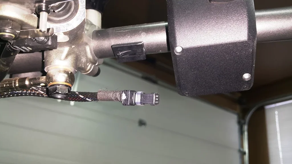

I've dried the switch block from the outside but I can't for the life of me see how to separate the switch block itself and remove it to dry the inside. There are two pozi screws but they only split the throttle cam and RBW wiring (which was bone dry). I can't see how the electrical block, which is separate, comes apart at all.
Can anyone help?
This might help with the switch dismantling ....
