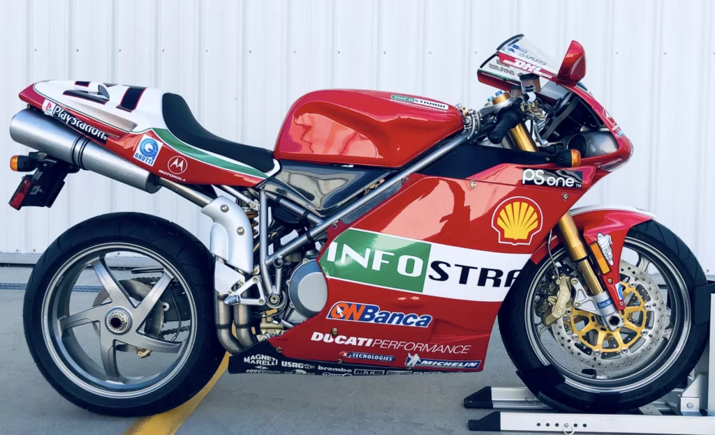

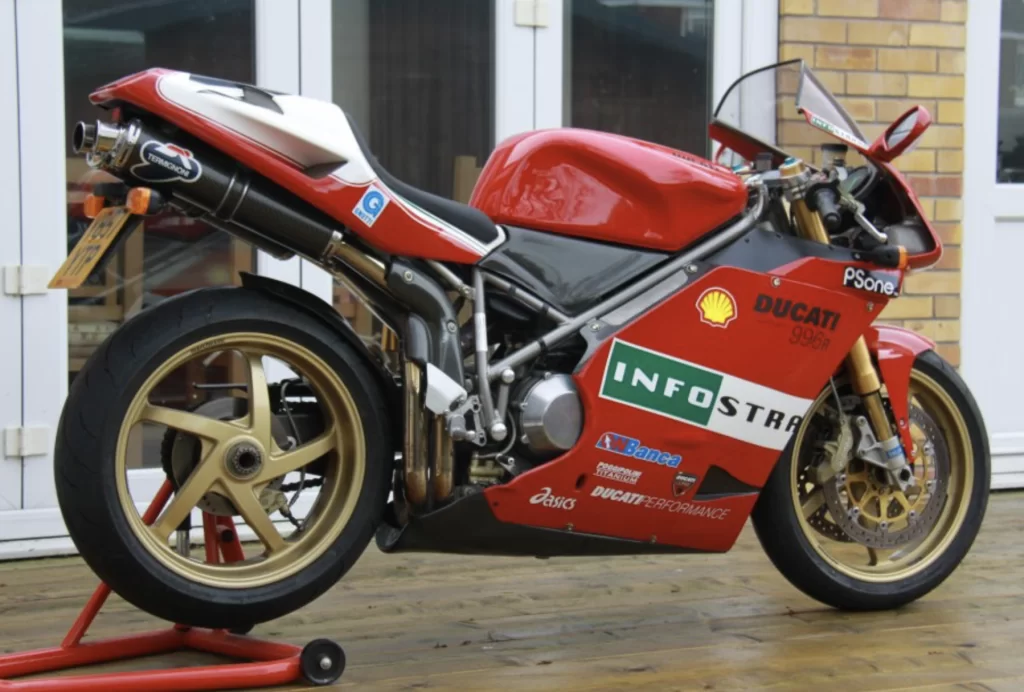

Obviously im no expert... but I don't believe this left the factory like this...and I know that cos only 749R's( to avoid confusion :ROFLMAO:) get gold wheels added ..and the quality of the sticker kit is better.. and fits the fairing!
That's a beauty 😍 and a proper Homologation model too with a proper Ducati Decal Kit fitted (DP-RS Sticker Kit btw 🤪) I bought it like that at nearly £15K below current market value and it is to be put back to standard as sticker kits don't work :)(y) I see you notice the lurvely period magnesium Corse wheels, they will be swapped for standard too and sold separately for £gazzilions 😊
