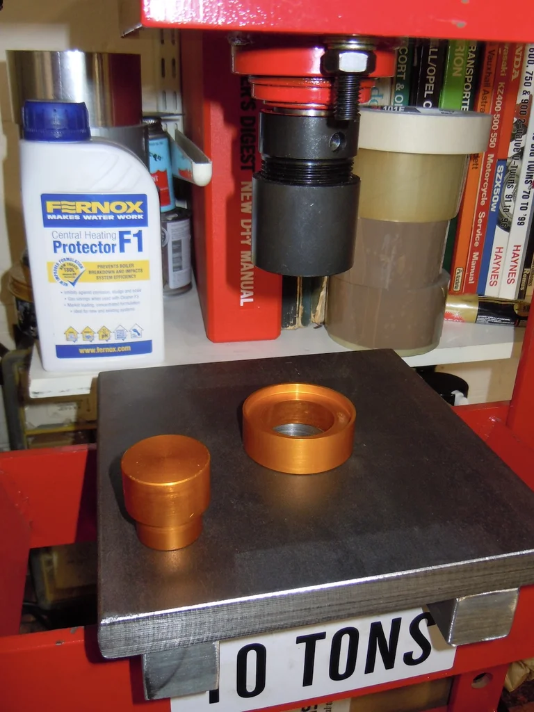

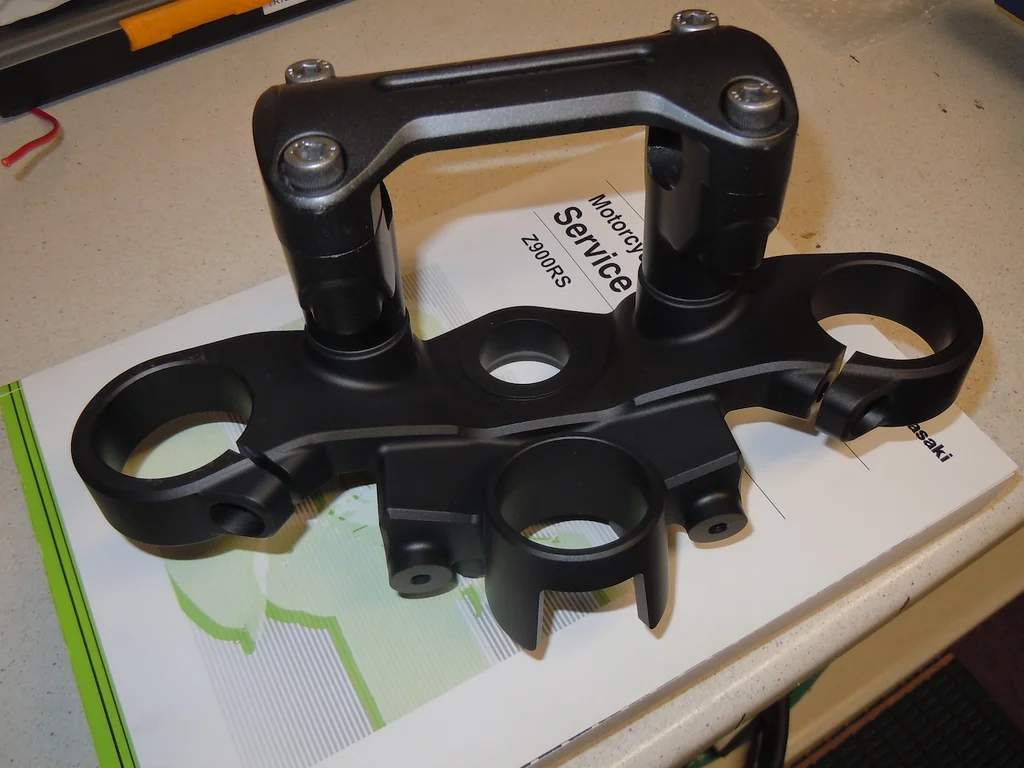

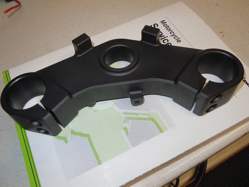

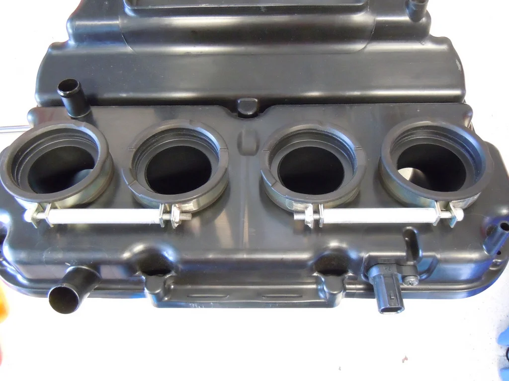

Called in today to drop off my rocker covers for anodising, (went Friday, but they were closed !! :mad:) & my yokes were ready. Result (y)

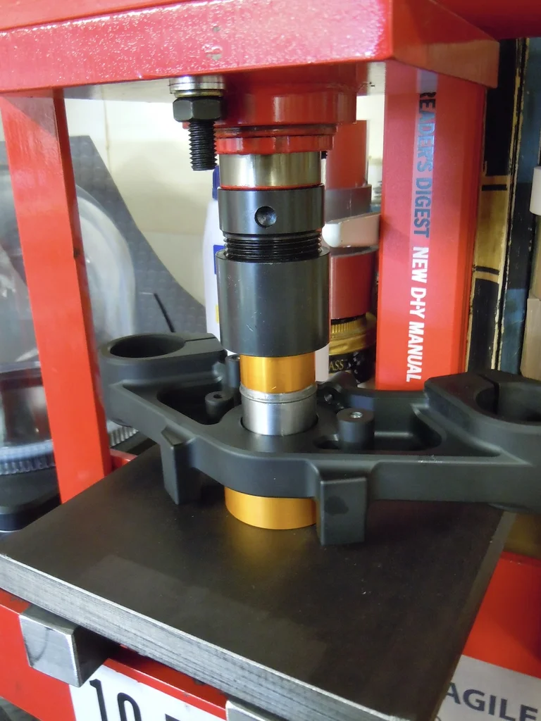

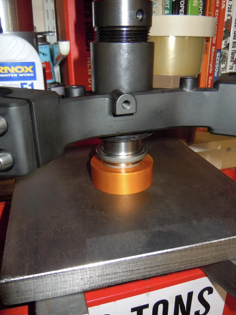

Steering stem is in the freezer now shrinking. I'll get that installed tomorrow once it's had time to shrink.
I had them vapour blast the two parts to remove all the machining "lines" & to make them look like the original cast Kawasaki parts, turned out well I think.

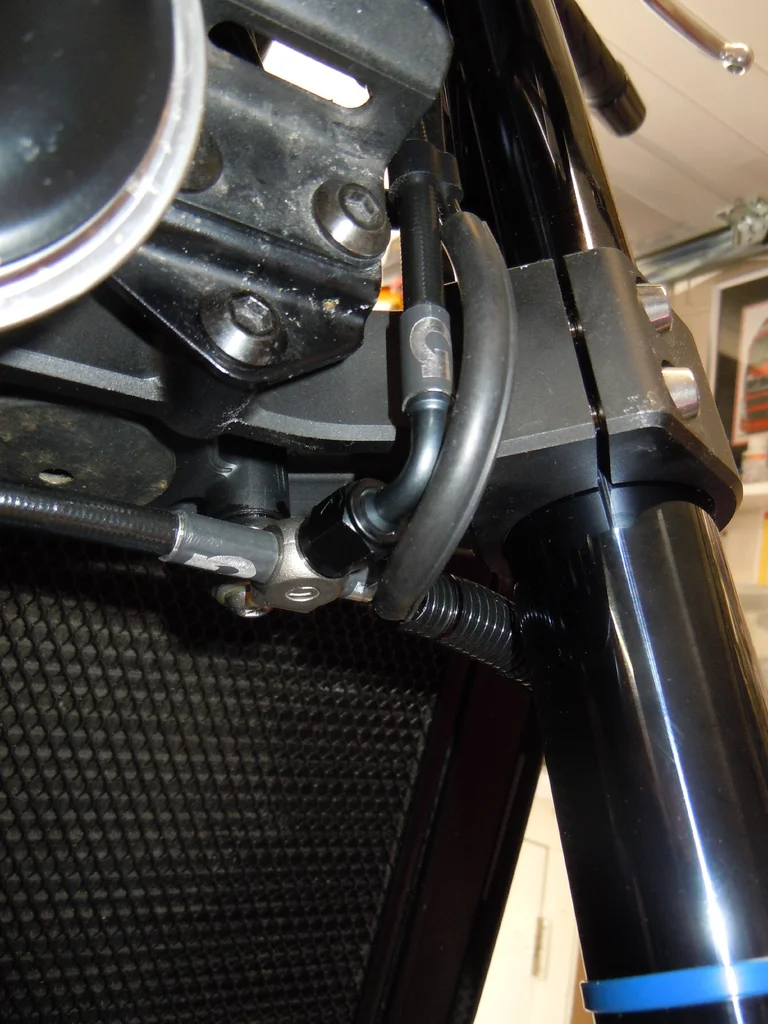

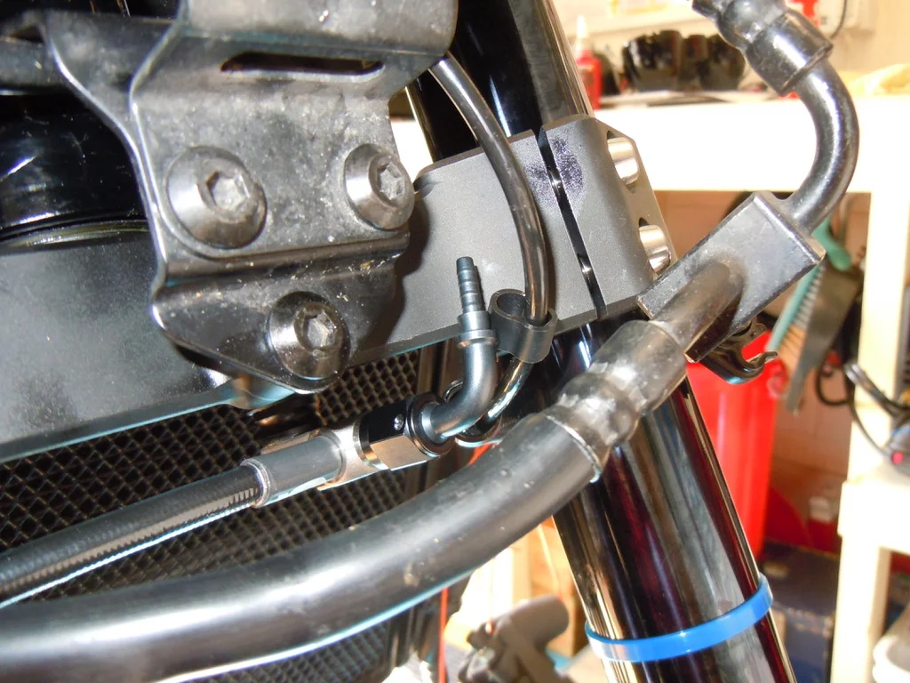

Once these are fitted & the forks are in I can get of with the last two jobs to complete the fork swop, getting the final brake hose cut to length & swaged & getting two front mudguard mounts made.

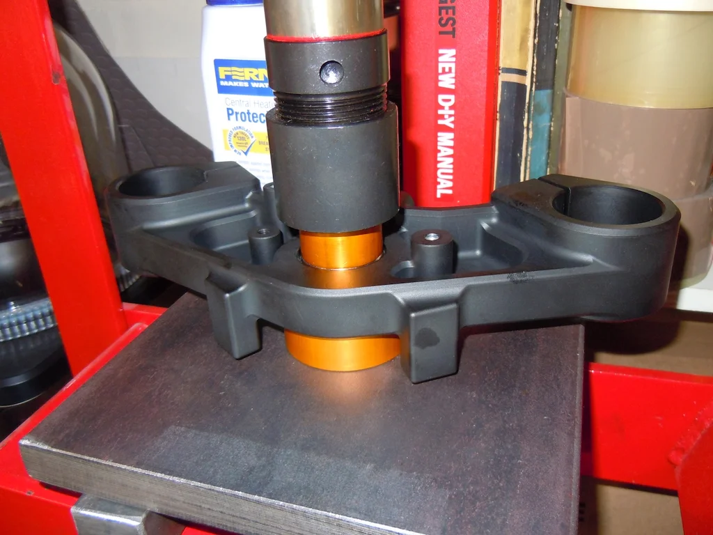

Also today (!!) the lump of steel plate that I'd ordered to get the lower yoke/steering stem correctly positioned in my press arrived this morning.
So after fitting the rocker covers to another project, I got the steering stem fitted in the new lower yoke.
With everything lined up the pressing commenced !
The stem had been in the freezer for a couple of days & the yoke was warmed up around the stem hole & a few seconds later the stem was fully home with the snap-ring stopping the stem from being pulled right through the yoke.
Bits at the ready,
With everything aligned & in position,
Pressed fully in,
Followed by the lower bearing race & seal,
