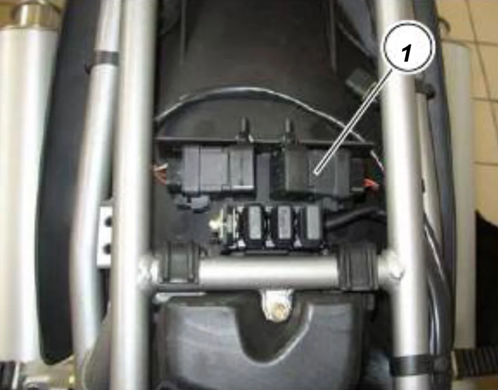

chrisw Elite Member Yesterday at 10:56 PM #2 Unlike the ST3 (under seat) I believe the ST3S fan relay is behind the left side fairing.
chrisw Elite Member Today at 10:08 AM #3 The parts fiche on Ducati Omaha is showing the relay under the seat.
Barry Hell Elite Member Subscriber 59 minutes ago #5 chrisw said: This is from the ST3 workshop manual. View attachment 161815 Click to expand... Same as all ST's I think
