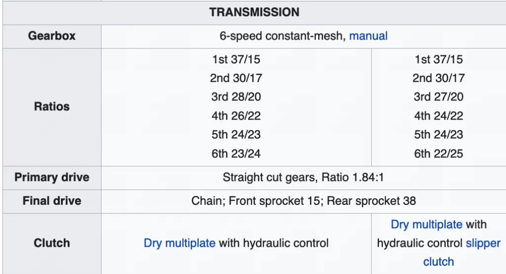

does the R have a different gearbox ratio than the normal S models?
How do you find riding it when caught in traffic etc?

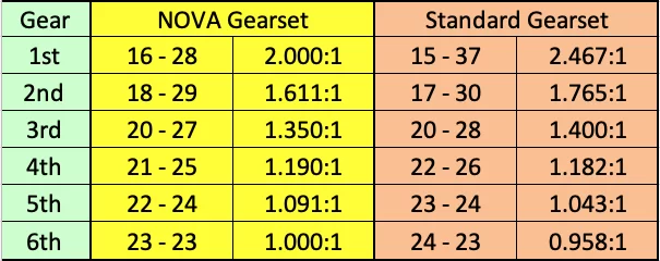

Mine has a NOVA box, with close ratios.
Apparently according to Wikipedia, the 1098 & 1098S (left) have different ratios to the 1098R (right)

If you do get stuck in traffic, you just have to ride the clutch a little at very low speeds. But that's not what this bike is for, so I make sure I use it out in the sticks. Like I say, I could change the rear sprocket but it's not as issue on the move. You can also see the NOVA ratios below where 1st is somewhere between 1st and 2nd of the standard bike.

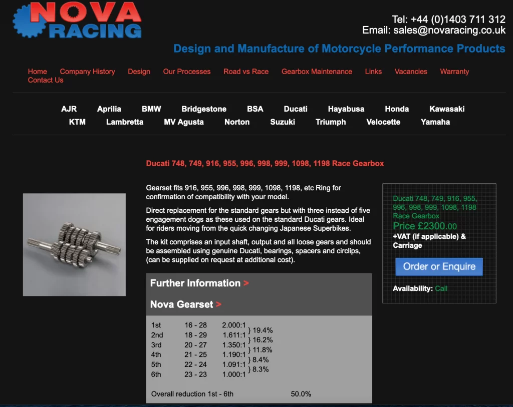

I went on the NOVA site earlier as the gear ratio table I shared above on NOVA ratios didn't look right for 1st gear. 28T / 16T = 1.75 : 1 and they quote 2.00 : 1 🤔
1st gear on my bike feels like 2nd on most other bikes and a ratio of 1.75 would take it close to the 2nd gear of a standard gearbox.
The NOVA site gives those ratios but does state 2.00 : 1 🤔 All of the other ratios seem correct.

I went on the NOVA site earlier as the gear ration table I shared above on NOVA ratios didn't look right for 1st gear. 28T / 16T = 1.75 : 1 and they quote 2.00 : 1 🤔

As the input shaft has a fixed first gear and they quote a 16t gear. The output would be 32t as a good guess.
You would think so, wouldn't you as the output gears get smaller as you go up the box, apart from 1st. 🤷‍♂️ I think you're right, I think it's a typo and should be 32T.
