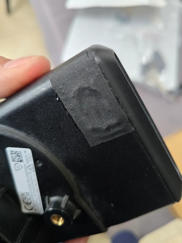

@chrisw thank you, I did what you suggested. I got the bike running, but I must say it was not painless, price was higher (agreed on 320 but ended up being 330 + shipping). The timing and communication was not so smooth as hoped. But I understand he must be busy with other jobs.
Bike works great, but the display has a not nicely patched hole in the back (I guess where he drilled to access the chip) . I will have to think how to make it less visible and maybe more water proof.
I have mix feeling about recommend him to other, but as I don't have an alternative , maybe I would recommend him but with reserve.
Nevertheless, thank you , it did work!
Maybe I can ask you for some other recommendation, my fuel tank has a dent, I like to have it fix, do you recommend anybody in the London area where I can bring it to have it fix and repaint?
best,
Alessandro
I understand that all is good now, but that repair to the unit is a feckin disgrace 👀
Hi,
frankly if I knew where to make the hole and how to read the data, I would have preferred doing my self.
the cost and the result was not up to part.
i will share how much I know online so other people does not need to go through what I went through.
but all in all, I am glad my bike works fine.
