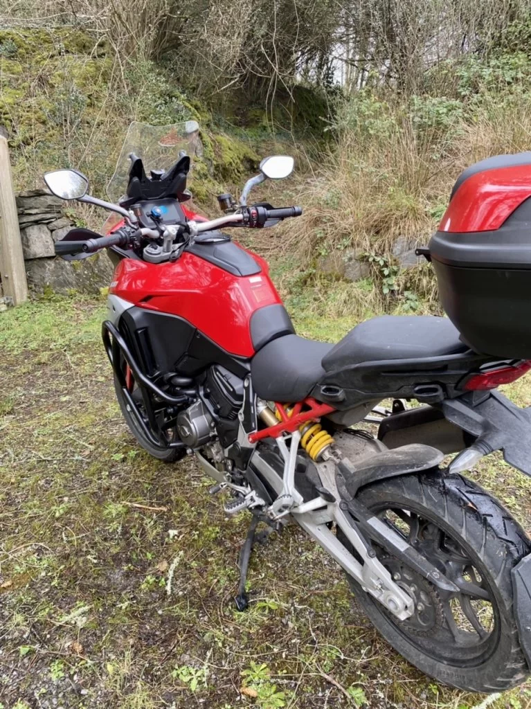

Well, that has been a long time since I updated this thread. Why? Because the bike has just performed faultlessly and apart from the fact it’s so damn comfortable and so damn fast there’s been nothing of note to write about.
However, as it’s now been with me for a year and just had its first annual inspection and I thought I’d share this info - this is after all a motorcycle forum isn’t it 🤔🤣.
It was due its annual inspection but, as I’d done just under 13,000km, I asked them to do the 15k oil service as well. The total bill was €321. It was with them about 5-6 hours as there were a number of software updates to load into the bike as it’s not been there for 12 months so that takes time plus there were 4 recalls that had to be done, which they assure me weren’t charged for.
1. My exhaust heat shield had to be replaced due to discolouration
2. the centre stand bolts & bushes were replaced as the original ones could fail.
3. The screws that hold the plastic petrol cap surround and phone holder in place had to be removed, thread locked and replaced to stop that plastic trim going out of alignment (mine was fine actually).
4. Likewise, the screws that hold the tail piece in place had to have the same treatment as apparently some tail pieces have fallen off😮.
I forgot to mention to them the heated pillion seat didn’t work on its high setting but that was fixed as well and they must have known about it as a fault because when I got the bike back it was on and on the high setting and working. Whether that fix was as a consequence of one of the software updates or a known loose connection somewhere I’ll never know but at least it now works on both low and high settings👍.
Finally, as I asked for the oil change to be done 2000km before it’s due (it’s an 800km round trip for me to/from the dealer so I didn’t want to go back in a couple of months), I fully expected I will see the oil service due warning come on as I approach the 15k Km. However, rather surprisingly, I noticed in the service settings when I got home they’ve actually managed to reset it before it’s tripped, which is a first afaik👍. So no annoying, and unnecessary, warning light in the near future.
I have done more mileage on this bike in the past year than I’ve ever done on any of my other bikes combined previously. I’ve chosen the bike rather than the car when in the past I would have taken the car. It’s a pleasure to ride👍.
I’ve had zero issues with it.
My rear brake works, but is nowhere near as effective as that on the Desert X I test rode whilst waiting for mine.
I’m still on the original tyres that have performed faultlessly in all weathers, at all speeds, bar a low speed lowside on damp grass 🙁. The rear is now below it’s wear limit but new Dunlop Mutants arrive shortly.
Some owners have complained of intolerable vibrations through the pegs and the bars. IME there are vibrations that can be felt through the foot pegs at 7-9k rpm but they don’t bother me and actually are noticeably less after yesterday’s service. In fact, apart from a JIL4 I can’t think of any bike that doesn’t have some vibration.
There is, and always has been, some hesitation in the throttle/fuel mapping if you hold it at 4,000 rpm in any gear. It’s almost as though, if it were carbs, it’s on the threshold of changing from the slow idle circuit to the needle jet circuit and doesn’t know which to be on. I’m sure a session on a dyno would tune it out as it’s probably emmissions related in the engine maps but I’m not going to do that as I don’t want to invalidate the 4 year warranty. It’s not excessive or overly intrusive and Ive learned to chug around at 3k in a higher gear if needs be, there’s more than enough torque, or more likely have it at >4.5k in a lower gear.
I’ve never experienced anything other than rock steady stability at speed, even with a top box on at over 200kmh despite some owners complaining of the front wheel going light and wobbling at speeds in excess of 160kmh (100mph). Personally, I think their issue is down to tyre pressures (I run mine at the recommended 35/36) and/or too much weight in/on the top box which sits behind the rear axle and will act as a lever to lift the front wheel.
The OEM chain is a low cost DID one with steel plates which rust which is a shame but on the good side after the initial stretch during the 1000km run in period I’ve only had to adjust it 2x in 13000km.
If I have one criticism it’s the fuel consumption, I get 14.5Km/litre on average (that’s around 40 mpg imperial) but I’ll live with that for the thrills that engine provides, especially once it’s hits 8000rpm😁. Besides, I don’t notice it’s fuel consumption when on my own, it’s only noticeable when riding over a few days with others and filling up each morning and noticing the others only need 2/3rds the fuel I do, ehh @Hugo Magnus 😁👍.
I’ve done long trips, 13hrs in the saddle, without any issues but I appreciate that’s totally subjective depending on one’s arse.
All in all, in my experience, its a brilliant bike, I have no regrets in buying it a year ago and am so glad I didn’t buy the GSA I very very nearly did as that is just soulless compared to this.
ps. You can send me the money now Ducati 🤣🤣
pps. I have only ridden this one once since I got the Multi 😕
