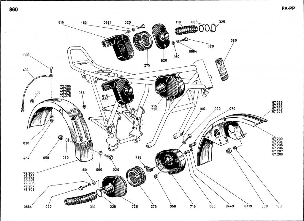

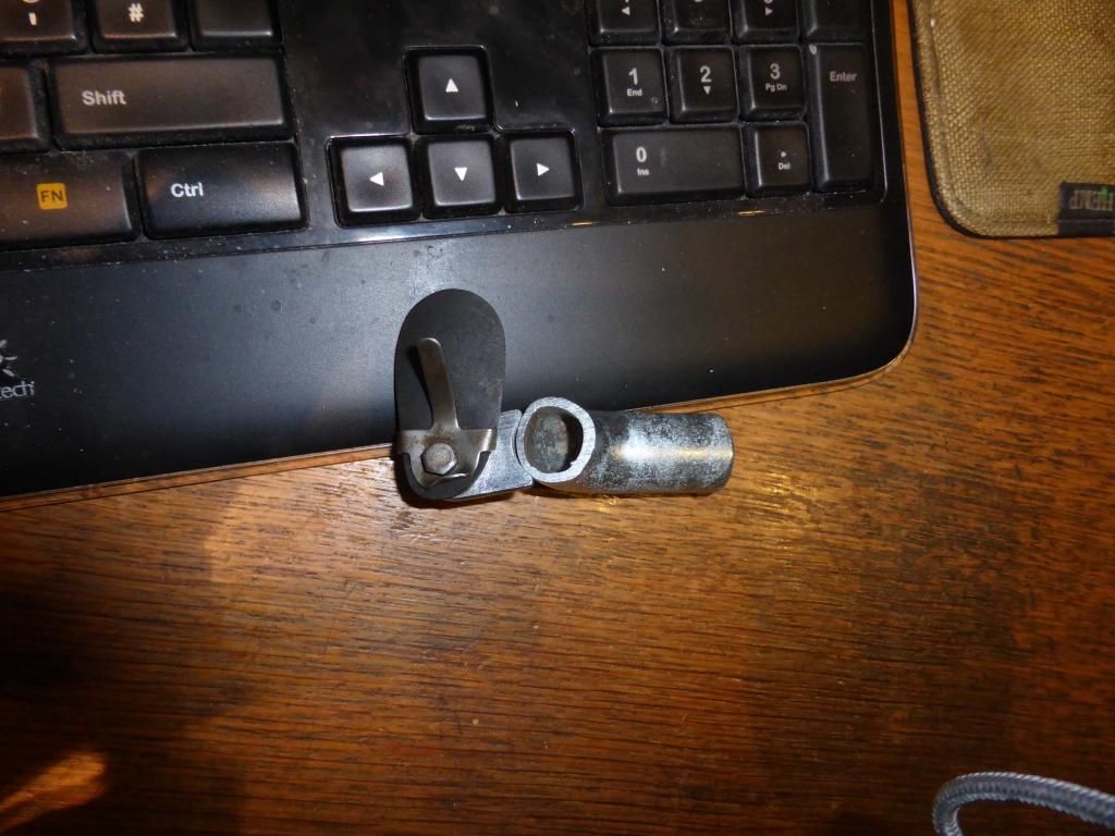

The front airbox has an input for the crankcase breather and I am not sure how it mounts, if anyone has done this recently (Derek ;-) ) I will be very grateful if you will let me know how it is assembled; It all seems a bit jury rigged to me.
i am not sure whether part #: 0960.91.735 sits inside the airbox or outside...
The diagram is close but the way my airbox attaches to the frame is slightly different.
I am unhappy that air seems to be able to swoosh in unfiltered around this really naff part - please tell me I have got it all wrong and there is a perfect seal :faint:.
I agree but you have to see what a crap seal it is to believe it; I am unwilling to accept that way back even then they thought it was 'OK'.
It looks like a significant proportion of air to the front cylinder was and is never cleaned.
It makes me wonder why I am bothering; Amusingly it was your comment on engine wear with / without filters that scared the bejabbers out of me and made me decide to filter if at all possible. Now it looks like filtering 'sort of happened' for the front cylinder. The filtering for the rear looks OK.
Thanks Paddy, those pickies are just the kind of help I needed.

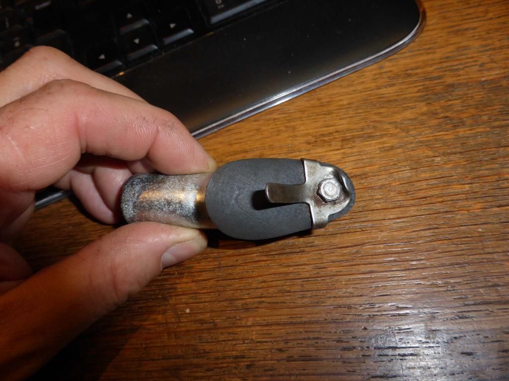

I'll have a play and let you know. Mine has a flappy rubber bit too on the inside but it all seems a bit gappy & lacking in seals between the airbox and this fitting...
Yes i think mine is missing the rubber flap which i think is a crude one way valve. My elite single had that as well on the air box. Without that the crankcase pressure would just move up and down its pipe as the piston went up and down.
Sorry Paul I don't recollect exactly what was in my air box, but it certainly had the rubber non return flap. The problem I had (and still have to address) is that the carb inlet rubber doesn't quite reach the airbox properly so I just gaffer taped round to seal it. Still don't know why that is but it's on the list for next winter's shakedown. I'm too busy riding it to do any remedial fixes now.

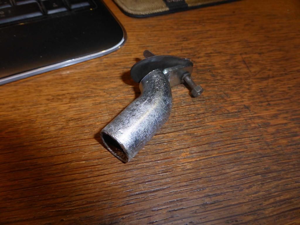

My oil breather tube looks like it is bedded in some kind of mastic ? to make it air tight . It was certainly fitted before the whole lot was painted.
Derek, does this look like yours length wise ? ,just wondered if yours has been cut down ?

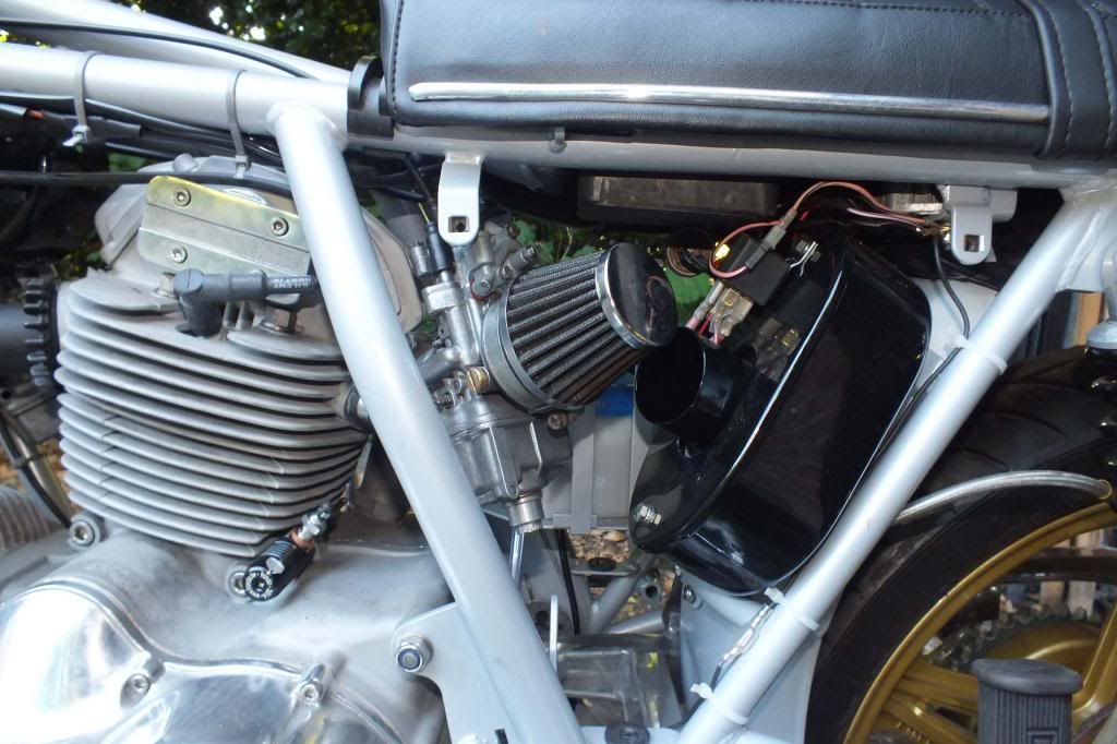

I fitted the carbs yesterday only to discover my master planning doesn't seem to have been in 3D and certainly bears no relation to reality.

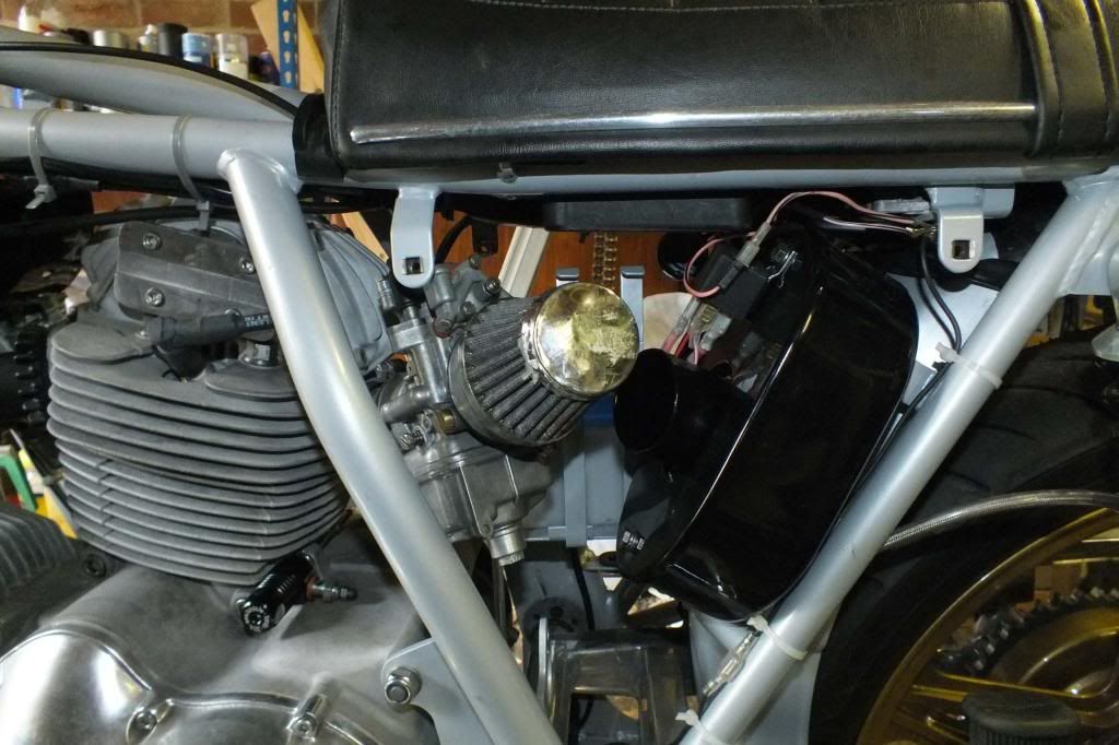

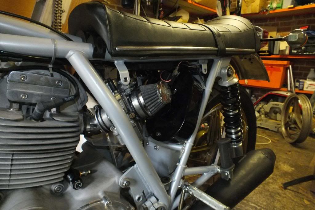

Two problems raised their ugly heads yesterday, first the rear cylinder air filter...
I have not yet been able to source a rear inlet tract rubber for a 900GTS (BTW, thanks Paddy - we'll see!) and so used the filters I used to use on the 900SS after a good clean. However the filter sticks out too far for the side panel to fit correctly; Others have found ways of dealing with this and I took my own route...
Now fits a treat...
Made in exactly the same way as the original, Effective, not pretty - and hidden.
Paddy is on his way 'round this morning to drop off a Darmah tract. I had a look at the ones in Paddy's pictures and compared them to mine; According to Paddy they use the same part numbers so I probably won't have to use my kludge. The other problem I had with my old tract is that the rubber or whatever synthetic compound used had hardened making it impossible to fit in any case. I am hoping the one Paddy brings around is still flexible.
At least I have a temporary solution if things don't work out with the factory air filters immediately - I want to start it!

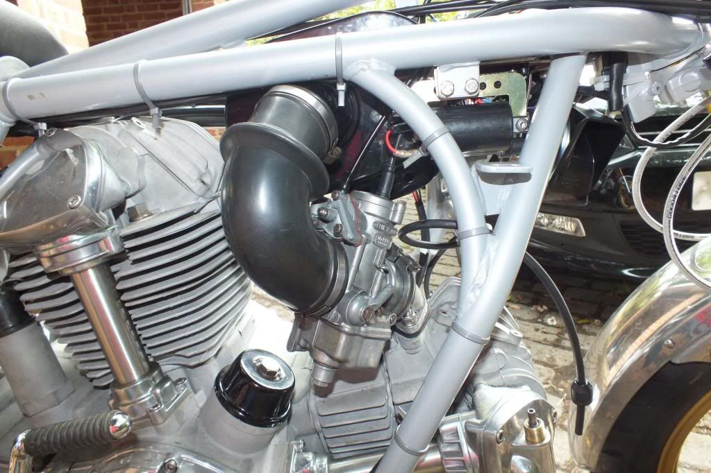

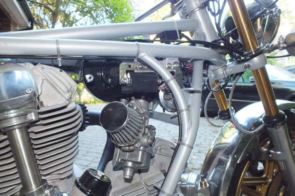

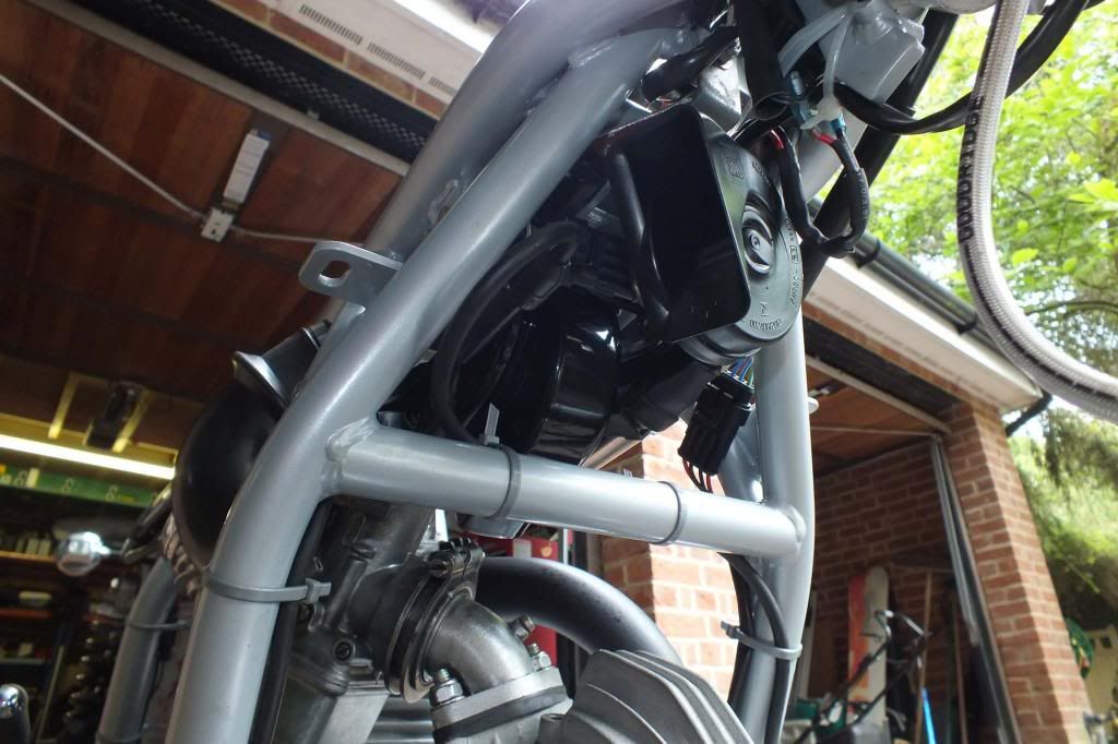

That's the vertical cylinder 'done', now for my genius planning regading coil & horn location for the horizontal cylinder. Ducati have not sprinkled the frame with useful mounting brackets, have a look at this...
Where the 'eck is the inlet tract supposed to go? Another numpty moment :o. :idea: I am going to move the horn to leave room for the coil (I hope) in it's original position. It will still involve some hackery on the coil bracket as I am already aware the mounting holes do not match up.
Still, progress!

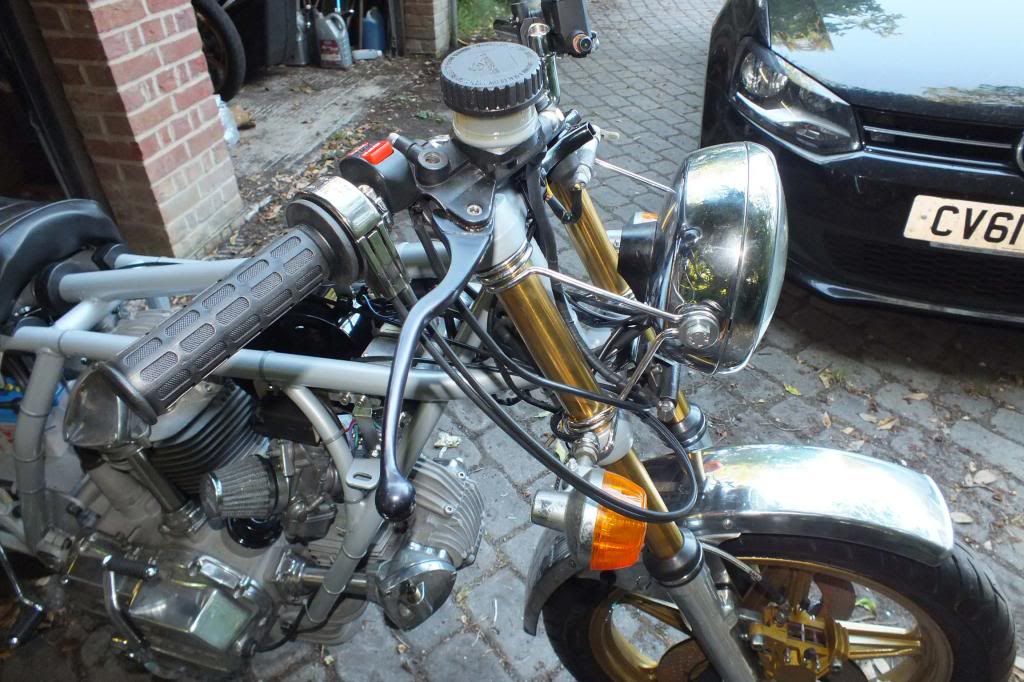

My new Tomaselli twin cable pull throttle turned up along with my Venhill Pantah throttle cables which all (nearly) fitted together nicely (Hat tip to Stephen Eke for this idea) so I though I'd complete the carburettor installations by connecting up the controls. Would that it was so easy! The cable ends on the Venhills are slightly larger than the receiving holes on the twistgrip, so out with the pillar drill and that is now sorted.
Choke cables are a problem - the carbs were so badly corroded, rather than damage the choke mounting plate screw, the cables were cut off. New twin pull choke cables for a GTS seem unobtainable however Back To Classics stock Darmah SS ones which look to be identical - although they are fergin' expensive particularly as Back To Classics seem to charge ~€18 for postage on top as well as higher VAT (is it possible?).

I haven't yet had time to reposition the horn & horizontal coil, hopefully that will be sorted over the weekend. The parts for the loom extender/converter have arrived so that is part built; It is necessary as the Monster clutch master cylinder fouls the original switchgear, luckily I have a spare good 996SPS switchgear which is a perfect fit with the loom converter.
Re choke plungers, As it happens i dont think yours were drilled out just splayed open to take a thicker throttle cable and nipple rather than a std choke cable.

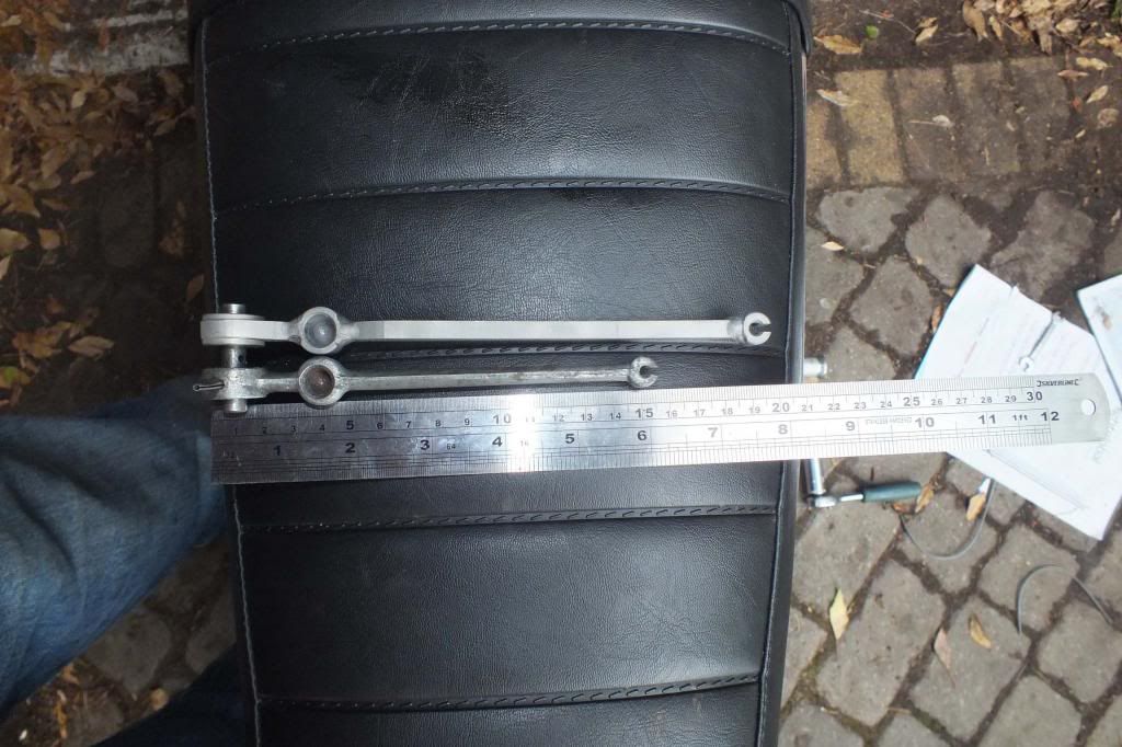

  • a modified clutch arm such that the slave cylinder pulls directly in line with the arm.
Unfortunately the standard arm is too short and as luck would have it the extended arm is too long. Hey Ho. Time for some engineering nadgery and I think I'll run the bike over to a couple of very skilled guys with the all the bits and a brief. I have worked out a way of using a short last 10cm of the original finely braided cable to give some flexibility - both the Magura conversion and the Frando slave implement worryingly stiff options for a linkage which has discernible play in most axes.

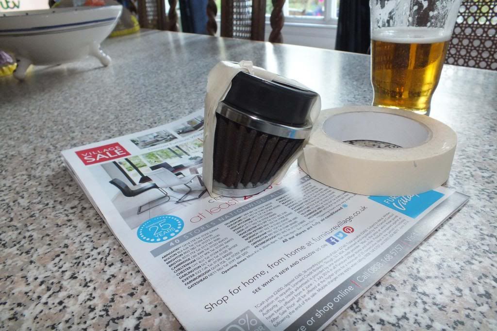

Kludge #1: rear air filter as K&N isn't yet primed with oil...

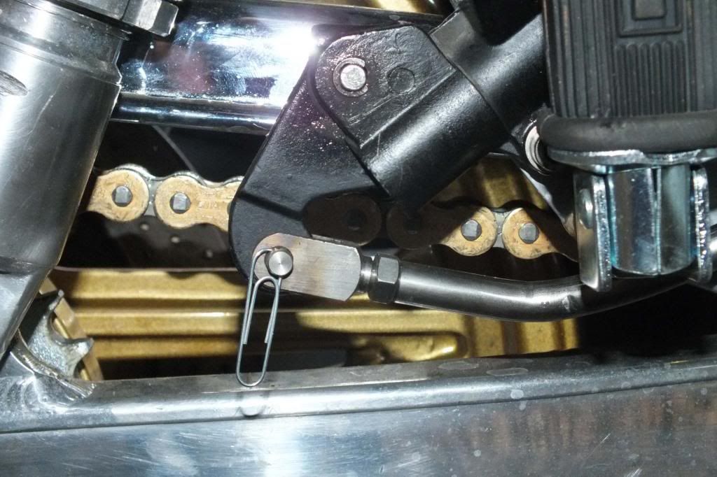

Kludge #2: rear master cylinder clevis pin retained with paper clip...

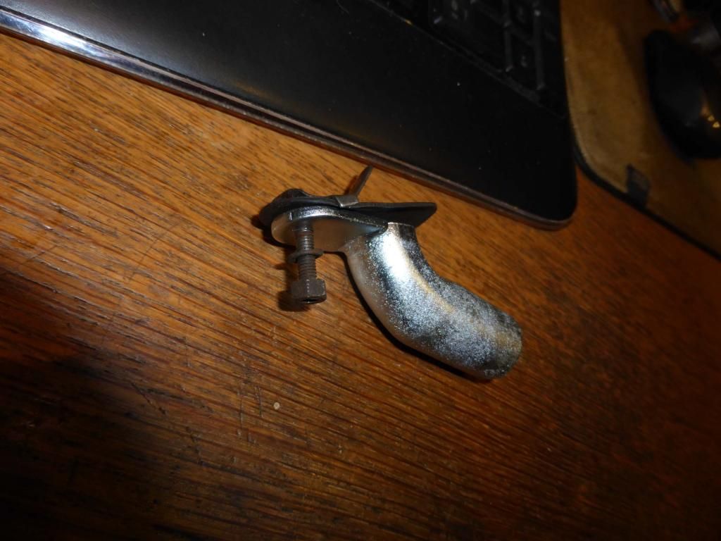

I have added mounting points for a RH side stand pull and have bought & modified a handle to suit; I added the frame mounting point last year before stove enameling. The RH handle is a dismantled & flipped LH handle and it all fits OK with a bit of adjustment. Both handles are off to the chromer's this week.

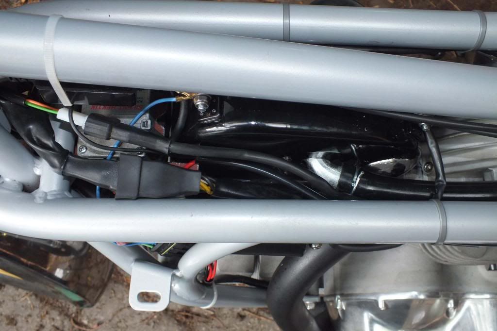

Sorting out the chokes, cable runs & filters took quite a while. Next was the engine breather pipe - fortunately I had a NOS piece lying around which was a perfect fit. I cleaned the rubber front inlet tract & clips & on went the front air filter with nice new clean K&N's. Not perfect, but better than nothing.

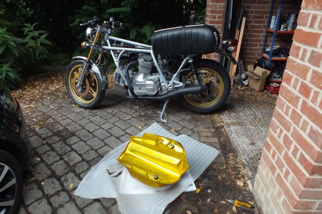

Almost time to start, so I bring the tank down from a 'safe place' banging it on the way down. Oh f:censored:k. Gosh, was I cross with myself but fortunately no harm done.
It is quickly apparent that wonderful though the spray job was, he didn't mask the fuel tap mounts. So off with the tank & I head inside to work on a nice soft carpet, banging the tank again! This time it was the brass front door handle and I was really worried. Lucky me again! So after 'really quite a long time' sorting out the threads with a thread file, now I can fit the fuel taps, cut fuel pipe to match and clip the pipe work securely to the carbs. You might notice this GTS has standard SS/MHR/Darmah 16mm fuel tap threads - I had these made up and brazed in when the tank was cut open for blasting & inspection. Makes life a lot easier without that nonsense link pipe designed specifically to make it difficult to remove the tank. Gone forever with this bike.
Bloomin' eck, does it ever end!
I had successfully lost the mounting screws for the RH sidepanel, I re-found them whilst turning over the garage looking for something else I had lost and pinched some nylon washers I had spare from buying too many sets of SS seat mounting screws.
The main irritation was discovering that the nice new tank badges I bought from Road&Race in Australia simply don't fit - the pins are a few mm too close together. Fortunately I have the originals and they will be going off with the stand grab handles for chroming; Hence the currently unbranded (on the tank) Ducati. Still, things are looking up...
Out with the 5L emergency tank and I have fuel! Unfortunately quite a lot had been used but it is a start and nevertheless, it doesn't leak when I turn it on. It has been a hot close sweaty day so I break for a shower knowing when I come down it is fully ready to start. No chain, mind you but that isn't the point.
I was remembering Derek's comments about starting his GTS after his rebuild and I was hopeful mine would be as easy. It wasn't.
Those 905cc high compression pistons *do* make a difference, as does the 3.5Kg lost from the primary drive/flywheel with the fitting of the Nova Engineering straight cut primary drive gear set. Also the choke which I carefully lubricated keeps turning itself off. Anyway, after about 10 or so kicks, it burst into life, misfiring a bit and I suspect it is because of low fuel, so off I go in search of more fuel and find a full 5L. That does the trick and it really does sound fine although it won't idle at the moment.
By this time Tracy is home and I have asked her to witness the inaugural post testing start. The weight of responsibility is daunting :). She does like the colour...

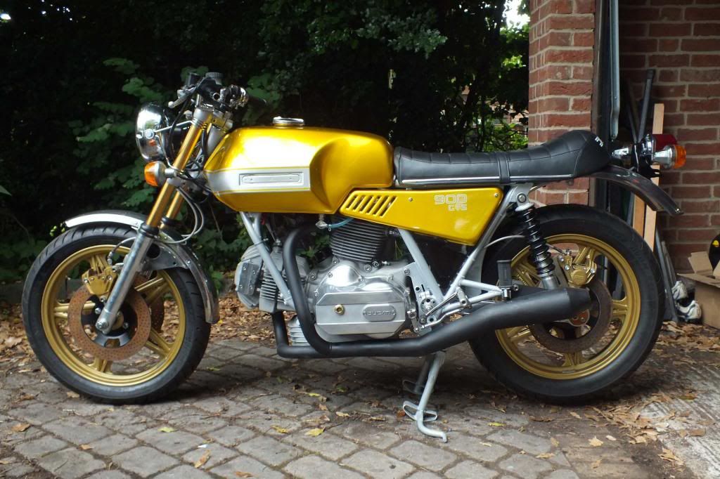

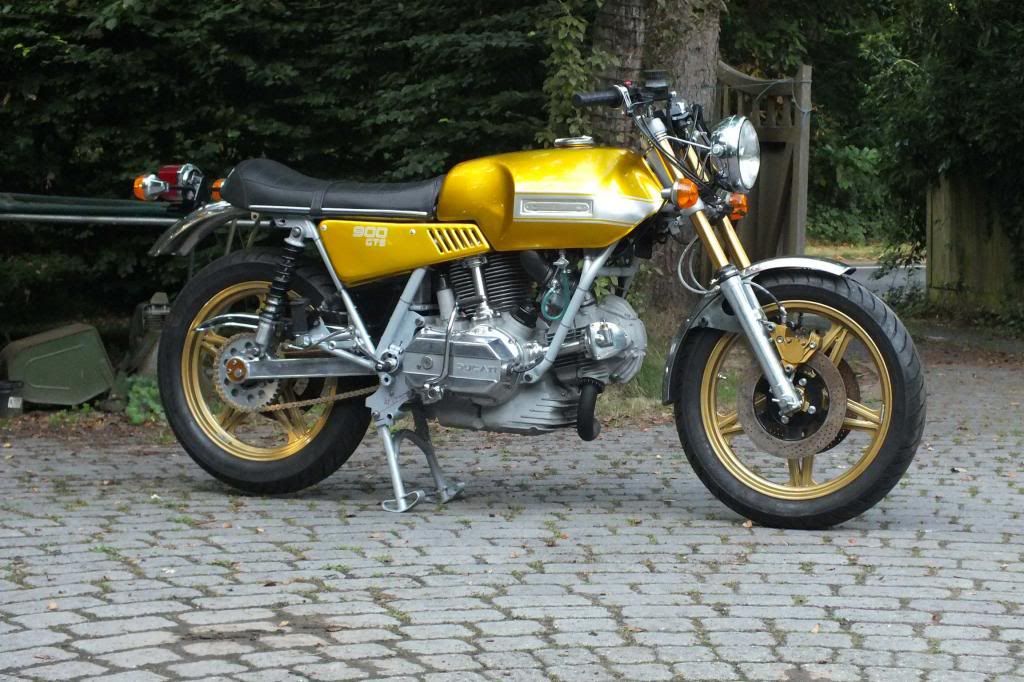

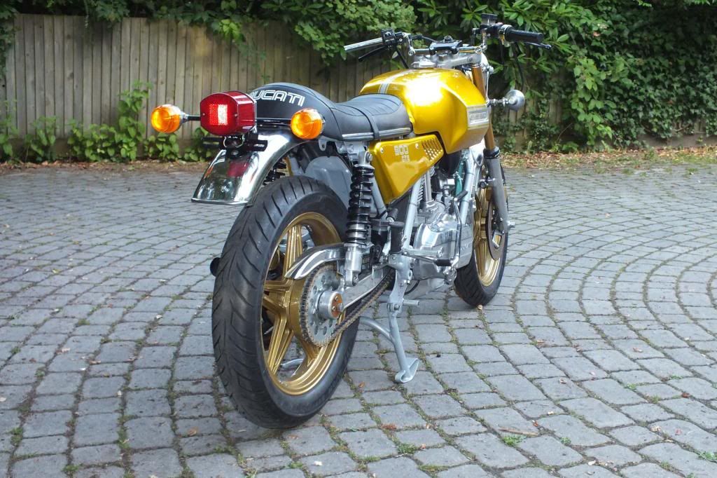

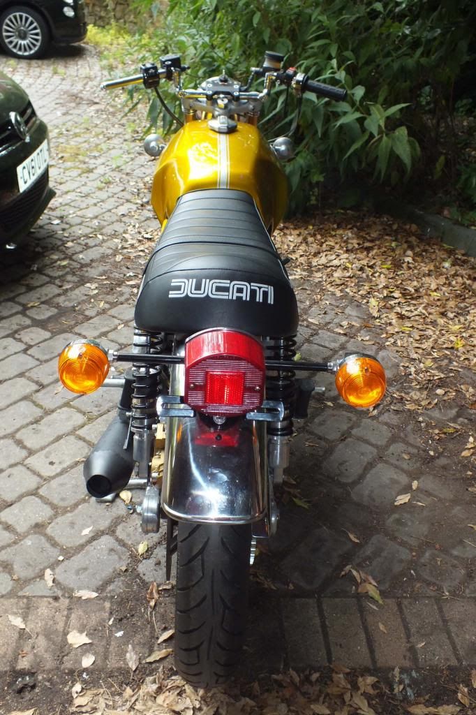

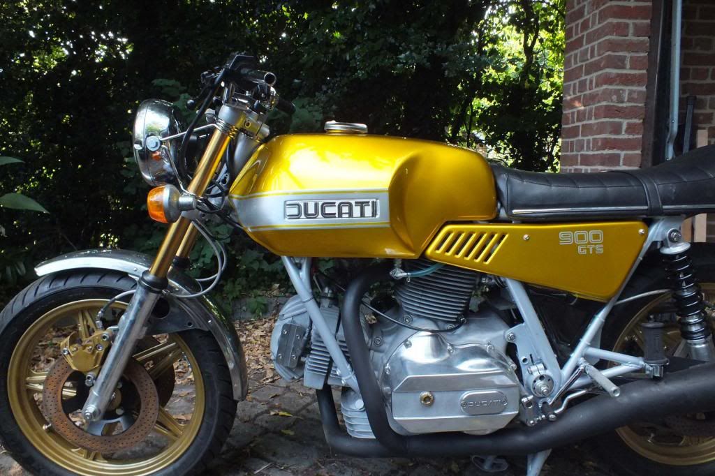

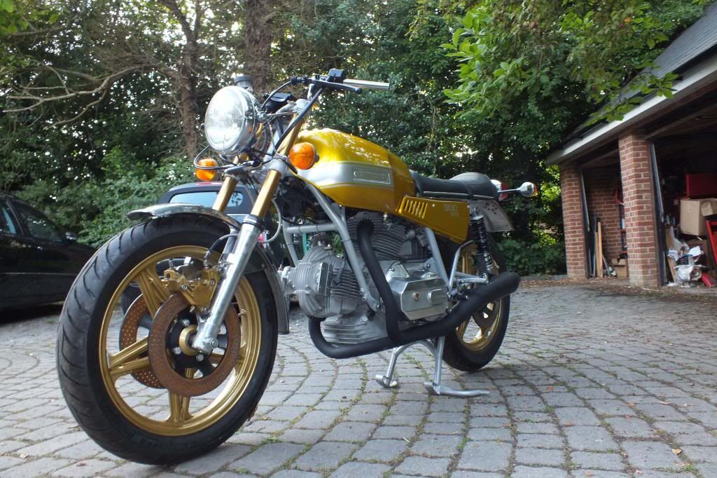

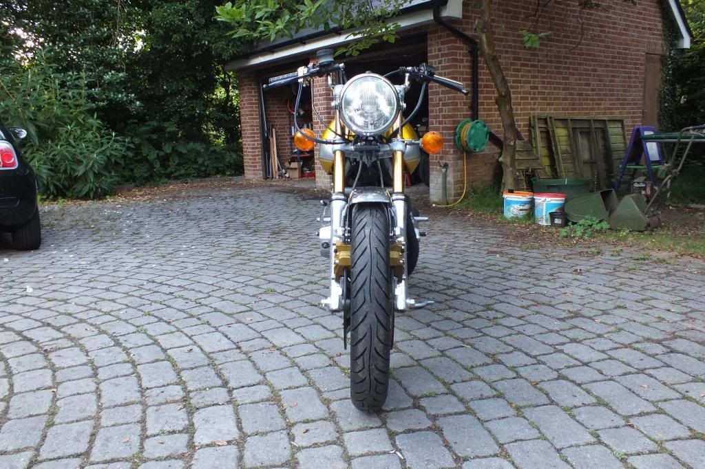

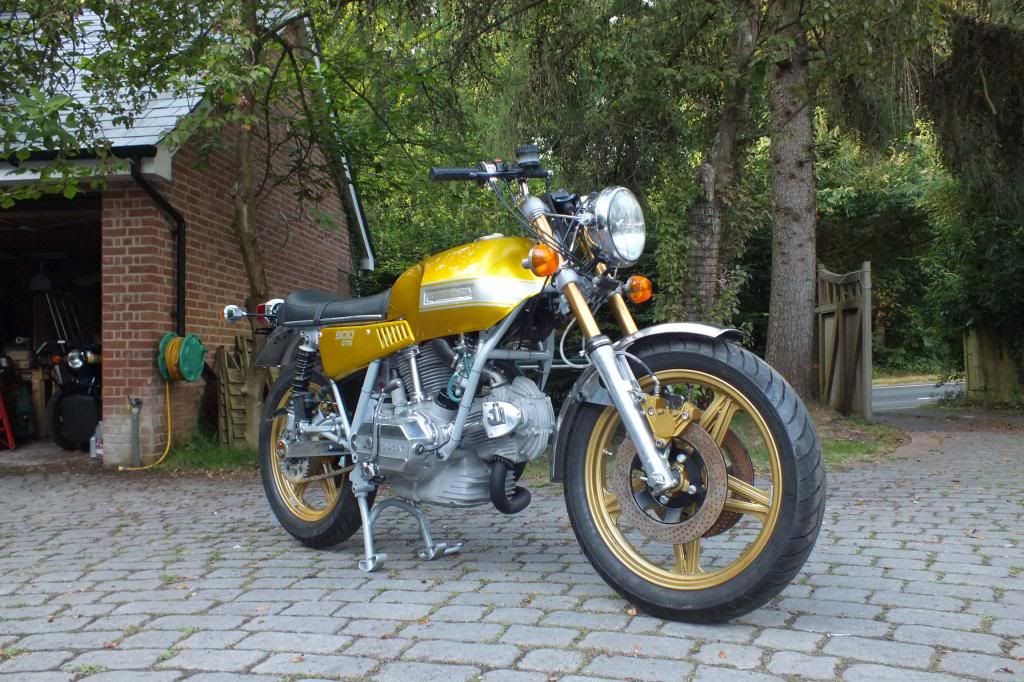

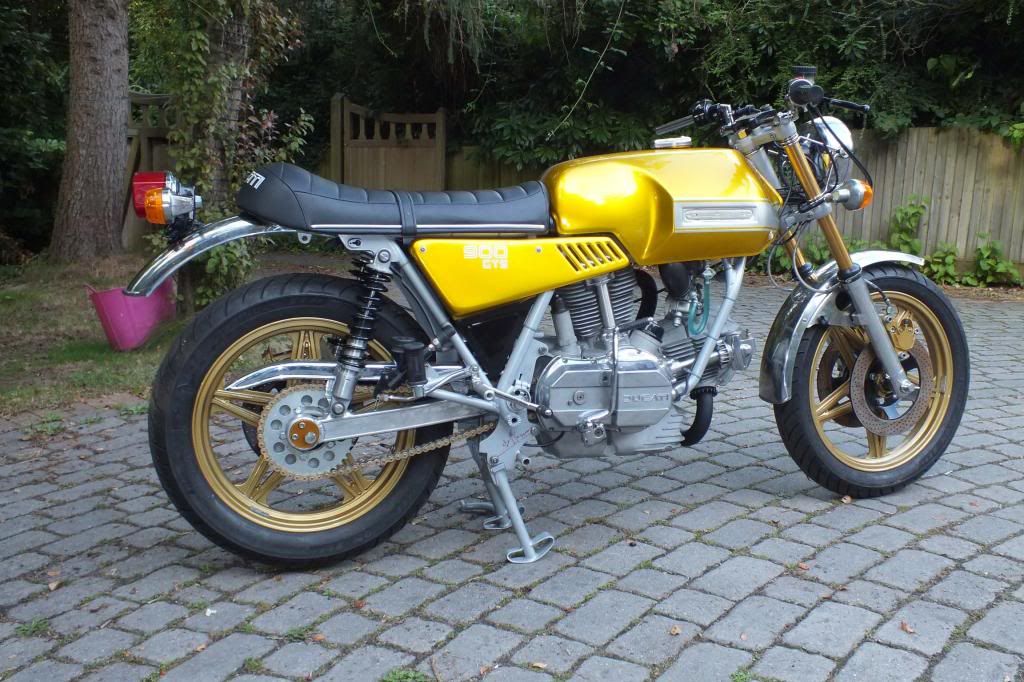

Conclusion? Absolutely fan-bloody-tastic. Sweet engine, sweet comfy handling and great noise. That straight cut primary drive makes it sound like you are sitting on a full race engine, it isn't just the exhaust that sounds great, the mechanical noises are epic; Nothing like the SS (and much better).
I think the rear mudguard treatment I have given the bike gives it a slightly scambler'ish feel, although I am definitely not looking for any off road excursions ;).
I don't show the RH side of the bike much - mainly because it is in the shade near the border with my neighbour, but here it is...
It wasn't a smart move starting this project, but I think even Tracy likes it. Like might be too strong a word, but it is a great bike and I am looking forward to taking her out for lunch on it, when I'll be on the Lime & fizzy water. All good.
P.S. I hope you notice the contemporary lawn mower in the background, I only wish the GTS was as reliable ;)
I think what's most important here is to remember what the starting point was. How many people would have had the bloody minded drive and determination to bring that sh*t heap back to life?
Paul - I take my hat off to you. You're a miracle worker. I remember bringing my GTS home and convincing my wife that I wasn't an idiot by showing her your Dark Side Of The Moon. Somebody far more ambitious (stupid) than me!
It's simply a masterpiece - and a unique tribute to your hard work. Well done and I look forward to seeing it in the flesh.
