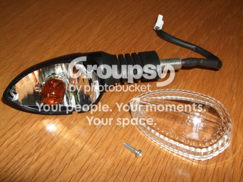

First remove screw at the rear of the indicator housing and take off the lens cover to expose the reflector and bulb assembly.

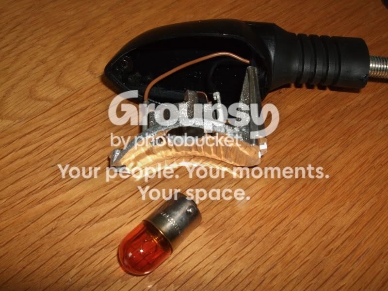

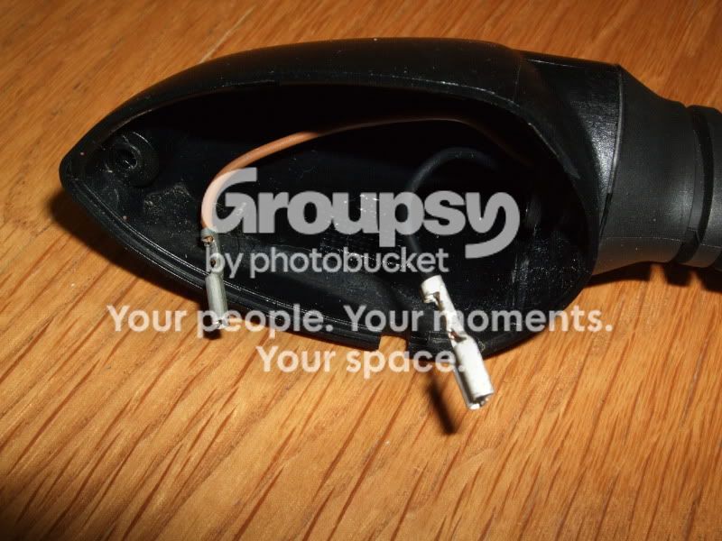

Next remove the reflector and bulb to expose the wiring behind. Note that the kits include reverse polarity protection and a load resistor but they do need to be connected correctly to work.

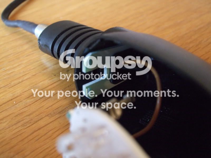

The black wire is the positive lead. This needs to be connected to LED board terminal that is located next to the onboard black diode. The brown wire connects the other terminal. Even if you connect them the wrong way round, just swap them over and hey presto.

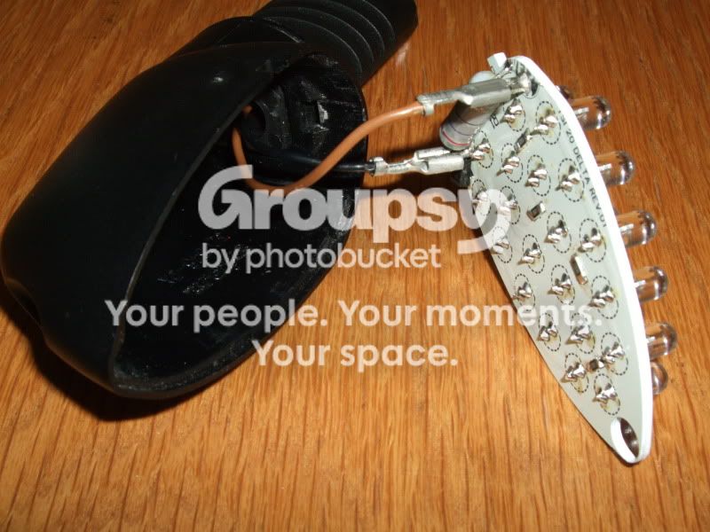

Now attach the wires to the board, ensuring the spade connectors are firmly attached. These are quite a tight fit and although the boards are very well made you still need to be careful not to force them on, so just use a little care when attaching them. At this stage it is a good idea to switch on your ignition and test they are all working correctly.

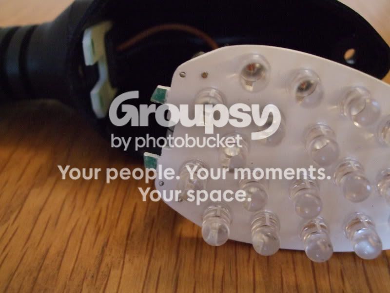

Now gently insert the board into locking key, ensuring the two tabs shown here on the board, fit into the two holes in the locking key, then press the board into the housing, making sure the lens cover hole in the board is aligned with the hole in the housing
Here is a picture of the board fitted into the housing and ready for the lens cover to go back on

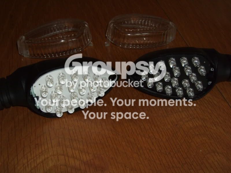

Both black and white versions fitted. Note black version was just placed in the housing for this photo so no locking key is fitted (for the eagle eyed amonst you!!)
Here the indicators are finished, with lens cover refitted, showing both black and white versions

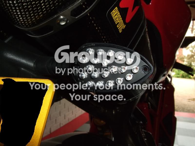

Here is the black version on my bike all wired up and ready for the lens cover to go back on, after testing.
Here it is all finished and unlit.
Here it is working. Not the best picture but it does not do it justice as they really are very very bright.
