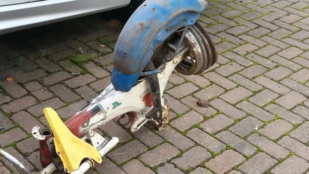

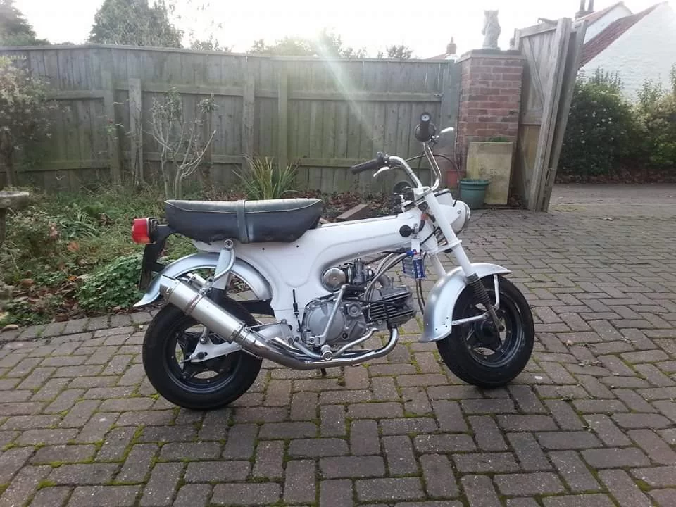

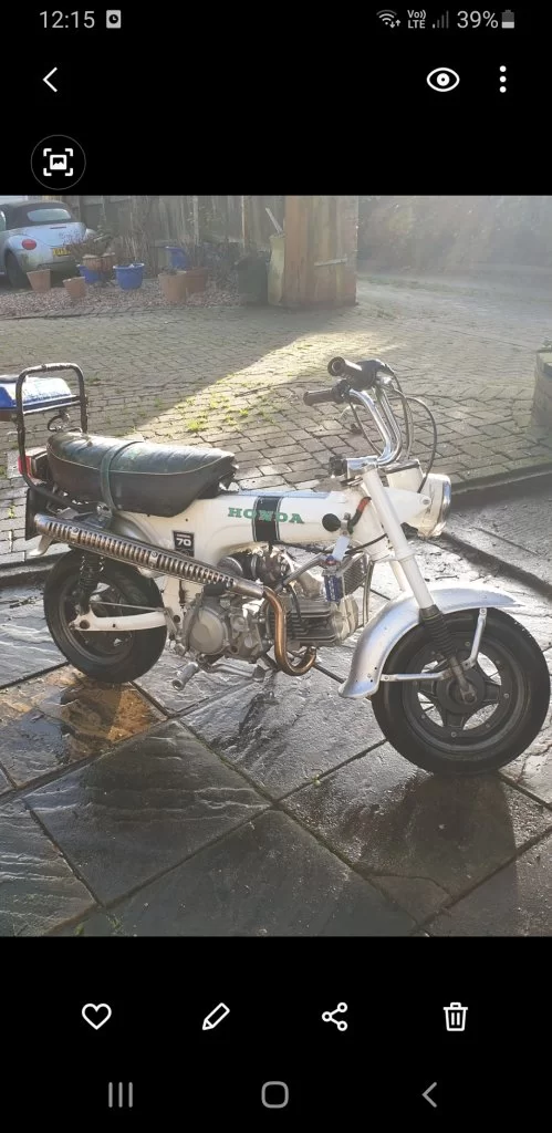

My aim was at first glance to make it look bog standard
Its got a 150 Daytona engine with much larger carb. Rather than stick it out the side like most i modified the standard air filter and got it inline. Then managed to get a large bore exhaust that takes the standard heat shield
Still to do is fit a neater auxiliary fuel tank. I can only get to the top of the village with a 2 litre standard tank
