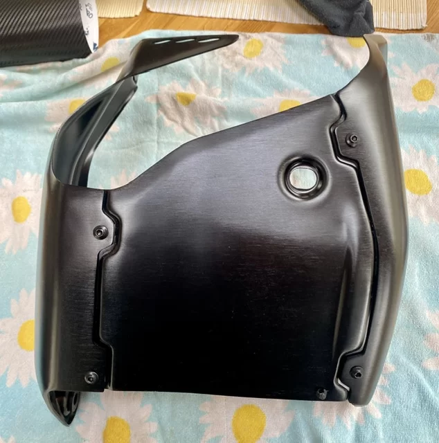

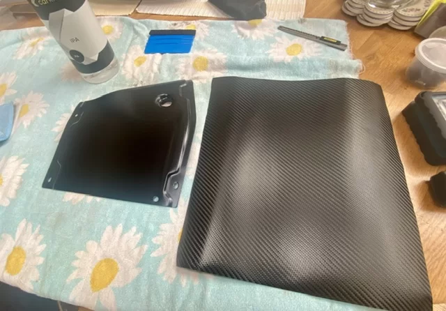

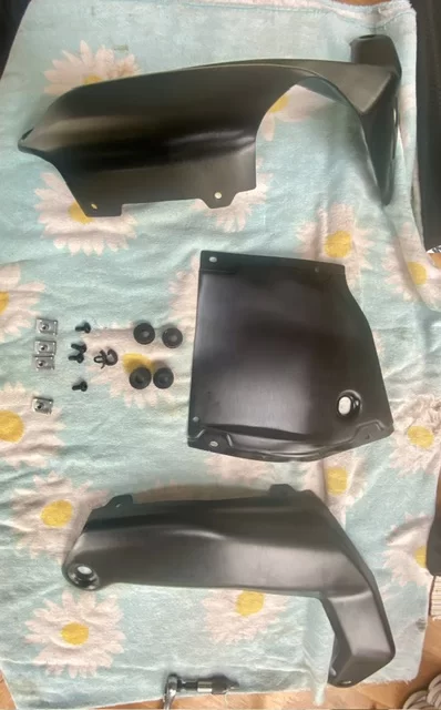

First things first, got to break the bash plate into its 3 constituent parts and then remove all the fittings off it.

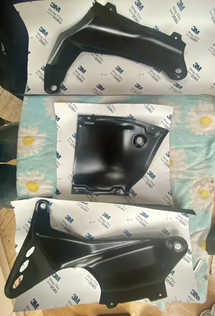

Next, cut some wrap that’s big enough to do each part.

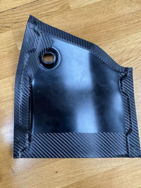

I started with the centre part as that’s got the easiest shape to it, bar the indentations and channels.

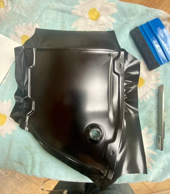

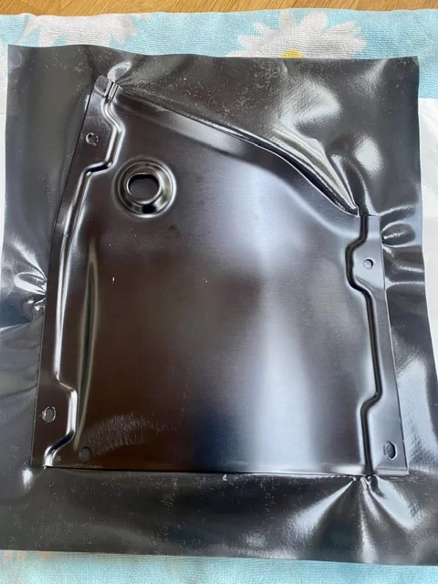

The part was decreased with isopropyl alcohol, dried with a clean microfibre cloth them the vinyl stripped of its backing and laid on the part.
Starting from the centre push outwards with the squeegee spreader thingy - the blue thing in the photos. This pushes any air bubbles to the edges.
The 3M film is very pliable and very easy to be work with. If you’re not happy simply peel it off and reapply it. Use the squeegee to push it into the indents. Apply a little heat with a heat gun if necessary to soften it further and it can then be stretched into the indents easily.

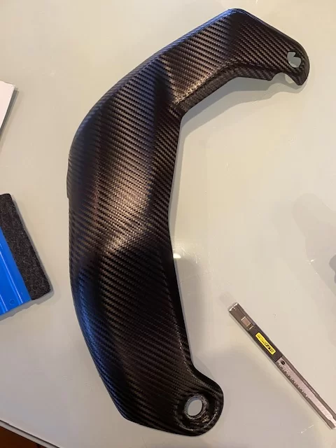

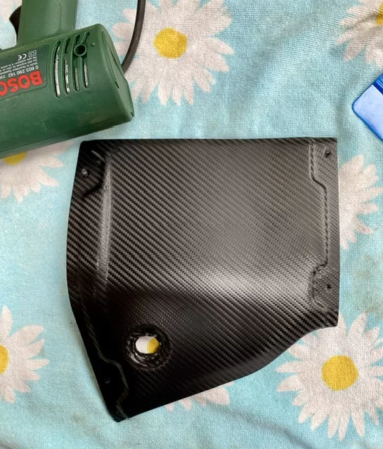

Once done, flip it over
Now trim it, especially the corners, as you don’t want the material to bunch, and start to stick it down on the inside.
I made a small X in the screw holes so the bolts can pass through when I reassemble it, and made 4 cuts in an asterisk * shape for the larger hole where the fuel tank drain passes through.
Finally, 45 mins later, my very first wrapped piece is completed 👍 and, whilst I don’t want to jinx it for the other pieces, I’m quite pleased with the end result.

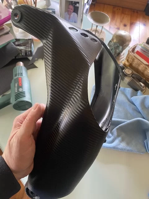

Now to do the 2 more awkward shaped bits.

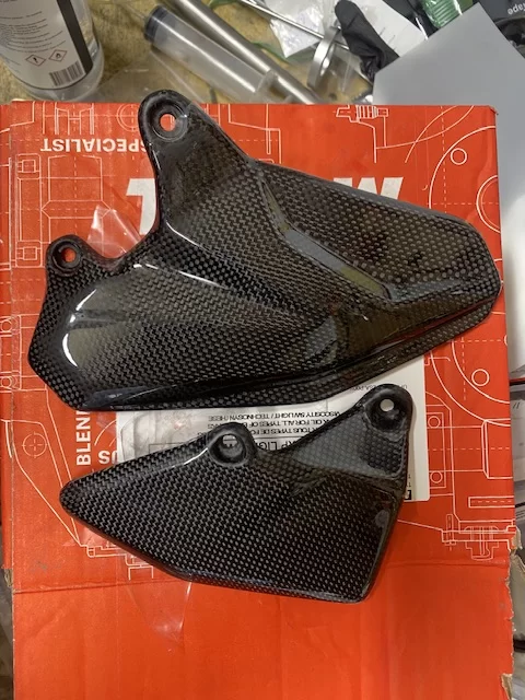

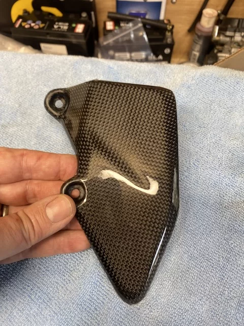

Been playing around with paint protection film too. Had to cover these two heel guards, they’re genuine CF and would only get scuffed to bits, hopefully the PPF will save them.
The PPF is not as conformable as the vinyl wrap, doesn’t really like heat and is a bugger to cut even with a new scalpel blade. Still it’s tough stuff so should hold up.

I admire your skills but doesn't wrapping carbon fibre in plastic just make the part look like pseudo CF?
Possibly, yes. The PPF comes in either a gloss or Matt finish. I happened to have bought gloss because it was a fall back if I couldn’t source a kit for this bike (MultiV4SPP) so I used what I had to hand hence the glossy finish. I will probably get some matt finish PPF and when the bike comes back for its first service in 1000km time I’ll swap the PPF. However, it was applied as a necessity to prevent the carbon fibre heel guards getting scuffed which they otherwise would.

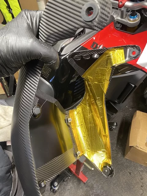

As for the bash plate - well, there’s no point having a genuine CF bash plate as it would just fracture upon impact with anything (not that he’ll be going off road) but to match the rest of the bike (it’s now dripping in CF) he asked for me to find someone to wrap it so I thought ‘here’s an opportunity to learn’👍.
Mind you, due to its proximity to the exhaust I took the precaution of applying heat reflective tape on the inside to prevent or minimise the vinyl wrap from yellowing with heat.

I wish 🤣. Each heel guard took about 20-30 mins to get it just right. The bash plate took about 45 mins for the first piece, the base plate which is a relatively straightforward shape; 20 mins for the second (the LHS piece) as I was more used to it but then 45 again for the RHS piece as it was a much more awkward shape with bends that go in 2 different directions.
