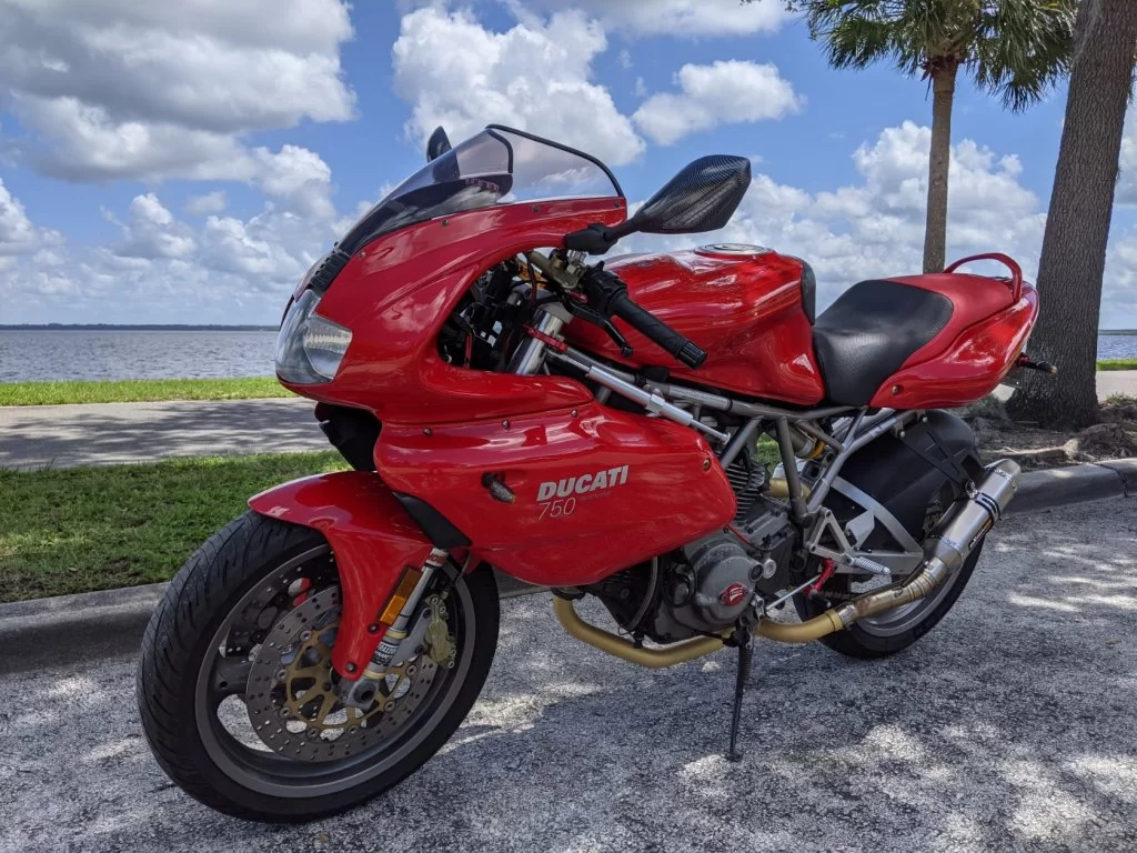

I recently replaced the fuel injectors in my seven fiddy. After looking up the OEM parts on Ducati Omaha parts list I suffered immediate sticker shock as the price listed was $482.... each! After some research into the part number and specs of the injectors, I was able to source these as replacements. They were substantially cheaper and work just fine. The price was lower than cleaning the original ones not even considering the 32K miles on them!
I also added a Power Commander III USB to the bike.. According to Dynojet there was never one made for the '01 750. I used one from the M800 I found used and the wiring plugs worked fine. I got a "donated customer map" from the Dynojet archives and zeroed out all the cells to test the function. Test road it yesterday and it worked as advertised with the throttle TPS indicator tracking the throttle movement as required. I turned on the "accelerator pump" function to test in the coming days. If it works,, I'll get to the dyno for a specific tune for it in the future. Right now, it's running better than it has since I've own it!
I'll update this as it progresses.

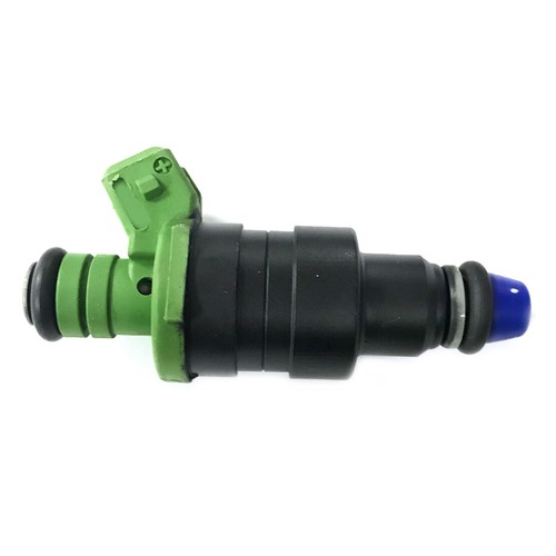

I also found this info on the injectors...
PART NUMBER: IW-031 GREEN TOP.
Replaces OE equipment on some Ducati bikes
851
888
ST2 - 2000>2004
Supersport 750 - 2000 > 2002
Supersport 900 - 2000 > 2002
Ducati part No. No. 280.4.002.1A
Replacement also on Moto Guzzi.
California – EV 1998
Norge 850
Griso 850
I stock the California Cycleworks Matched Injectors (see link for fitments) IWP-043

Stuart - this is an old thread but it touches on a topic I'm interested in. The conversation started with IW031, then moved on to the later Pico injectors. Are the older IW031 injectors and the IWP-043 dimensionally identical? (O-Ring size and height I'm mainly interested in..)
Regards,
Mike
Regards,
Mike
@Exige ?
Regards,
Mike
Hi Mike,
Not sure tbh - ours are 14,7mm OD on the o-ring (fitted) and an overall length of 47.3mm
Hi Mike,
Thanks.. I *think* I'm running out of injector time on the bimota (which uses IW031) at the very top end of WOT, hence the question. Since asking that question last night though, I've realised that I have a 696 throttle body (and injectors) on the shelf, and an old set of red IW031 injectors somewhere, so should be able to compare directly, without having to tear any bikes apart (y)
Well, that answers the question. As soon as I had a close look at the 696 throttle body, it is clearly much smaller.. :)
*edit* - just realised that these are siemens injectors, so slightly different, but the proportions look similar to the IWP-043
