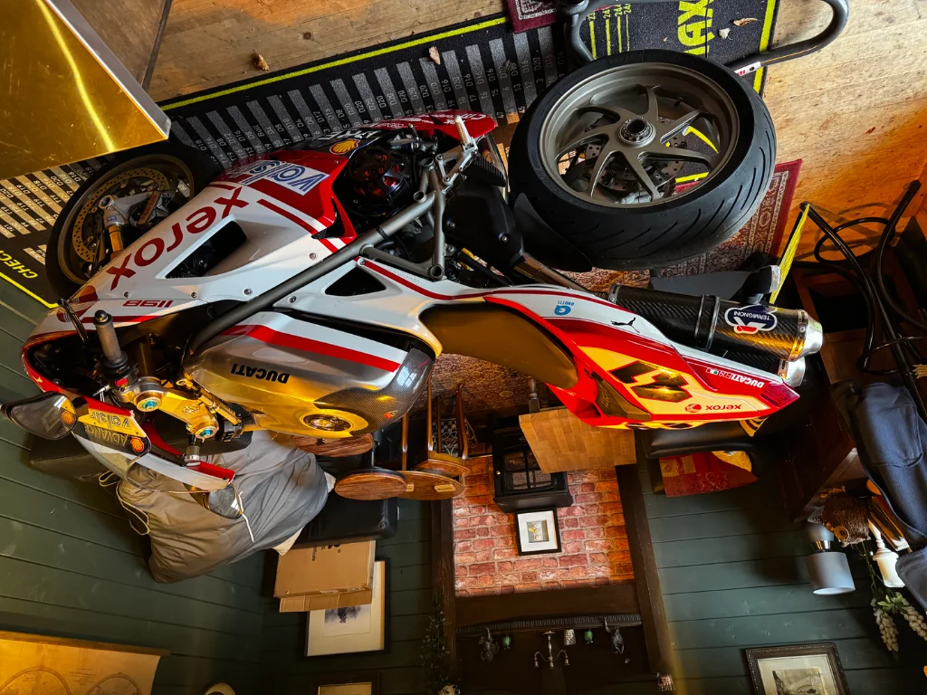

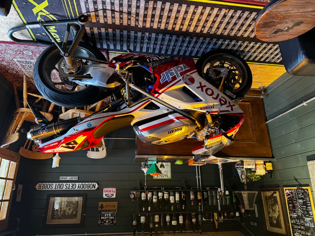

Put the beastie in the cabin to free up some space in the crowded garage.
Anyone want it for cheap 💵
Pics upside down for your viewing pleasure 🤷‍♂️
