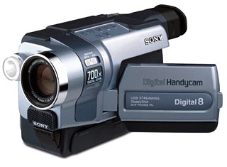

Filmed the whole lot on my Sony Handycam DCR TRV245e 8mm DV and planning on doing the usual producing a dvd for the kids (and parents) for them to remember this moving experience.
Only problem is it has developed a fault and I cant transfer the footage to my computer to edit. :mad::mad::mad::mad::mad:
I plan to get the camera into Sony to see if the fault can be fixed, but in the meantime still need to get the tape footage transferred onto my computer as the turnaround for producing the dvd is usually less than 2 weeks.
Does anyone in the central belt have a digital (preferably sony) video camera for 8mm/Hi8 (not mini 8) with DV out socket I could perhaps borrow?

It's the Hi8 with DV output that is the problem.
The tapes playback but with Grey bands across them both on the camera screen and the computer just says "no".
Camera is away to Sony to get fixed (could take 2-3 weeks).
As mentioned the problem is that I need a camera now to get the footage edited.
It's got a head clog and just needs a head cleaner tape ran through it for 10-15 seconds. I hope Sony don't charge you much for that.
