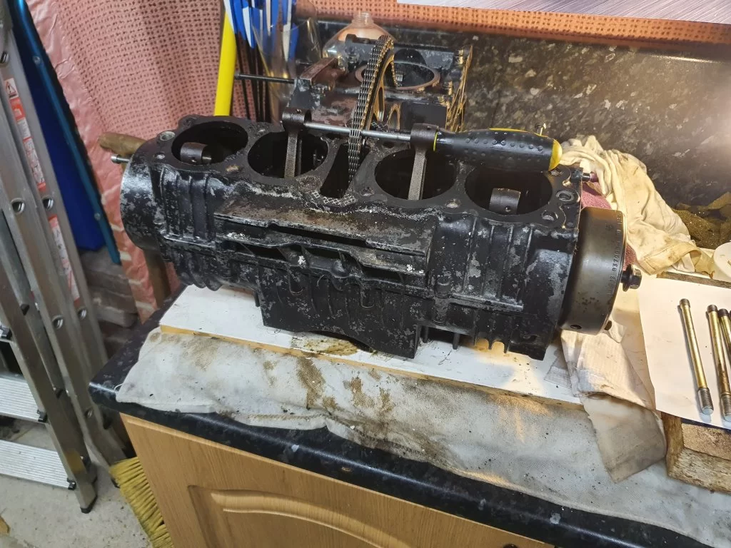

Had a bit of free time, the gaffer was watching her soaps on the telly!

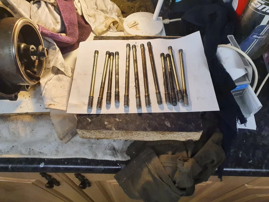

Decided it was time to remove the studs, I had soaked them yesterday with GT85, they were very tight and I was worried about damage either snapping or bending!
Getting there, taking me time, passed half way so went for a brew
Done, really pleased no damage, the studs will be off in the dishwasher tonight with a few other parts when her majesty goes to bed (y) 😊

My studs were APE ones with no shoulders, some were wound in too far (found the height specs in my workshop manual to reset them), they came out easy with a couple of nuts on the threads.

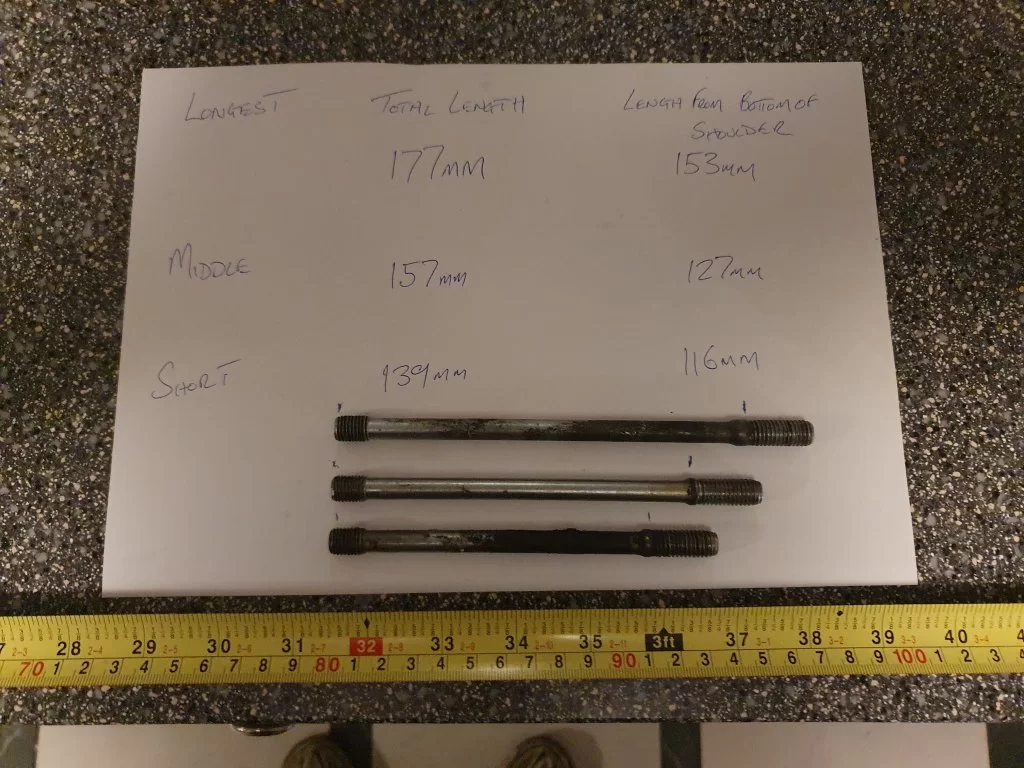

Can you measure the total lengths of the 3 different ones so I can double check mine 👍
course I can cocker, just remember my engine is 738cc with a stroke of 54mm
Thanks for that - I am presuming the barrels and head would be the same casting / stack height (y)
Hope so mate, just checked, the stroke for the 1062cc motor is 62.6mm, not sure if that will make a difference, let me know if'n you need the stud diameter?

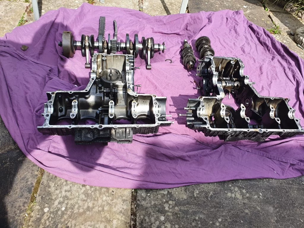

I've split the cases, surprising easily! Two taps at the fore and two aft with my favourite mallet 'Angela' (named after my ex wife)
Bobs yer dads brother and his wife Frances.
All in all I'm pleased with the condition, nothing ceased to be or broken.
A few little odds and sods to remove then I have to ply my mate with alcohol to spend half a day with his fairly large parts washer! Ooerr matron!
