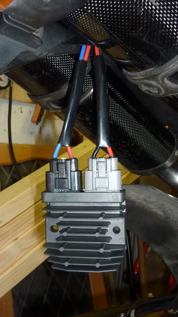

I used this on my early 748, ( https://www.ebay.co.uk/itm/264413021057?hash=item3d903e8381:g:HfIAAOSw9jpklDB3&amdata=enc:AQAIAAAA4HLNYGfuRO1NTzt76IeuwhgBKRCz4HAocuJ/jD0ril78urY/FiJDtJRhkcUikLFtcCufYSgKIeqSlveP+e4pZYyQgv5m7H1efaAY9uEsOUj5umOE9UzIV6wpsdXURytQ/6n1+XqPZsfLOLbFPr7PP4xM/IO7CHWlcCDsPSTWr4Je5hax0ECN5O3s/YPufLyieRnE7Lf0B81r8nd7FF9MvtuWDNVcg69VtpZtLmELOz0TihPDscNK7vtB8M4dxTRSQijOx9FoMgYy0ITyqHRmhz0Tvl3IEe2KnXPj+jtP/soF|tkp:BFBMpLbtpcBi )
Search Ebay or go to a model shop there's plenty available. I used 12 AWG.

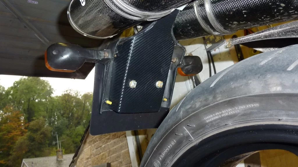

It is used by RC modelers for Lipo Batteries, very flexible and heat resistant, while I was at it I moved the reg/rec to the back of the number plate to keep it cooler.
It's been trouble free for around 10 years now.

This is excellent advice from @Birdie and the correct grade of wire (better than the OEM), if you intend lengthening the wire consider going to 10AWG then solder the wires directly to the coil and shellac / heat shrink the sleeve.
